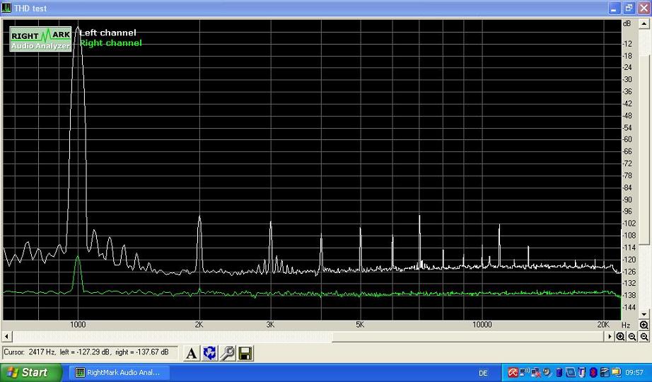

Back to the impact of the comparator to the noise figures...:
Attached some comparative measurements with LM360 and SystemD_MD.
In classD it is important to watch idle noise and operational noise, because with increasing load currents the HF disturbances increase and will also affect the NF noise.
First picture is the operation of the original SystemD_MD with discrete comparator, running 60W into 2 Ohms.

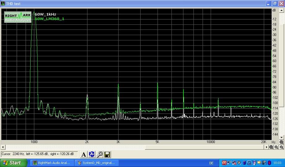

Second picture is the comparative operation of original version and implanted LM360 both running 60W into 2 Ohms. Don't panic about increased distortion, I think this could be readjusted by the shaping network. Also noise can be inproved by approx 5db with a 47pF cap directly across the comparator input.

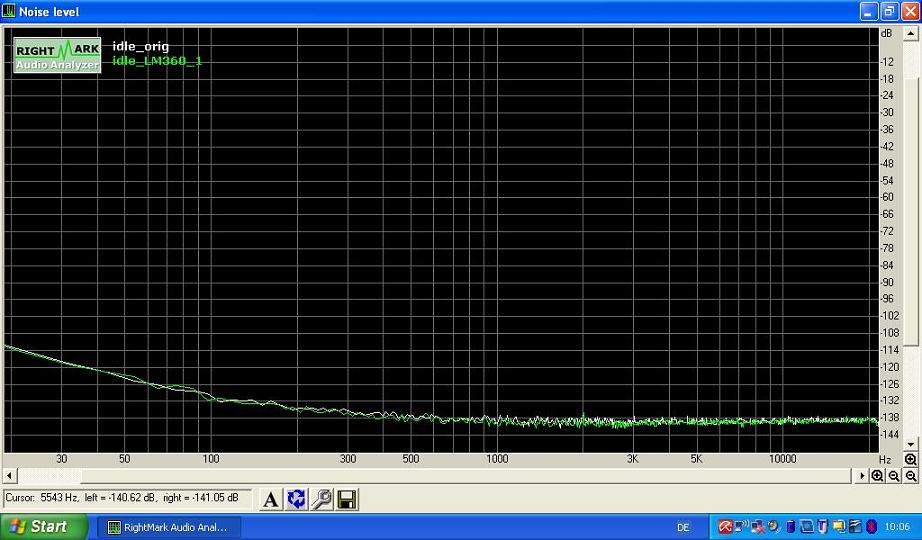

Third picture is the idle noise of both versions. Shown decibel relate to 60W again. This is fitting to the findings with the headphone that both versions are pretty silent.
