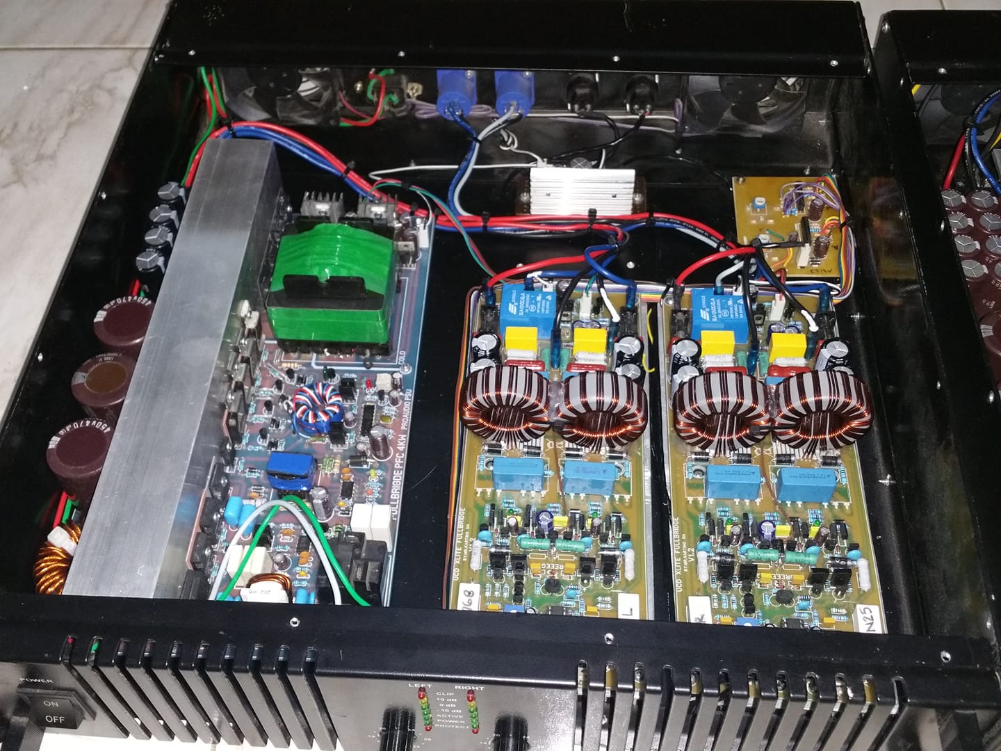

...finally... Fully assembled.
TO220 diodes for freewheeling on the backside. Required cooling depends on application.
hi chocoholic how are you, long time bro. just wanted to know how your amp
is fairing on and do you use it on a daily basis?
I really hate people who think so scary when talking big amps, 2000W-3000W per channel. No man... don't afraid. A 90V supply in bridge class D is very easy to build. And very easy to drive 1500W 8 ohm speaker, or 3000W 4 ohm (2x speaker parallel).
Mine, it has been in service for 2 years without any single mosfet blown. UcD discrete class D.
Just try it, no fear.

My schematic is very simple. Only single level shifter 2SC3503, I have been tried to drive high side floating gate driver discrete at 125Vdc supply easily. At 90Vdc supply it is so safe. It makes schematic so simple.

two years and the four channel d amp in one casing is still working 😱 very impressive , how about the hissing hf noise ? is it present?I really hate people who think so scary when talking big amps, 2000W-3000W per channel. No man... don't afraid. A 90V supply in bridge class D is very easy to build. And very easy to drive 1500W 8 ohm speaker, or 3000W 4 ohm (2x speaker parallel).
Hishing sometimes yes, not luckily not this amp for some halfbridge model. I am trying reseach to solve. I found some clue that the hissing is leakage frequency from comparator/output back to op amp balanced input. One solution found, by put 100pf bypass cap to R gain of Op amp for balanced input stage.
