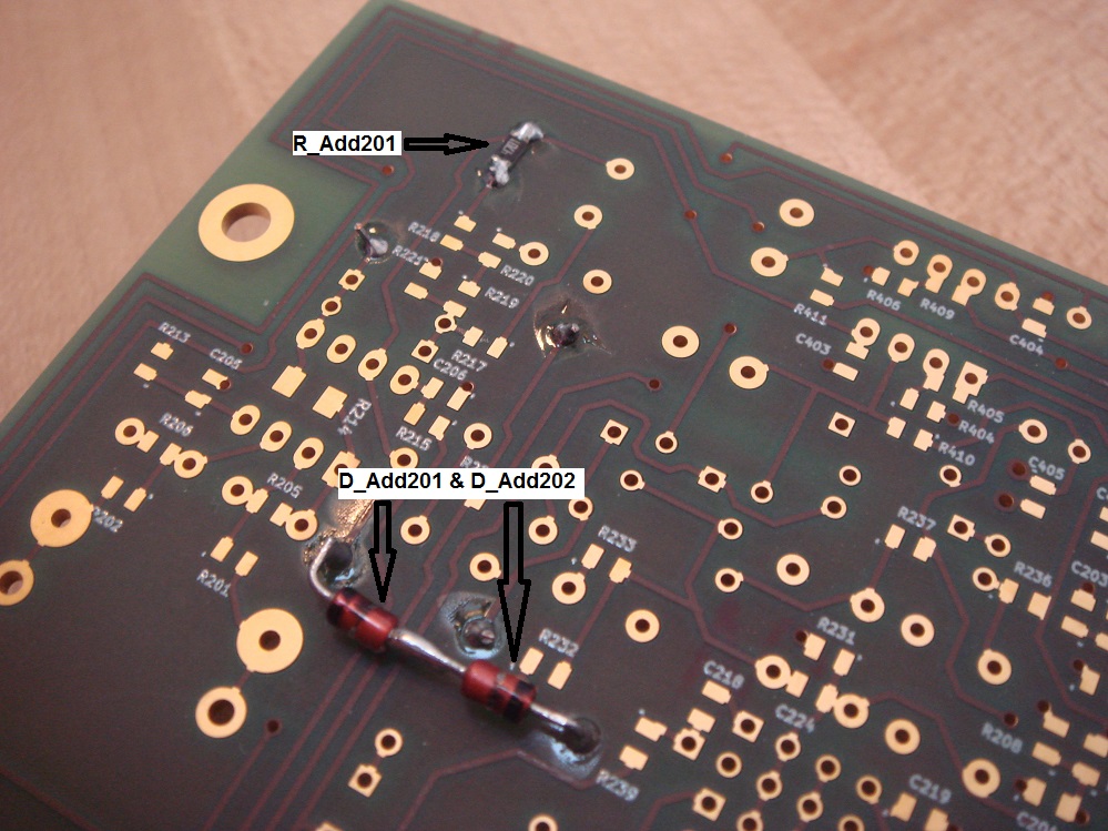

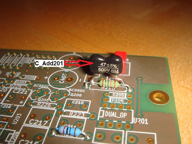

Both versions use the same PCB, however V1.5 needs additional
components on the board which have to be placed in "free style".
Please refer to the attached pictures and also to the BOMs in the builder packs.
Note: The pictures do not show the series connection of C_Add301 and R_Add301. You can place them aside the board from output to GND.
50W+ heat sink only needed for large 10kHz rectangle.
For music program 5W is sufficient. Wiring between this RC and the board shall be done with a twisted pair of wires, recommended length less than 15cm.
