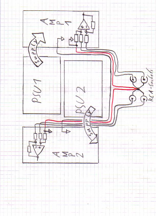

..Dimitri's comments pushed my brain to the right direction.
I am sticking to my I-want-it-all requirements and consequently will get an undesired GND loop somewhere.
But when you wire both signal grounds to a star right at the RCA sockets, then the input amp will always automatically compensate the undesired voltage drops on the GND, no matter if used asymmetric (one RCA of each channel shorted) or symmetric.
The attached schematic shows the simplified principle without EMI filtering.

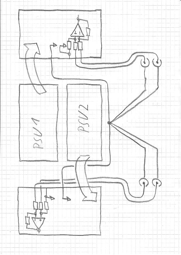

...did I say unavoidable loop?
Nobody heavily complaining?
My brain blanked out the option as attached here, because I generally dislike a large geometric separation of signal wires and signal GND.
...and it messes my geometric separation of power GND and signal GND.
Fortunately my signal GND is close to the speaker power GND on the PCB and the PSU GND is not inbetween.
It will also suffer from adding to the signal the voltage drop of the GND connection between both amps, but will also benefit from the compensating effect of the input stage.
Nevertheless I am starting to think of this as a viable option, when routing the signal wires geometrically close to the GND connection.

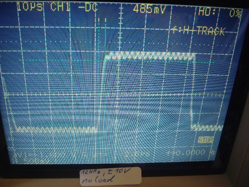

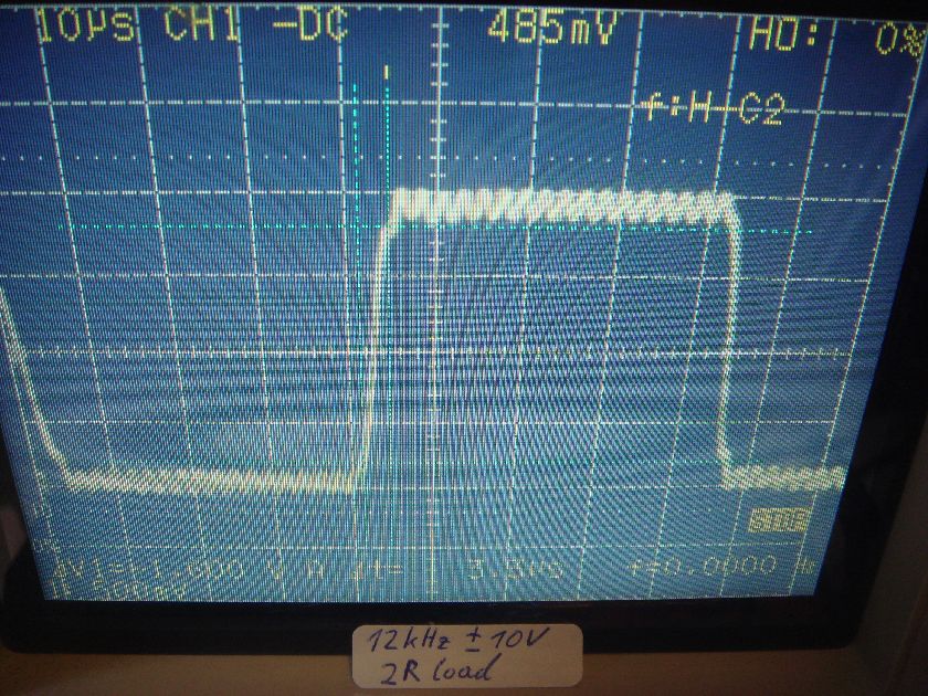

Here an update on V1dot5, which is going to be the version for my living room.
- Speed:
In the first two pictures you can see the amp reproducing a 12kHz rectangle with +/-10V. First without load, then with 2R load.
==> No overshoot. Sloping times of approx. 3us
Voltage scale: 5V/div
Time scale: 10us/div

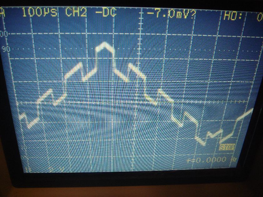

- Ability to reproduce complex signals with high fidelity:
AP2 often is pointing to complex music signals. Even when I doubt that you need unaffordable measurement equipment to analyse the amp with real music program - I am convinced that optimizing an amp for more complex signals pays back during listening.
A simple combination of a large triangular signal (1kHz) with superimposed rectangular signal (10kHz) can open your eyes on short comings in your design. V1dot5 showed good fidelity already from the beginning. After another analysis of the loop gain including all options to control dv/dt - the behavior of the amp brought a smile on my face.
Voltage scale: 20V/div
Time scale: 100us/div
- Speed:

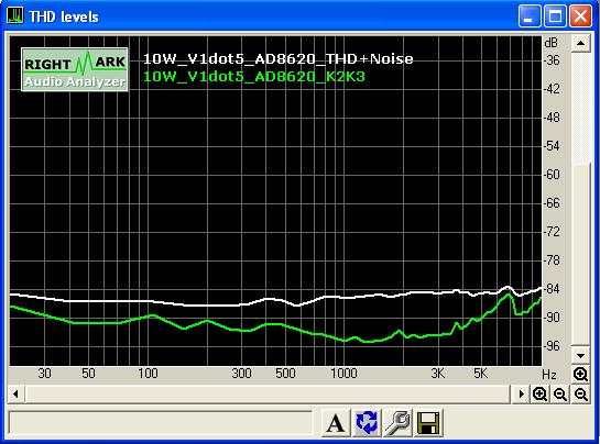

Attached a screen shot which displays K2+K3 in comparison to THD+noise. Power was 10W into 2R.

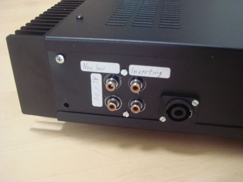

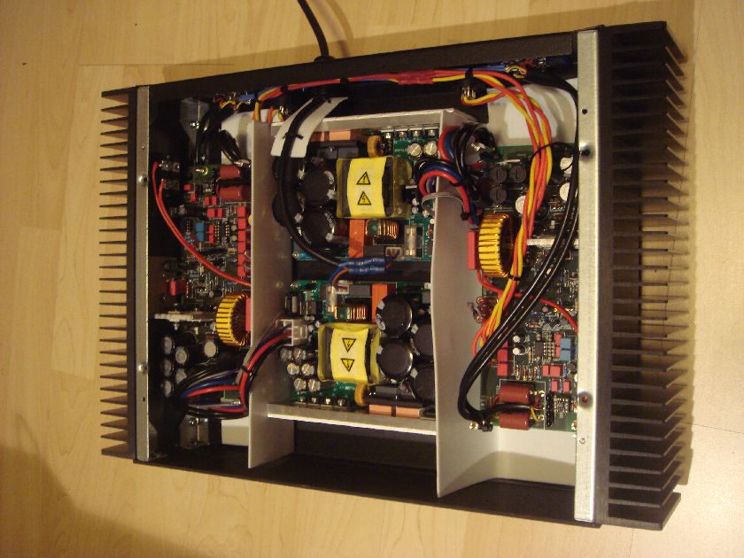

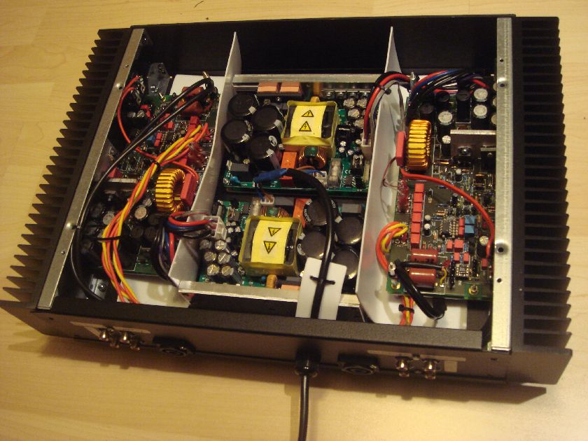

Dual mono in experimental enclosure
Why experimental?
-Heat sinks are larger than necessary.
-It is 2 units high, but 1.5 units would be sufficient.
-Wiring suffered from experimenting.
-A friend is considering to build the amp as well and go for a special enclosure, I kept the supply wiring longer than necessary in order to stay flexible for a potential transfer in a different enclosure.
Nevertheless, the set up is performing very well.
I tested both wirings (posting #422 & posting #423).
Both showed no issues with HF interactions between both channels.
The first wiring showed a slightly superior behavior in case of strong external magnetic fields. This can become relevant, when stacked directly on top of an ancient amp with monster transformers. So the wiring like in posting #422 is my final choice.
Even without top cover you can run the amp at full power without interfering a FM reciever close by.
Distortions and complex signal handling remained unchanged after implanting the amps into the housing.
You will notice four RCAs for each chanel, two for AC coupling and two for DC coupling.
For AC coupling I am using the Panasonic ECW series. Definitely one of the better choices, when staying with non audisoteric types. The Mundorfs which I used earlier where fine as well, but with 4u7 they would simply be to large for the PCB - while the Panasonics easily compete in sound and come at attractive size.
This allows all considerable input choices:
-DC coupled symmetric inverting, DC coupled symmetric non inverting DC coupled inverting, DC coupled non inverting, DC coupled bridged.
-AC coupled symmetric inverting, AC coupled symmetric inverting, AC coupled inverting, AC coupled non inverting, AC coupled bridged.
The sound? Detailed and decent at the same time. Unmatched bass control. ...and sound stage!! 😀
Sound stage always is a hard to meet design goal. The design variations with this amp gave me some more insights - still no bullet proof recipe.
My friend must hurry up, the more I am listening to this amp the less I want to disassemble it...
Attached some photos of the nice guy.

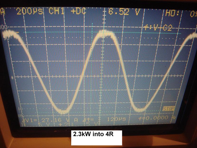

Bridged operation
No surprises.
The first screen shot shows approx. 2kW into 4R.
The output voltage of 256Vpp translates to 91Vrms, which results in more than 2kW power.
Scale: 50V/grid (1:10 probe)
The second screen shot shows 2.3kW into 4R, close to clipping.
The output voltage of 272Vpp translates to 96Vrms, which results in 2.3kW power.
Drop of fs becomes visible.

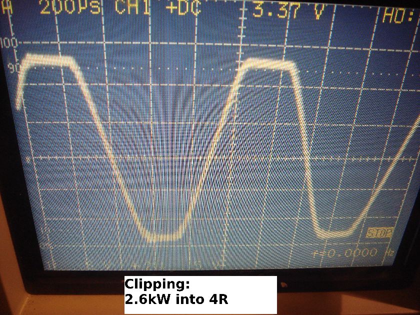

The third screen shows 2.6kW into 4R, with massive clipping.
Due to rail sagging the peak voltage is even slightly less than at 2.3kW.
Increase of power is related to trapezoidal wave shape instead of a undistorted sinusodial shape, which lifts the RMS voltage without high peak values.
The measurements have been done manually with a sinusodial input signal.
The popular burst measurements with 300ms/700ms power/break would slightly lift the limits, but not much.

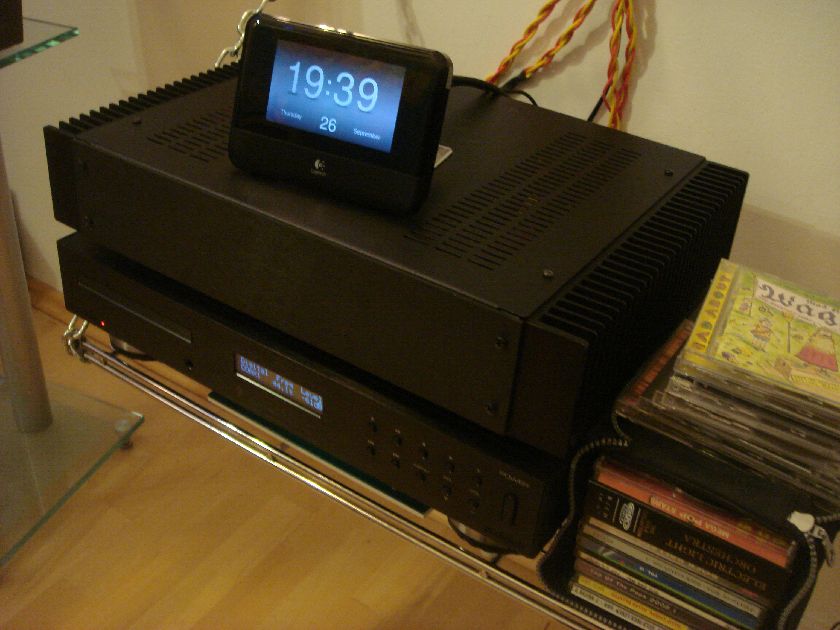

Hi guys,
as a kind of noob in electronics I thought for a while... at the end I'm happy to have made this decision and I'm proud to have built these wonderful amps.
I was looking for a while for some potential amps to power my woofers at 2Ohm. A clean sound and lowest distortion were absolutely essential.
After several nights of soldering and some support from Chocoholic (thanks a lot!!!) we could power the amps, which had a phantastic amplified output until almost 1,3kW @2Ohm.
Although the effort is high and the amp complex, I wonder why not more people have built this wonderful amp.
I hope, Chocoholic won't loose his pleasure and will design another fine amps in the future, which he hopefully will also share with us 🙂
