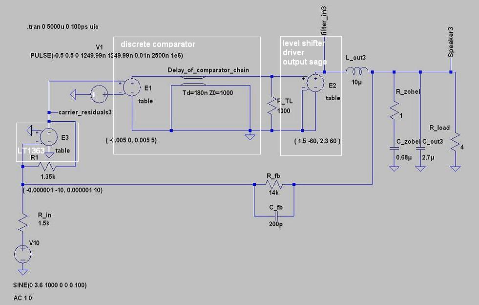

The caps at the drivers were planned like this.
The LED stacking was a correction, because my original clamping at the intput of the IR20957 was slowing down the comparator in a catastrophic way.
I intended to clamp with zener 4V7, but the diode capacities slowed down the comp to bad. The comp out can deliver 15mA and it still took 200ns to charge the diode. So I build the same clamping I used on my earlier breadboard trial, a 5V with 3 LEDs and clamp now with an ordinary 1N4148 against the 5V and a BAS85 against GND. Sloping of the comparator is now around 50ns. Propagation delay also around 50ns. Of course that's not fast, but fast enough and fits to my earlier comparator breadboard. The focus on the comp design is on the jitter noise.
...triangle generator and PWM-comparator running.

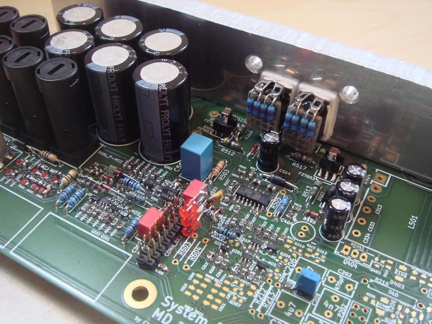

Rail E-caps, fuses, snubbers....
The way of placing the snubbers is not suited for mass production,
but in DIY, this direct connection is easy to implement and easy to adjust to the optimal resonance frequency for optimized snubbering that also covers the headaches of hard switching.

Now, shows us your bunrt hands 🙂
Have you checked electrolutics' max. ripple current? You'll have a lot of it with ~400kHz, +-60V and 10uH.

@Adam:
Current ripple in the filter chokes runs -/+ 3.75A peak.
This translates to an e-cap ripple current of 1.53Arms.
The Frolyt ERY 470uF/100V is specified for 1A at 100kHz.
With three of them in parallel we are far inside the SOA, even when we consider an imbalance in the current sharing.

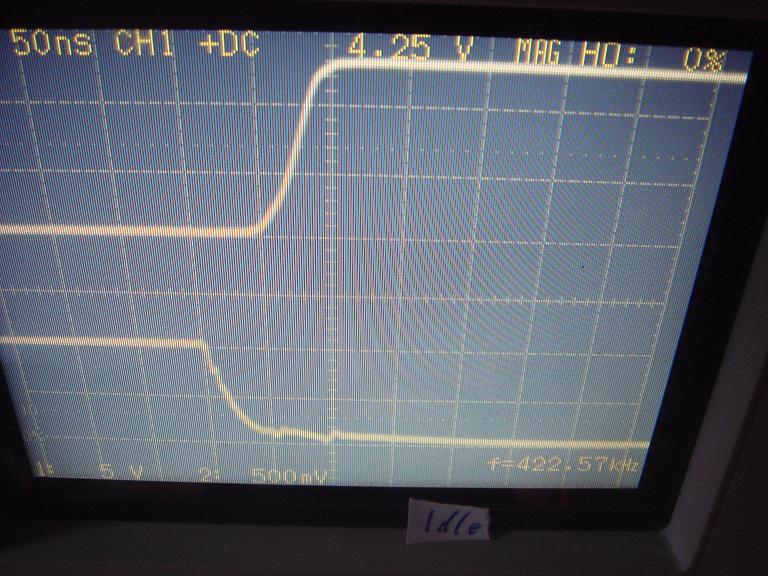

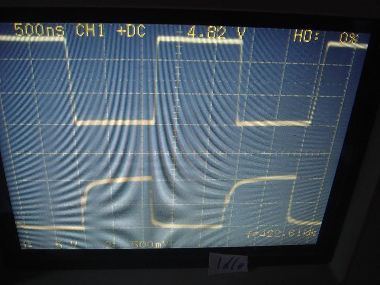

Adjustment of gate drive, dead time and snubbers is always an ongoing process.
Here some screen shots of a preliminary, but typical adjustment with a small overlap. All screen shots of this posting are showing the situation in idling situation. Screen shots during hard switching coming soon.
Picture 1: Uce and Ugs of lower MosFet, time base 500ns/Grid
Picture 2: Zoom during turning ON the lower MosFet, time base 50ns/Grid
Picture 3: Zoom during turning OFF the lower MosFet, time base 50ns/Grid
Upper trace: Uce, 50V/Grid (10:1 probe)
Lower trace: Ugs, 5V/Grid (10:1 probe)

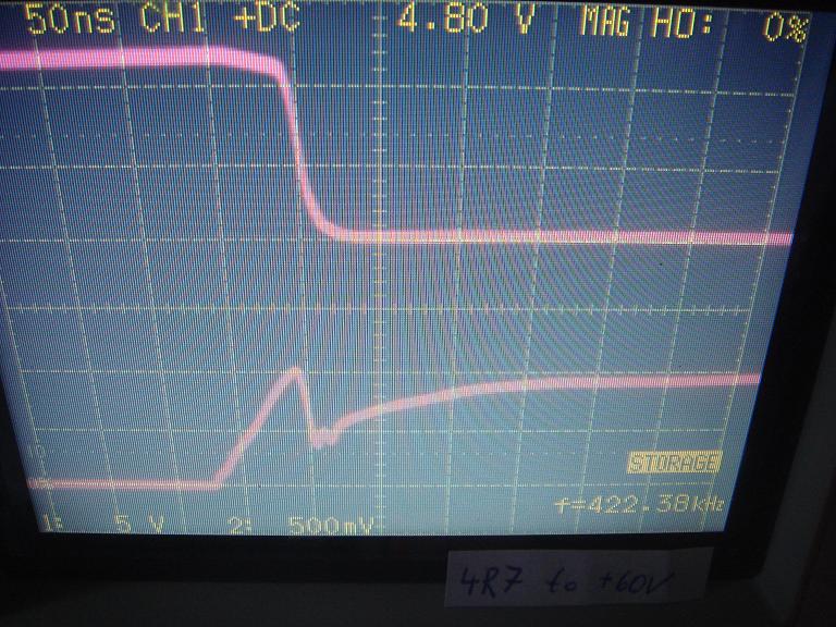

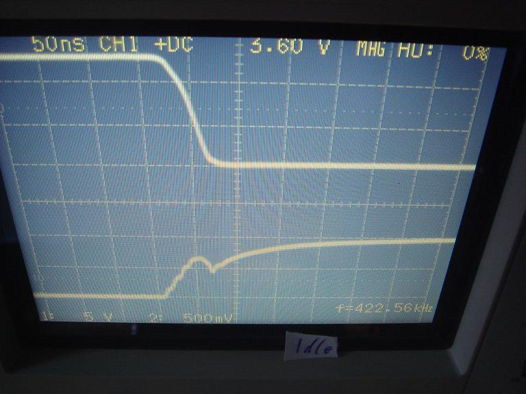

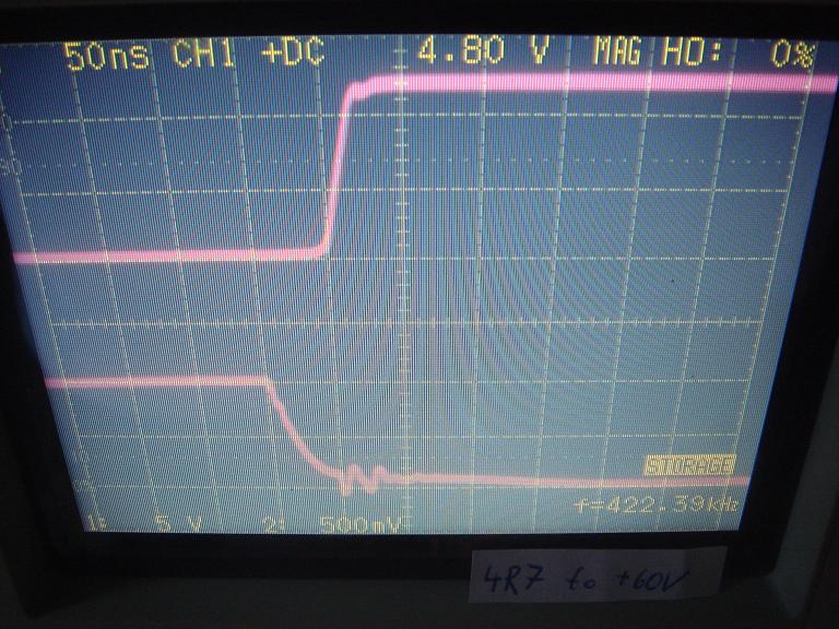

A very simple method to examine the details of hard switching is to give zero input signal and connect a load from the amp output to the positive rail and measure on the lower MosFet.
The shown screen shots of the hard switching situation are with 4R7 between amp output and +60V rail.
The load resistor must be a high power device because during the test it will dissipate Vrail^2/R.
Also during hard switching, there should not happen much uncontrolled ringing. This is mostly a question of layout and snubbering.
Picture 1: Zoom during turning ON the lower MosFet, time base 50ns/Grid
Picture 2: Zoom during turning OFF the lower MosFet, time base 50ns/Grid

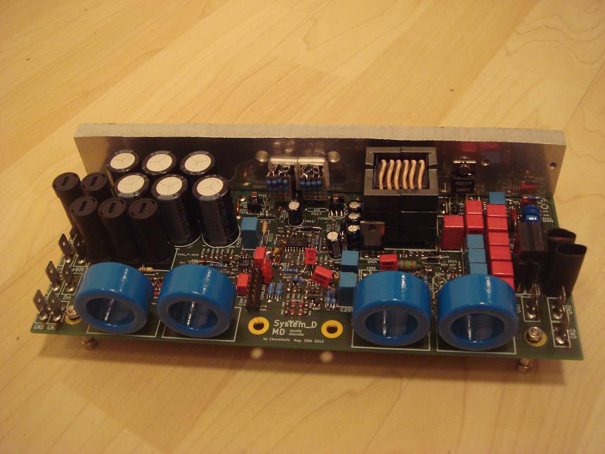

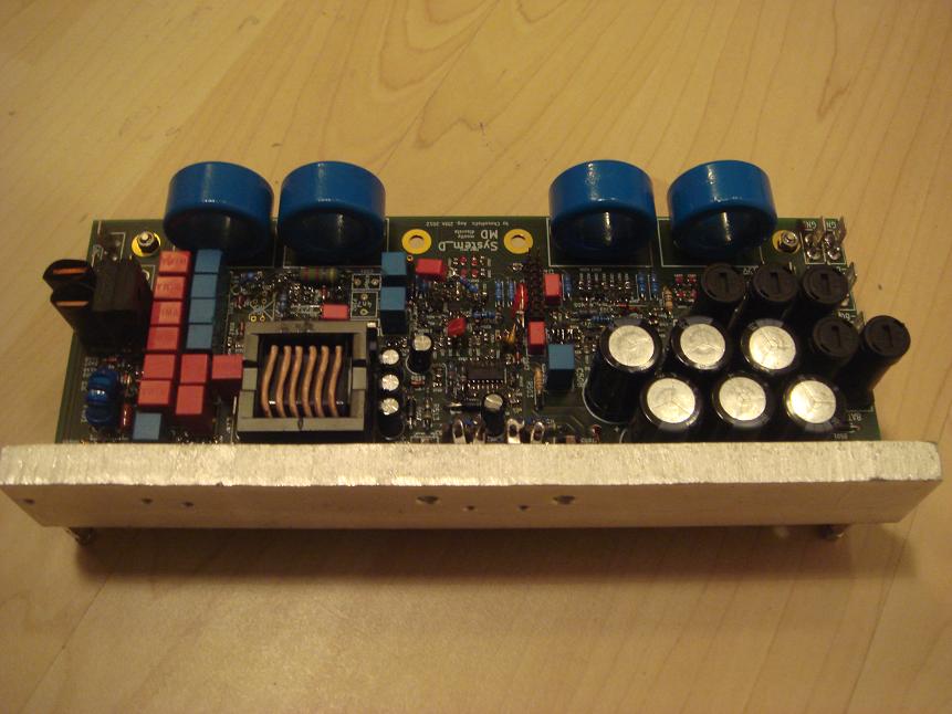

So Choco did it again....!!!
BTW: I can see the separate inductor with ferrite core, but what are those blue toroids for?
The four large blue torroids are optional common mode EMI filters.
Chosen Material: Ferrite, Epcos T38
Number of turns to be chosen identical on all torroids. Typically in the range between 1 to 3.
First torroid: All supply wires including power GND
Second torroid: Synchronizing signal for multi chanel operation and/or sync with PSU, including sync GND
Third torroid: Audio signal input including signal GND
Fourth torroid: Speaker output including speaker GND
...all these surroundings like the EMI torroids, fuses and protections add complexity and size, but I wanted to have this build not just as a prove of concept. It is intended to become part of my home listening system.
Well, in bridged configuration with 1400W/4R it is sort of overkill, most likely I will use it unbridged.

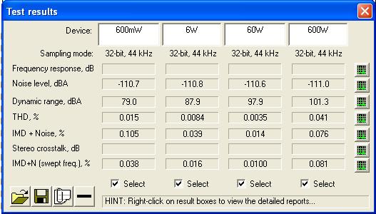

It took me some time to adjust all parameters in a harmonic balanced way.
...the next few postings shall give a brief overview of the status of today. I feel that this close to the best achievable optimization according my personal taste, but of course further small improvements may evolve with time.
Noise:
My measurement of the idling noise shows 78uVrms wide band noise.
Means with my speakers there is no noise audible at at all.
When I plugged my headphones directly to the amp output, I had to go into a silent room until my ears were able to take notice.

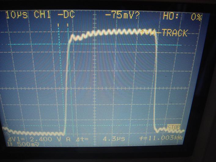

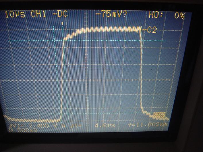

Reproduction of rectangles and driving different impedances:
The first screen shot is showing a +/-15V (10:1 probe) rectangle with 2R load. Sloping time is 4.6us.
The second screen shot is showing again a +/-15V rectangle, but now without load. Sloping time is 4.3us.

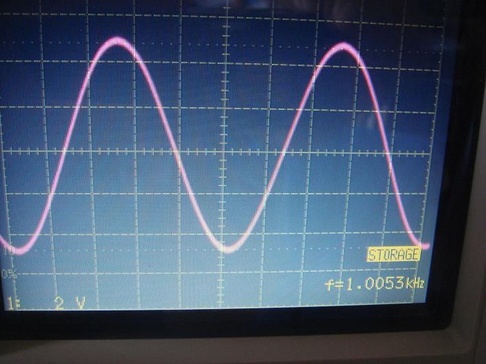

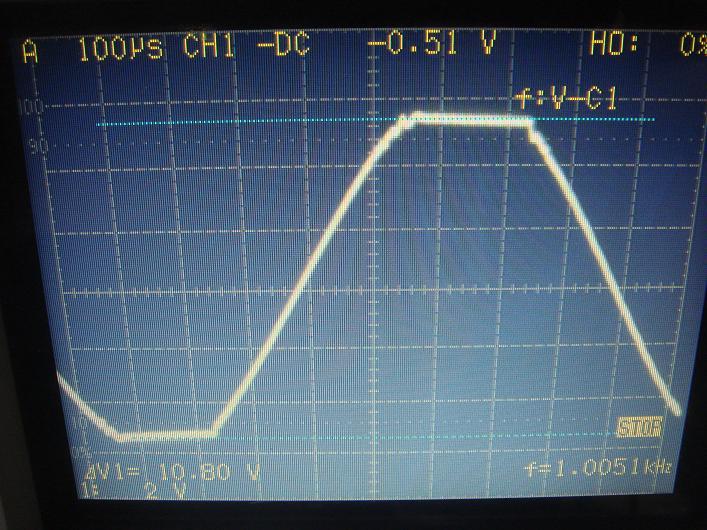

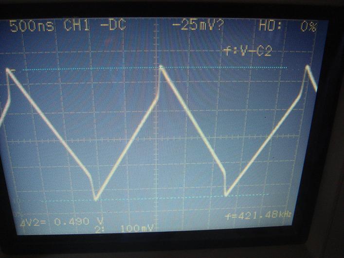

I am using a step shifted triangle, which is giving a good trade off between overall linearity and carrier aliasing.
The first screen shot is showing the step shifted triangle.
The second screen shot is showing a clean 600W sinewave, without ugly aliasing.
The third screen shot is showing the clipping behavior at 54Vp into 2R. ==> 729W.
You can see that carrier aliasing is starting around 600W. Clipping recovery is fine.
All measurements with 10:1 probes, so the voltages in the screen have to be multiplied by factor 10, in order to read the voltages.
