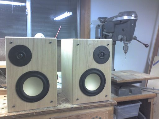

these are my latest project
hivi sd1.1's and m6n's
not quite finished but i couldn't resist

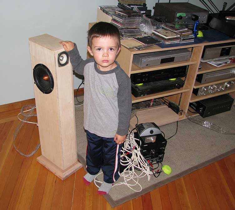

Not often i get to post pictures in this thread... my 1st 2-way in some time. These are currently back in the shop for cosmetic treatment.
SDX7 is 17 litre sealed. FF85 is in a highly tapered aperiodic TL.
PLLXO at 333-350 Hz, 1st order LP, 2nd order HP. Toed in, and with SDX7 EnABLed this lets the SDX7 act as BSC.
They are called Tysen, and the "man" standing next to them is he who they were named after (our godson). He is just under a metre tall.
dave

rcavictim said:
Couldn't help notice the wonderful Deco design influence evident in your fine vintage drill press. Very cool!
Speakers are nicely done.
thanks it's a classic huh? they really knew how to make some sturdy tools back then.

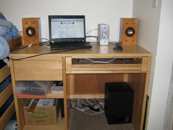

Dr.EM said:
menuoption, thats interesting, I'm working on something very similar also for a dorm room (well, bedroom in shared house). See in this thread:
http://www.diyaudio.com/forums/showthread.php?s=&threadid=128672
How are you finding the sound of those B3Ns?
i left a post on your thread there

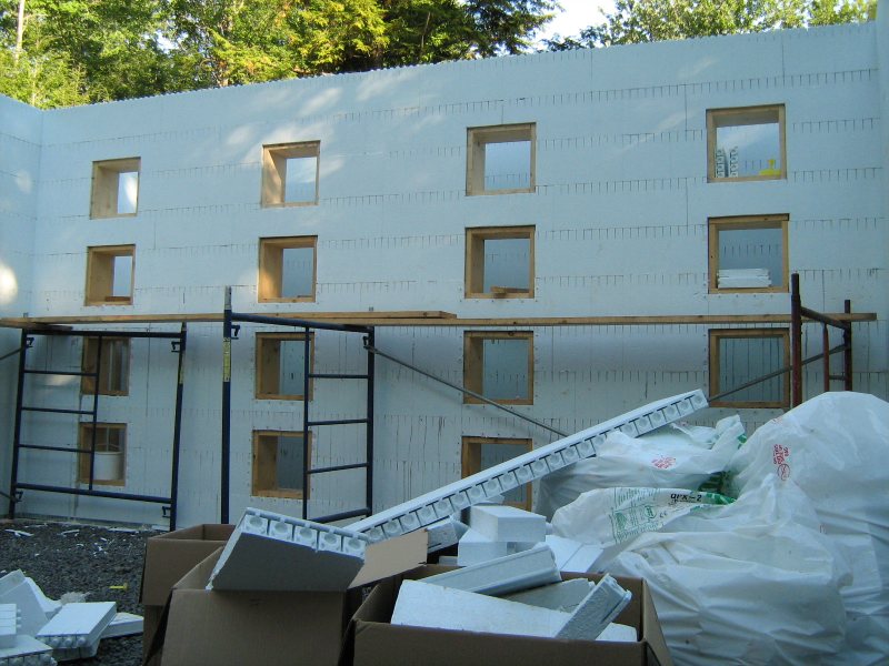

Just wanted to introduce my soon to be HT/music system
in my soon to be new home
it is a project " in construction " of course ...

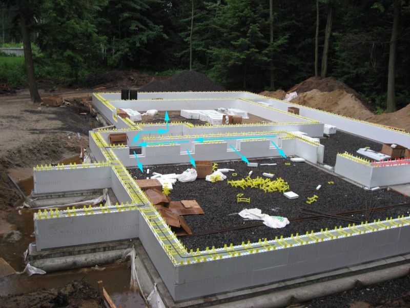

This is an infinite baffle sub wall
based on the front planar wave pattern
will host 16X 15"inchers in the near future
This picture shows the path of the rear port
towars the enclosure ..the garage

also that i had a certain wall area to cover using the woofers and i wanted to stay on the planar wave design,
so i had to cover the wall to a certain extent ..
imagine, i even seriously thought about having the complete front wall move in and out by using 30-50 motors pushing a CF frame/mylar surface
...just didn't have time to built that one
