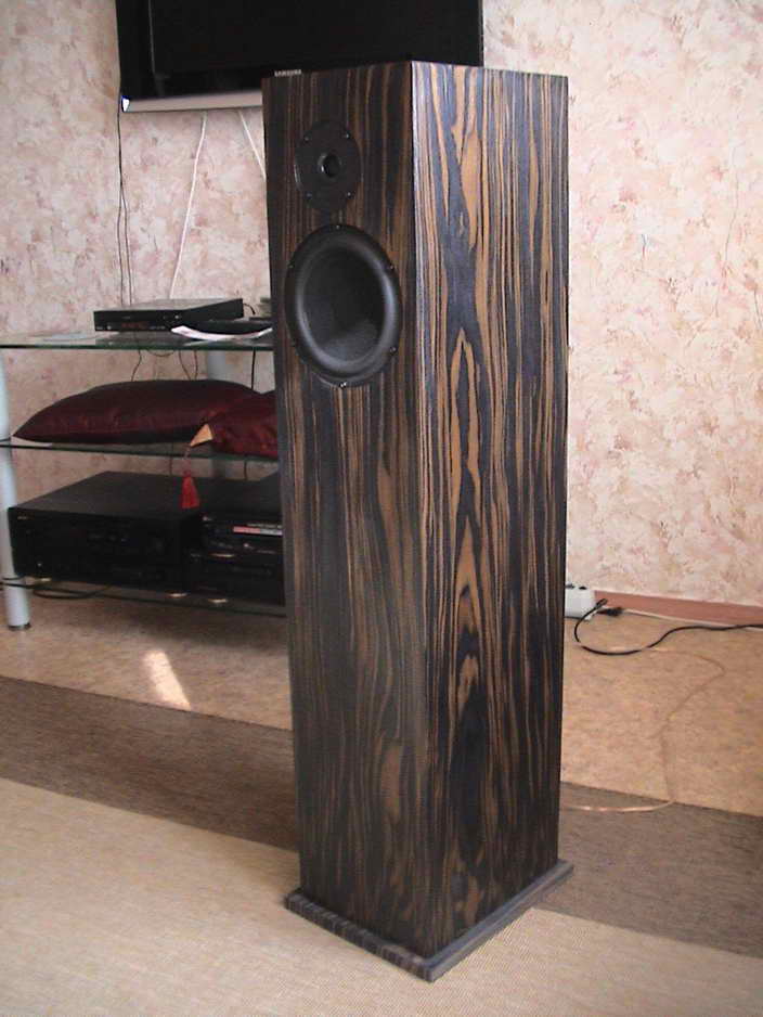

My active DIY system

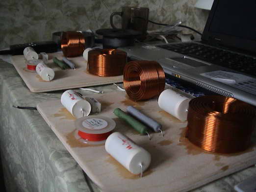

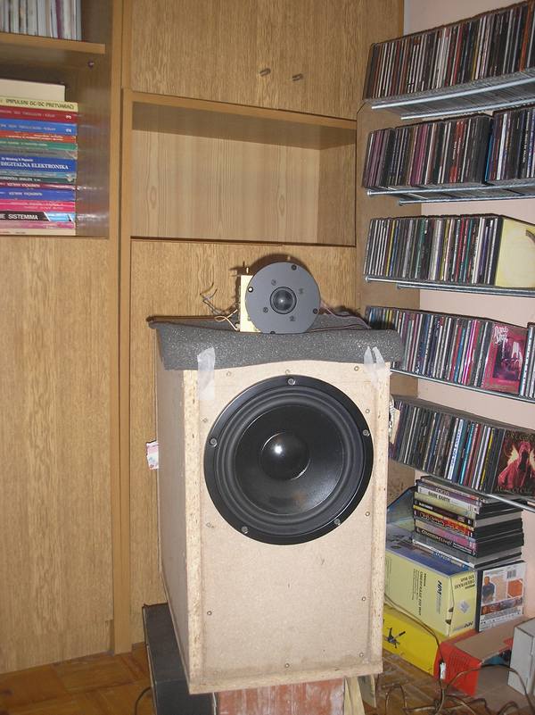

Here is my last project: Visaton W 200 S and G 25 FFL in closed box.DIY active amplification,low-mid amp 1 KW power supply and hi amp is A-Class with 66000 uF , crossover is Linkwitz Riley 3000 Hz 24 dB.Best capacitors and resistors I could find in Bosnia and Hercegovina. Sources are Marantz 5001 and Audigy 2. For my humble taste and experience system is very dynamic and analytic. I am going to build new crossover with lower crossover frequency 2-2.2 khz because I am not satisfied completely with stereo width ( I guess problem is Linkwitz Riley filter or too high crossover frequency, G 25 FFL can play from 2 khz and W 200 S too big for 2-3 khz sound - directivity prob).
Next project is 3 way active transmission line.

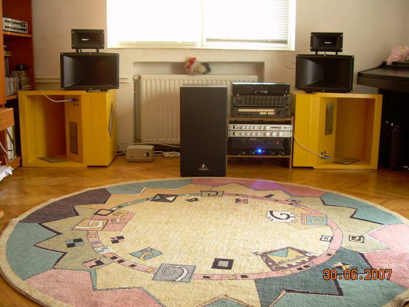

After a long way I finaly get the sound I like w/o loosing an arm or leg. The sound has great extension and good dinamic. Some components:
- Technics tuner and EQ (on a tape loop)
- Gemini preamplifier and crossover
- InterM and APart amplifiers
- bandpass active Behringer subwoofer
- DIY midbass horn (resized Bruce Edgar "show horn") w 10' PAudio drivers
- 2' Selenium drivers and midhorns
- ribbons on horns as tweeters, bulgarian maker
- DIY cables from STP patchcord, IKEA rack ;)
- APC 1200VA line stabilizer for centralized soft start/stop
- crosspoints at 80Hz(24dB/8), 360Hz and 4KHz(12dB/8)

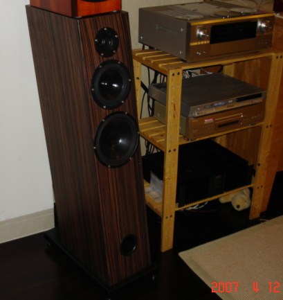

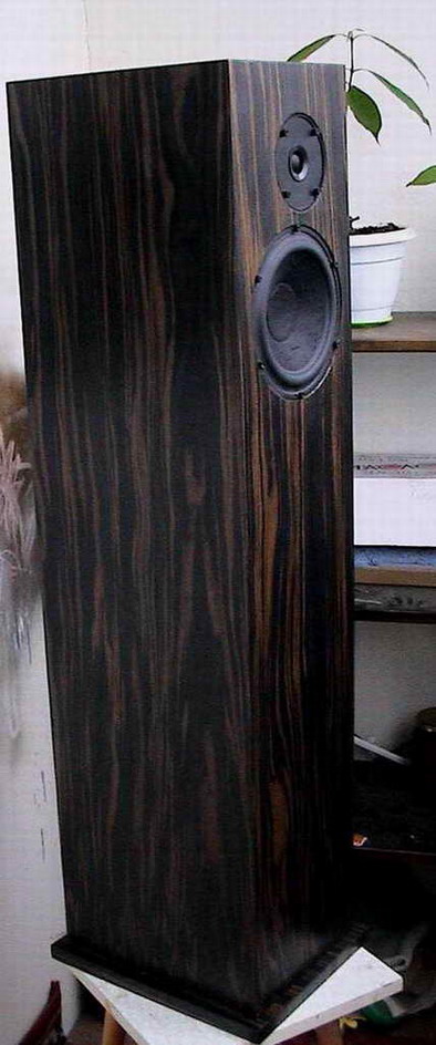

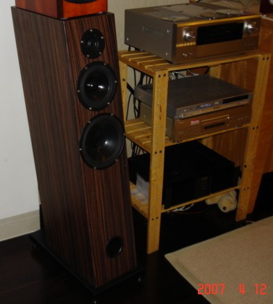

I think they sound fantastic deep deep dry bass, forward midrange and ncie highs. this is the way i prefer as I listen to a lot of smooth jazz and like to hear the voices created in a live typ environment. I tweaked the series filter by ear to what I wanted and have played around with the baffle step inductor for the mid woofer until i got it spot on. I am actually suprised that the PJ17 can really put out some bass notes when the filter is optimised for it.
a bit more about the project.
this project was done in parallel to another one exactly the same but using slightly different drivers.
the woofer is enclosed in its own seperate section with heavy damping of bitumen pads, thick wool and acoustic foam. it is heavily braced and and is capable of very tight deep bass, with very little reinence if you have your hands on the side of the cabinet. the 8" woofer also runs paralell to the series filter for the top mid woofer and tweeter giving me around 3.5 to 4 ohms to the amp, as i have a Nad c350 and a rotel power amp it is not at all any trouble with either amps.
the chrome srews were purposefully used and I like the contrast that they give with the black and the local veneer.
the veneer itself is a local Borneo species similar to the Ebony Macasar by looks at that photo supplied. I cannot remember the name but living in a Million year old rain forest certainly does have its advantages for using unique timbers.
I have just fnished the second pair and they use as well a series filter ontop and a paralell inductor for the 8" woofer in its own seperate as above.
this time I put all the drivers closer together and the mid woofer used was a Vifa PL18 as i had heard it had a greater amount of midrange clarity compared to the PJ17 mid woofer used previously.the peerless woofer and the vifa tweeter remain the same.
Whom ever said that this 8' inch woofer has no low bass extension must have been joking. I have listened to medium levels of jazz music and the bass guitar is vibrating my chair, without any resinence from the cabinet itself.
it has at times been a real struggle as I live in Borneo and the DIY hi fi is absolutley non existent and I had to import a lot of drivers and crossover parts from Australia as well. I had to use also car bitumen and sound deadener as i was not prepared to import too much otherwise the costs were getting too high.
I also went and bought a shed load of pillow stuffing as it is cheap and basically the same stuff as acoustic stuffing anyway.
so i will post the biger brother to this one in the next couple of days as I have started anothr project using a seas 5" aluminium woofer in a mini cabinet, and a tannoy mx4 tweeter that i have modified using a philips 80"s face plate, the mini monitor will be coming soon!!!
