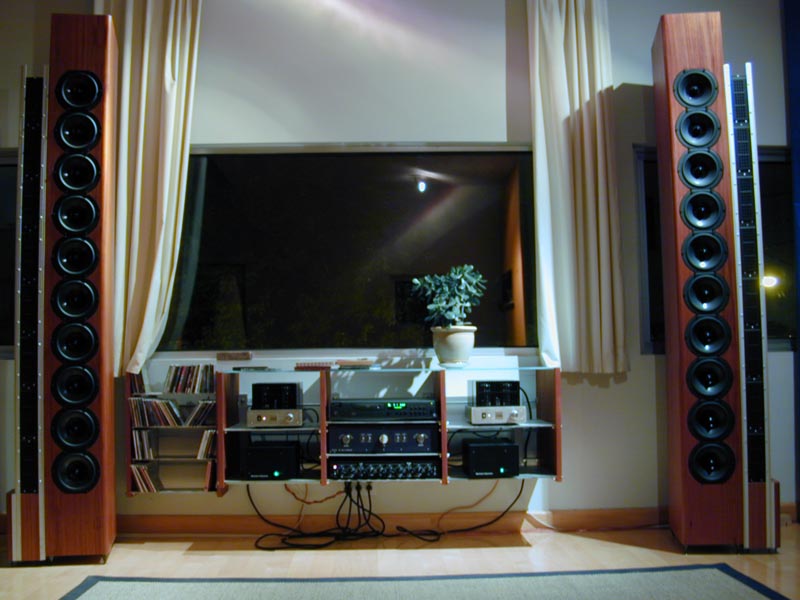

My turn to join in.... Speakers are DIY, Peerless and B&G planars. Source is Arcam 8SE as a transport feeding a modified ART DI/O. Pre amp is a passive transformer TX-102 from Bent Audio. Active crossover is a modified XM9 three way from Marchand, Amplifiers are two Marchand MB201 for the low and midbass and two Halo SPM25 tube amps fpr the highs. XO frequencies are 50Hz and 1000Hz. I'm in the process of building 4 subs using 4 Peerless XLS 12" and 4 passive radiators.

Awesome.
What's the efficiency?
