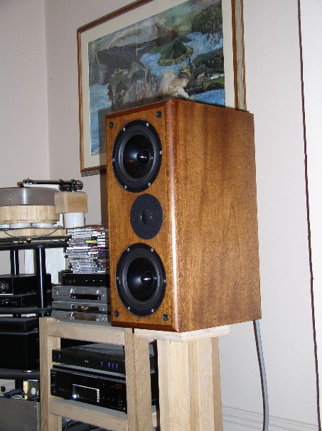

Have way more ideas than I have time to complete them, like many here. The picture below shows my recently completed Modula MTM (Jon Marsh's design on htguide.com) in DIYBOX's cabinet.
The TT you see in the background is a Teres TT that I built the plinth for. The stands are my fault too.
What you can't quite see in the picture is that I am currently using way too many sources (Teres, Tuner, SqueezeBox2, Pioneer DV578a, Sony XA777ES, PVR/tuner). The DAC/ADC/Pre is a DEQX, the amplification is UCD 400 modules. Power conditioning is done by 3 Felicia's (on another forum).
This is the stop gap system till I complete what projects are in the works currently. I have high hopes for the results, but don't we all? 😉

Cal Weldon said:Mr Noodle,
I have always appreciated when you can leave the XO external for further tweaking if necessary.
What are the cabinets made of?
Cal
Cabinets are 18mm MDF walls with a laminated 36mm MDF front and two front to back 12mm braces above and below the tweeter. The veneer is Tasmanian Blackwood

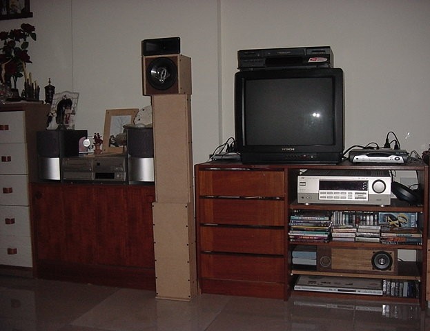

Finally the pics of Francis' apologies;
The system😱
In the rack,
the lowest component - DVD player (Philips)
over this comes the centre channel speaker(DIY)
over this is the JVC AV receiver

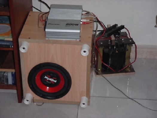

right hand side is the sub and its appendages
on the left is one main speaker
Must be the worst looking system on the planet. I promise to better the looks.
I'm in the process of re-working the mains so that they are capable of holding their own without subwoofers.
There is another dainty syatem on the left extreme; this is my little joy - the JVC mini HiFi EX-TD5 which was the best little system in its day(circa 1997). I use this for cassette tapes and audio CDs only.
Humbly,
Francis

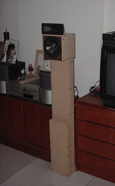

Cal,
Yes it is. I'm glad to make someone gulp at the thought of my system(hope it is out of awe)😉 .
This tweeter is a Radioshack and very efficient due to horn loading. I like the fact that there is no crossover to muddle up things.
The only HF filtering is the crappy capacitor built into the main driver (for its own teenie-weenie tweets), which I may disconnect later.
Francis

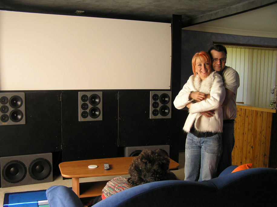

In case anyone is interested...
This (attached photo) is my current front stage and 2.35:1 screen. The LCR (left Centre Right) speakers are identical units each using 2 Vifa 6 1/2" woofers and three Vifa "ring" super tweeters. Crossover is 2nd order LR network at 1550Hz...
The Surrounds (not pictured) use the same drivers,(with only two tweeters and modified crossover) and are bipolar in the same size enclosure. Their drives are mounted on opposite sides and fire front and back...
The Subs use Peerless active/passive combo XLS drivers and 350 watt amp...
Overall, I'm pretty happy with it...
Mark

Who's the one receiving the MASSIVE bear hug? A woman that appreciates fine audio equipment and MASSIVE TVs?
That settles it - I need to start making plans to move to a country with women like that. The only women I have ever seen smiling around Audio / HT equipment till now are usualy in the films I watch.
That setup must make some nice sound
