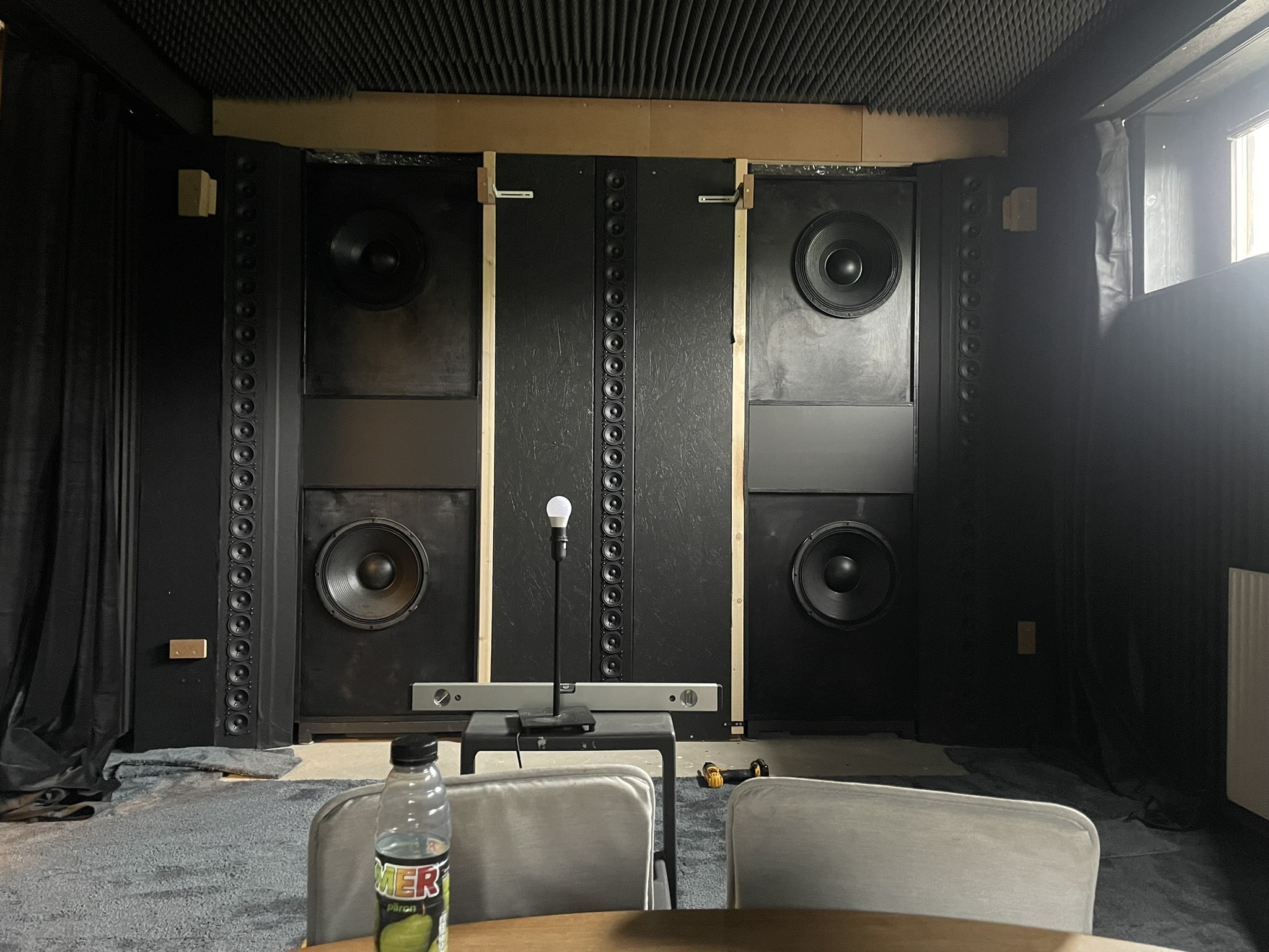

Almost done with the cinema: 24x 3fe22 for LCR, 2x 4fe32 for surround (1,5 way), 4x 15TBX sealed for LEF and a 3m wide AT-screen.
Was going for a DBA but at the moment I cant justify the cost of 4 more woofers.

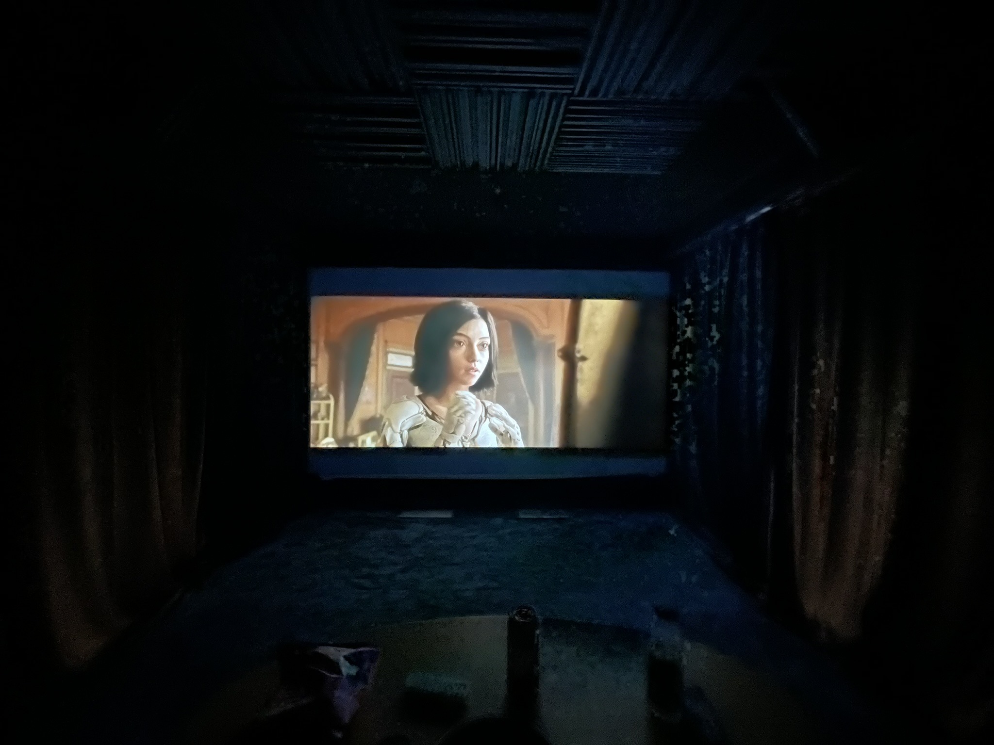

Hard to photo a dark room.

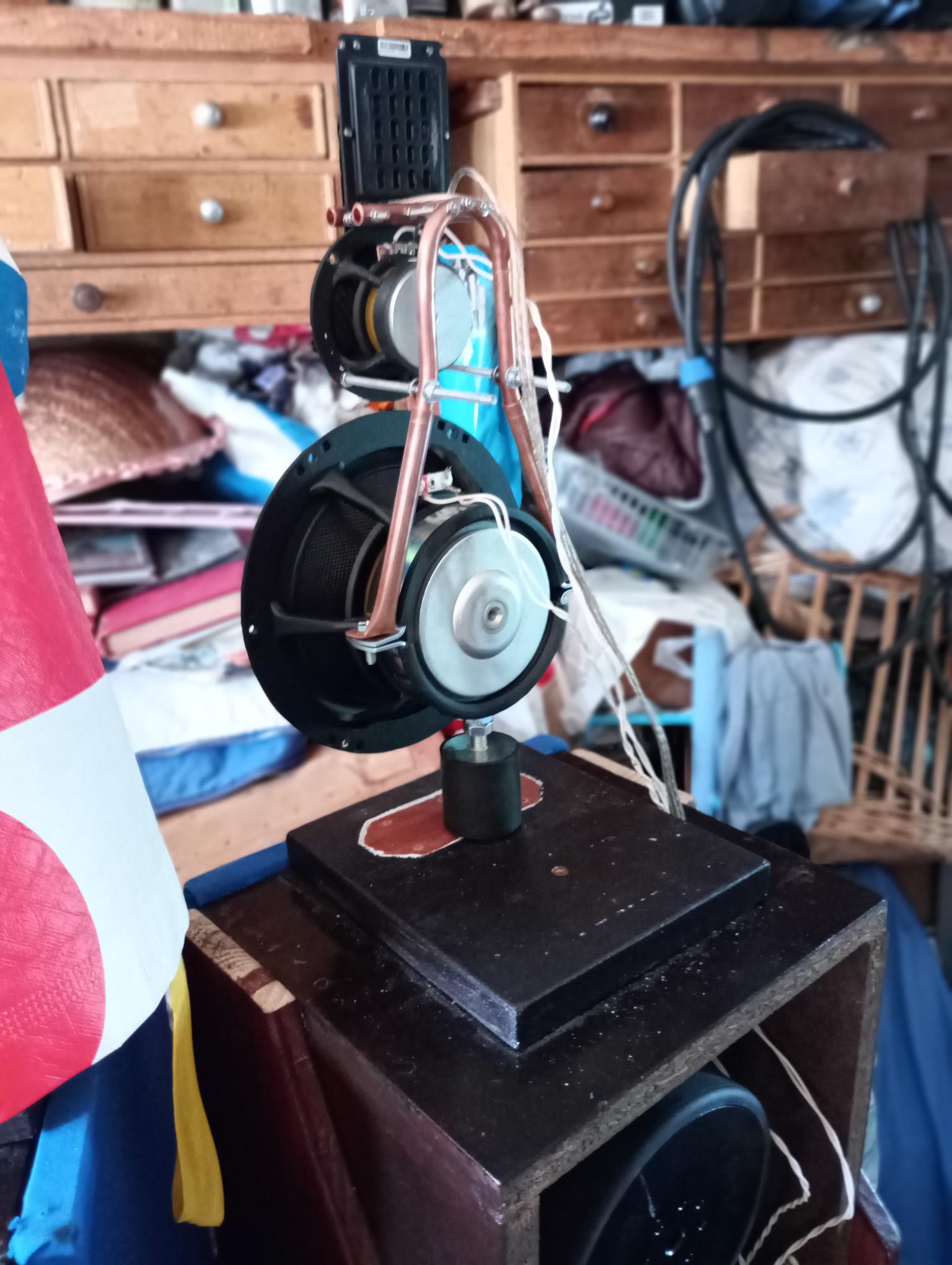

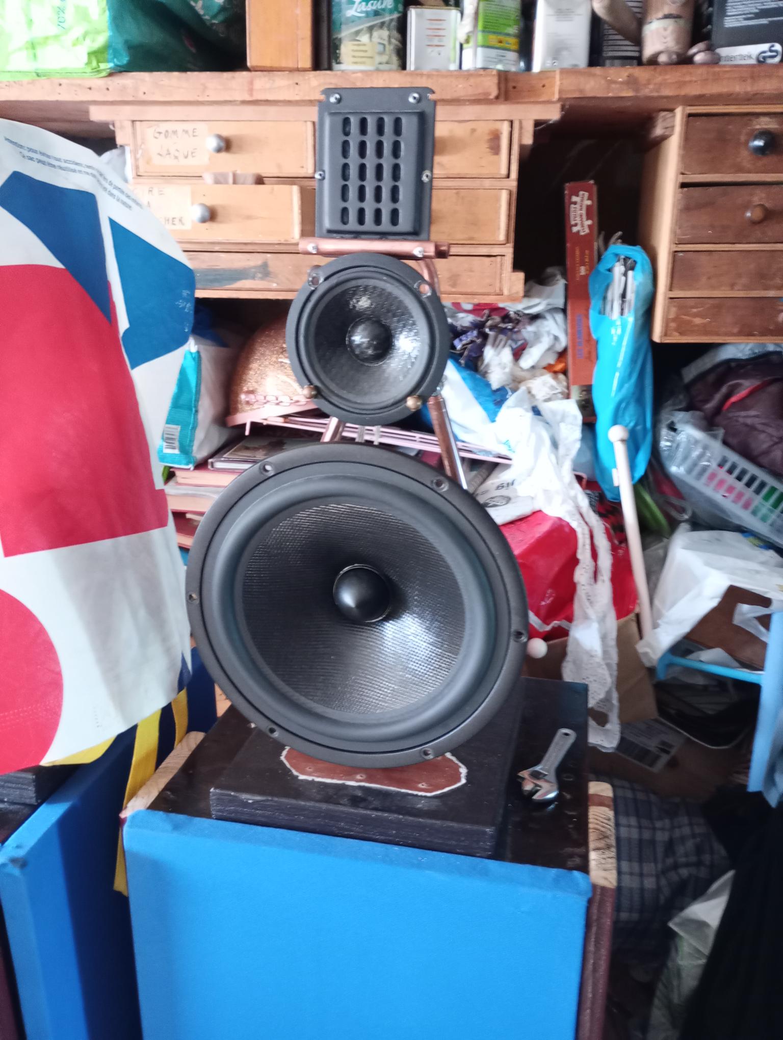

Messing around with these 4 way dipoles modeled on Linkwitz LX521.4. Drive units from top to bottom are Neo3PDR Tweeter, SEAS FU10RB Upper Mid 4", SEAS SEAS U22REX/P-SL 8" Lower Mid all without baffle, SEAS L26RO4Y 10" SUB in H-Frame, crossed over presently at the same points as SL's 7kHz,1kHz & 120Hz, but with variable ASP based on 3x Nelson Pass' DIY BIAMP boards.

1st picture:does the hifi powwr the LED light?
How big is the room behind?
dave
There's a vid on YouTube of someone punching a sub to generate electricity to light up leds, I think he broke his hand - not realizing he'd be hitting the speaker magnet after about an inch; but perhaps some active bass traps could recover some power.

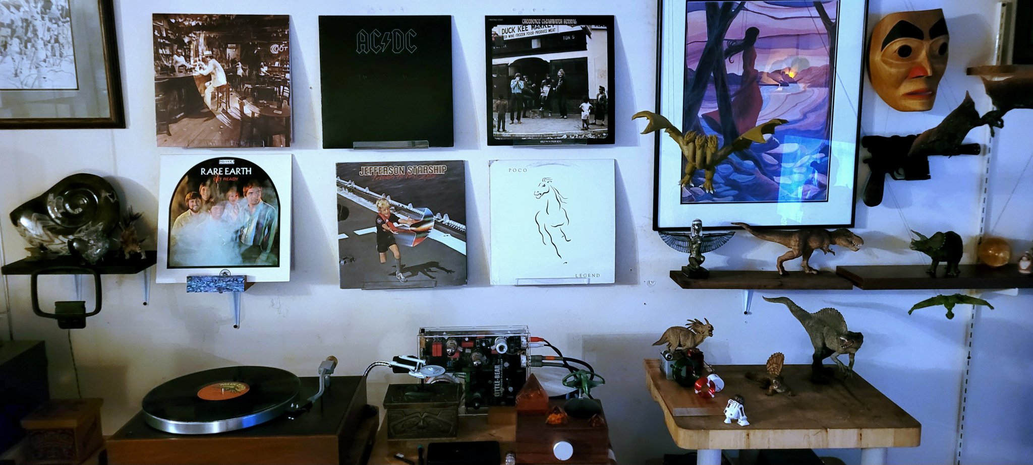

Refreshed AR XA turntable with a Shure M55E cartridge with a new stylus so I can keep track of the hours on it.
Feeds a Little Bear phono stage, and volume is controlled by a new 100K carbon film resistor stepped attenuator in an old teak case, originally using a 10K attenuator intended for all solid state set up.
Not state of the art, but good enough for me controlling a little highpassed 10 watt class A power amp and a plate amp for an open baffle stereo pair and open baffle bass panel.
