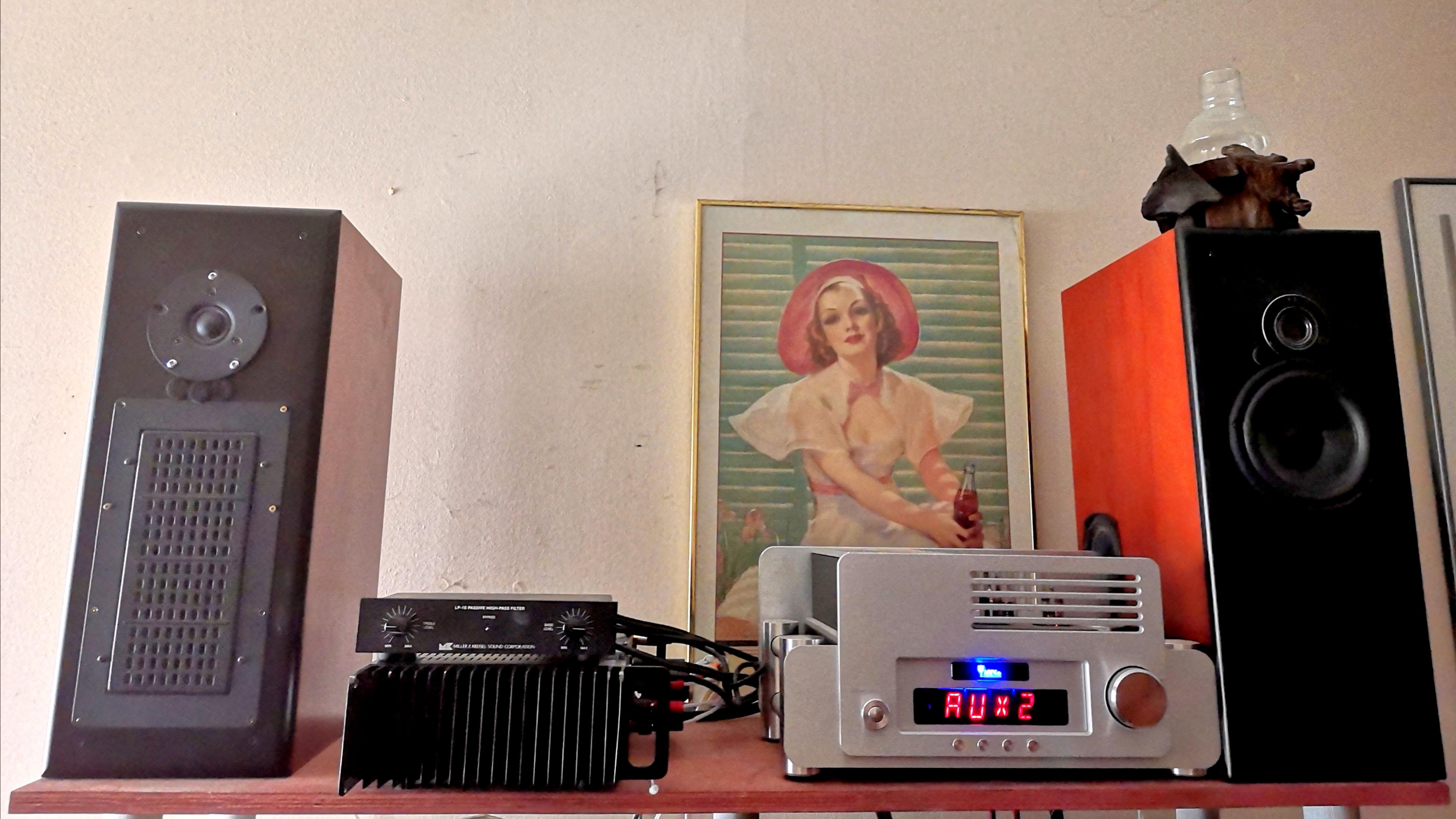

I've finished a pair of Revelator based satellites, passively filtered at 90 hertz, with some inexpensive MKP Audiophiler caps, Solen Split to the AMT tweeters at 5000 hertz, with a Solen Hyperlitz inductor, and some KZK film and tinfoil caps. All cabinets are sealed.
The satellite on the left is based on the Bohlender Graebener Neo 10. Here, they are isobarically installed, facing the same way, so the magnets don't repel each other. It's paired with a 4 ohm Scanspeak fabric dome tweeter, for better off axis listening than my Neo 3PDR.
It's Solen Split at 200 Hz, and 5000 hertz, with some Dayton 5% caps on the Planar mids, and some Mundorf EVO Aluminum Oil caps.
Going to listen awhile, before deciding if I'll make another planar.
So far, it sounds better than the Revelators, but at more than double the price in drivers, I think it shouldn't be close.
Others have been so happy with their Neo 10s, even a few customers who've bought my designs with them. I just feel like I've never gotten the best out of them.
These do sound excellent, and I shouldn't grouch about them sounding better than my Revelators.
Isobarically does make a more forceful presentation; I always found them a little lacking in excitement, or dynamic snap, in Helmholtz tuned enclosures, open baffle, or in skeletal " cabinets", with solid tops and bottoms, and thick felt cloth sides.
Anyways, I'll leave in for a while, then decide on their future. I've been using an old Polk 10" sub, but tonight I'll pair them up with one of my RSS265HF-4 subs, magnet out in a 1 foot sealed cabinet, densely packed with wool, powered with an older Dayton 1000 watt plate amp.
Any one here tried the planars in sealed cabinets before?

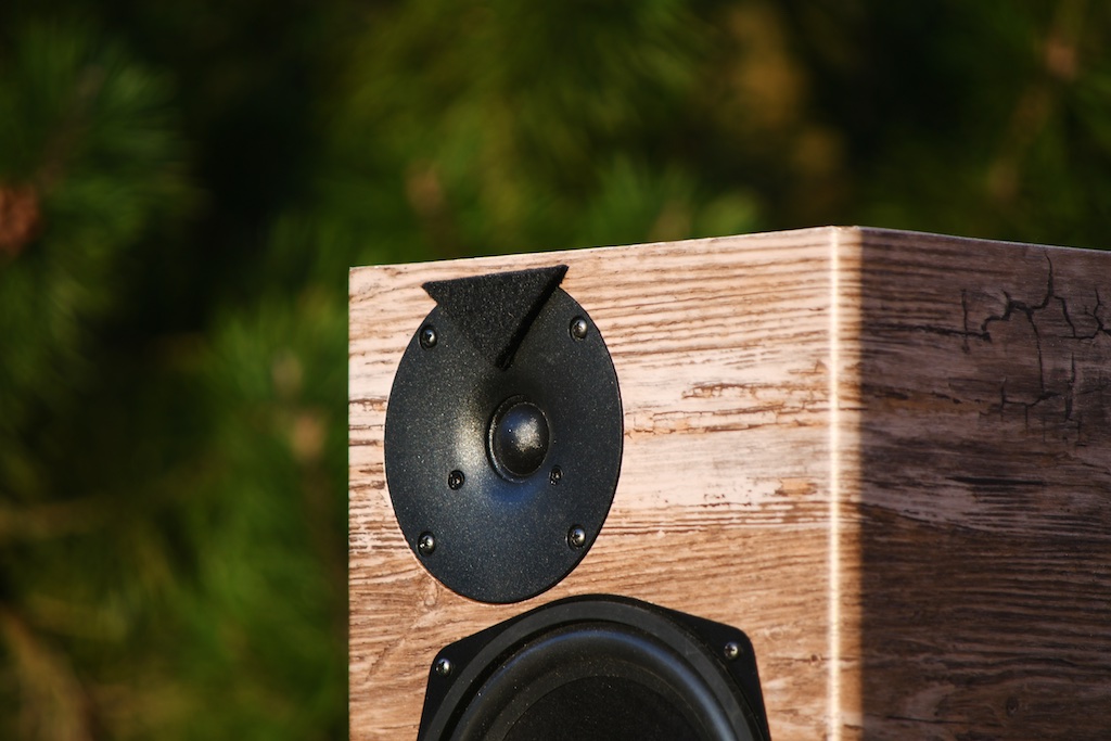

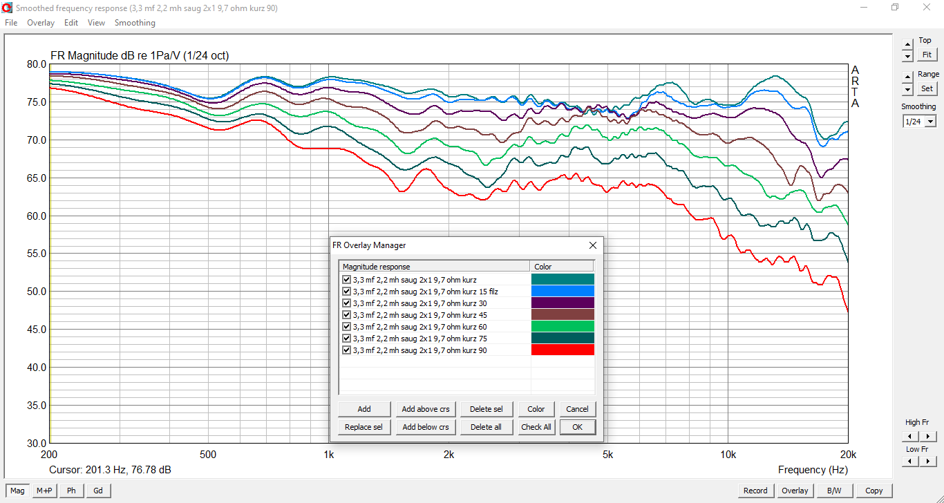

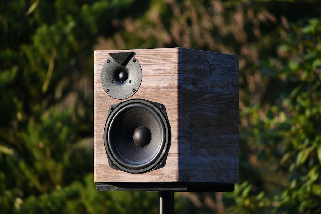

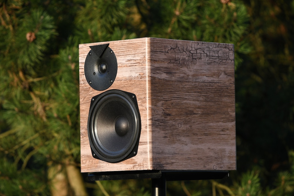

A cheap 2-way with Tesla ARN 5614 and Wacecor TW022WA05, drivers coming secondhand and from ebay. Crossover at 2.250 Hz and yes, the felt triangle is improving the sound ;-).

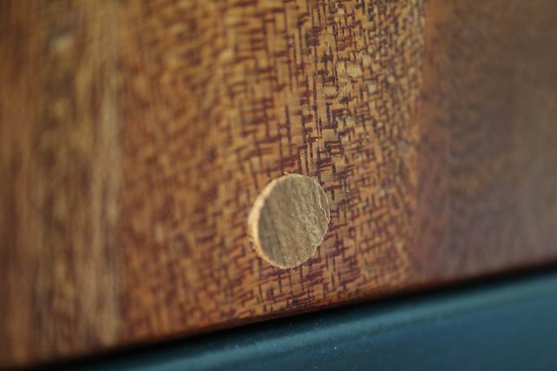

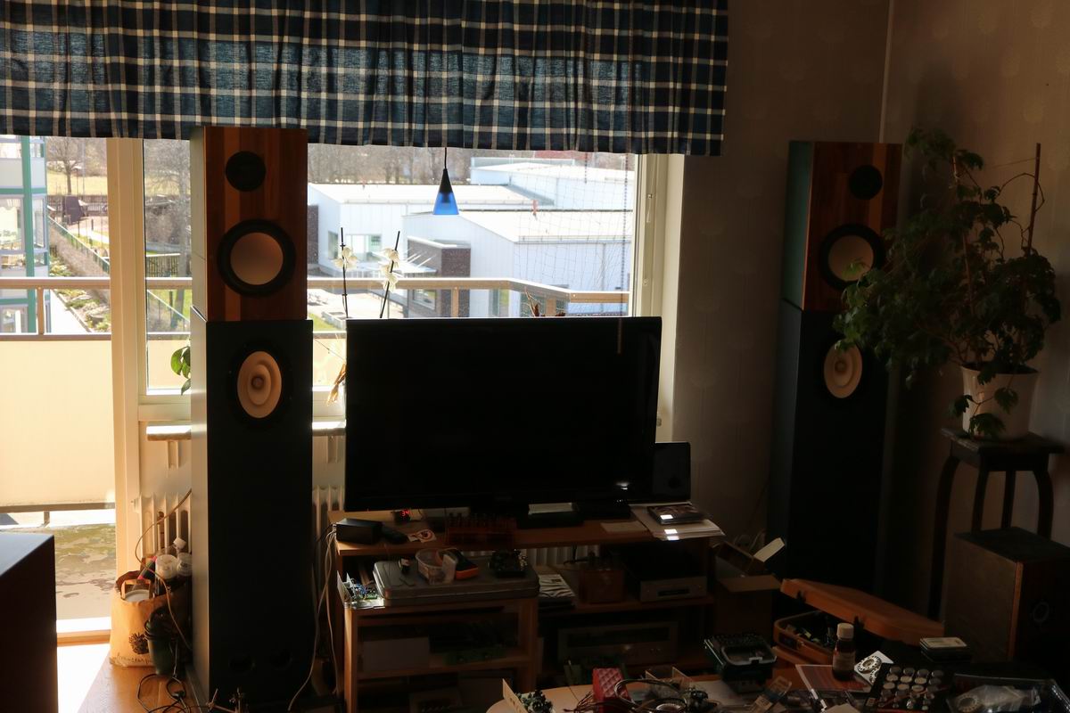

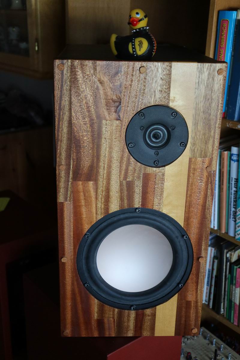

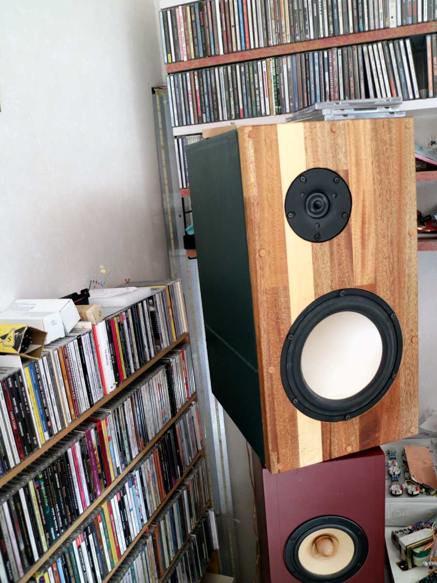

Many many years ago I read an article in AudioExpress (2004/05?) about the construction of a 2-way speaker. The author had spent quite som energy (and certainly money) fo come up with a final design.
This project haunted me for half a decade, until I decided I had the energy, financially means and a workshop to build myself a pair of this design.
That's is basically the background of my speaker. The articles gave (almost) all information but tracking more specific info on the cabinet was tricky, but I managed to get info on the factory-made-boxes, and doing some calculations came up with something of the same internal volume as the original.
I am using 22mm MDF for the box and 25mm massive palisander or teak for the baffle.
Drivers are HiVi M8a and Vifa T29 ring radiator. X-over is a 24dB elliptic filter for the tweeter and a 12dB for the woofer.
Though these were finished almost 10 years ago, I have very seldom used them and they were laying around waiting for some final cables to the L-pads I installed over a year ago. But the last two days I have had them hooked up to my most powerful amp - a 3W SE tubeamp and have had to turn the volume up a lot.
However I am VERY pleased. They are half as big as my Sonido 6"x9" fullrange speakers, but, so far, they are as impressive. They manage to play the lowest and the highest notes perfect, leaving nothing else to be asked for.
Here's some pictures. Also on the pics, the 5" Sonido FR horn, 6"x9" Sonido FR vented boxes, and a close up with the Quackti disturtion-muffler :D.
Trying to get a MX50 together to get som more power and just bought a Linx Nebula from UK.
