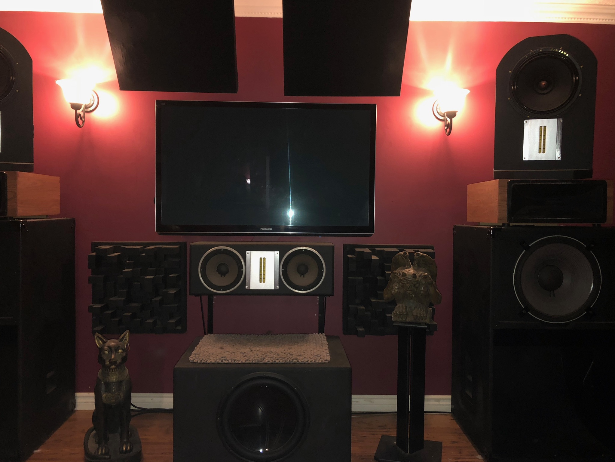

Updated system pics
My system has been upgraded so much it demanded me loading new pics. I built a new CC using JBL 2118j’s and Hivi RT2ii ribbon. Side ported, individual compartments.
Installed the Hivi ribbons on the open baffle AN Super 12’s as well.
Got rid of the Eminence Alpha 15a’s, replaced them with JBL 4530’s loaded with JBL 2226h drivers.

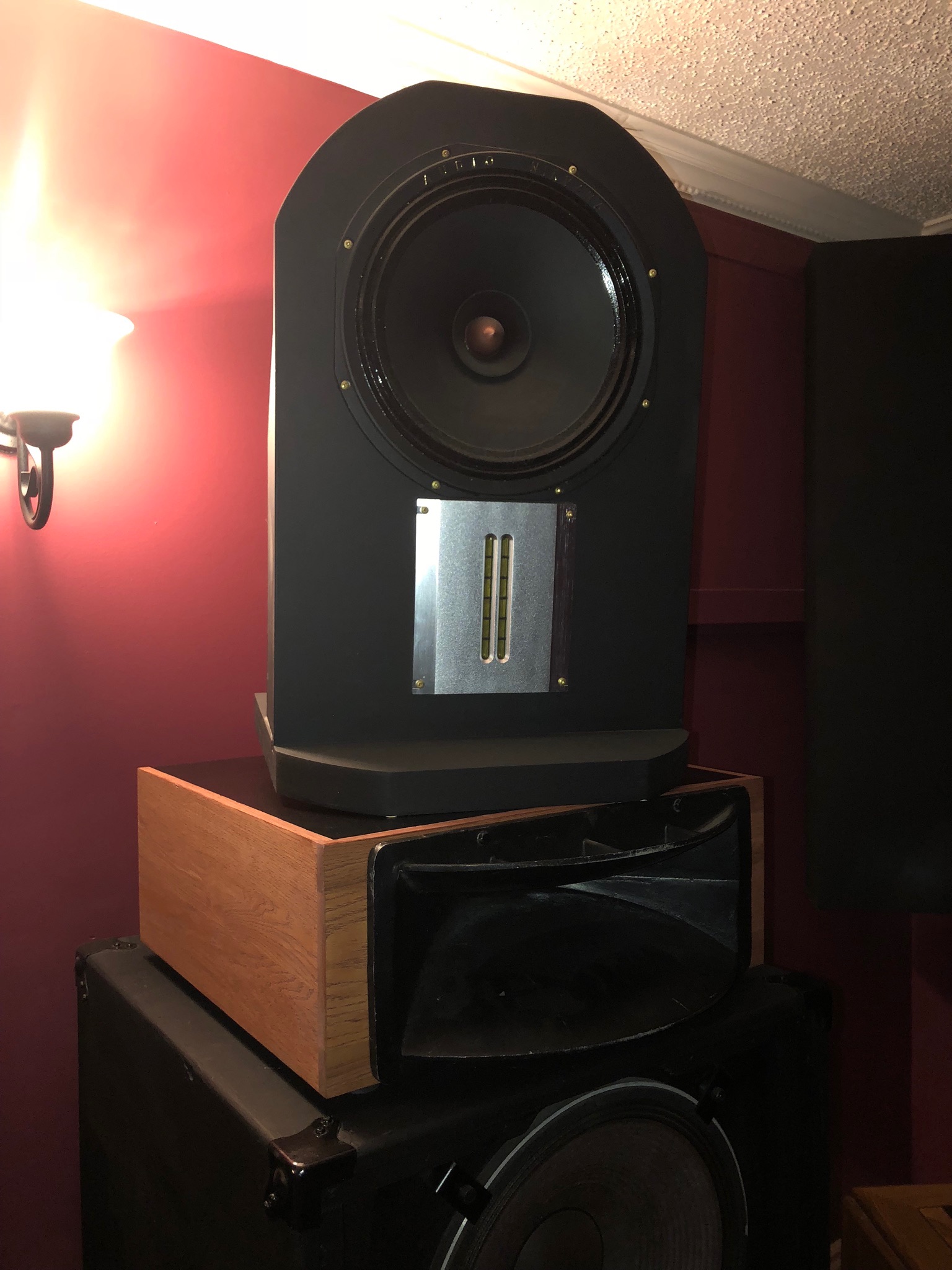

Finally, introduced a set of horns to the system, Emilar EH 500’s with EC 175 8 drivers.

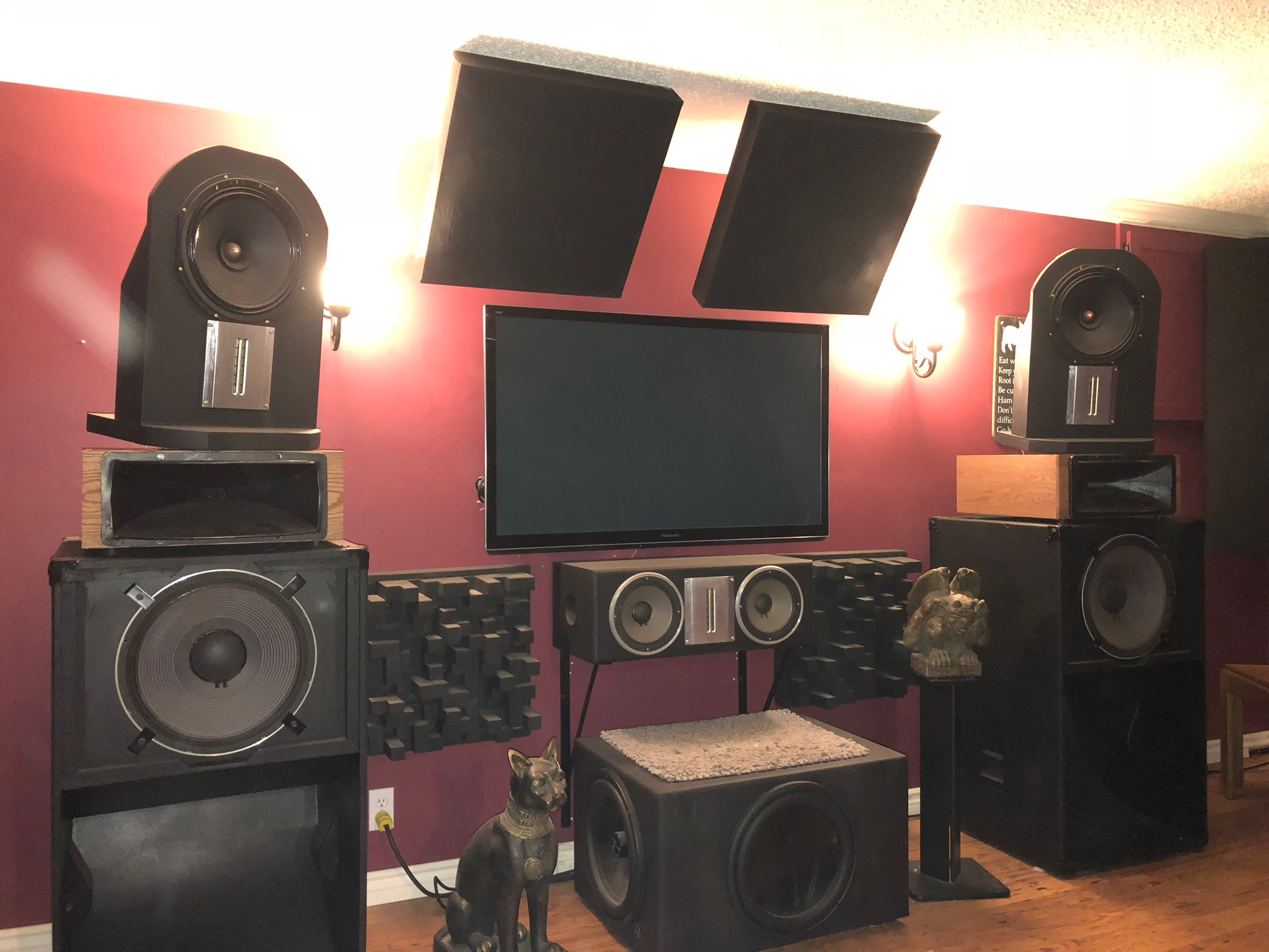

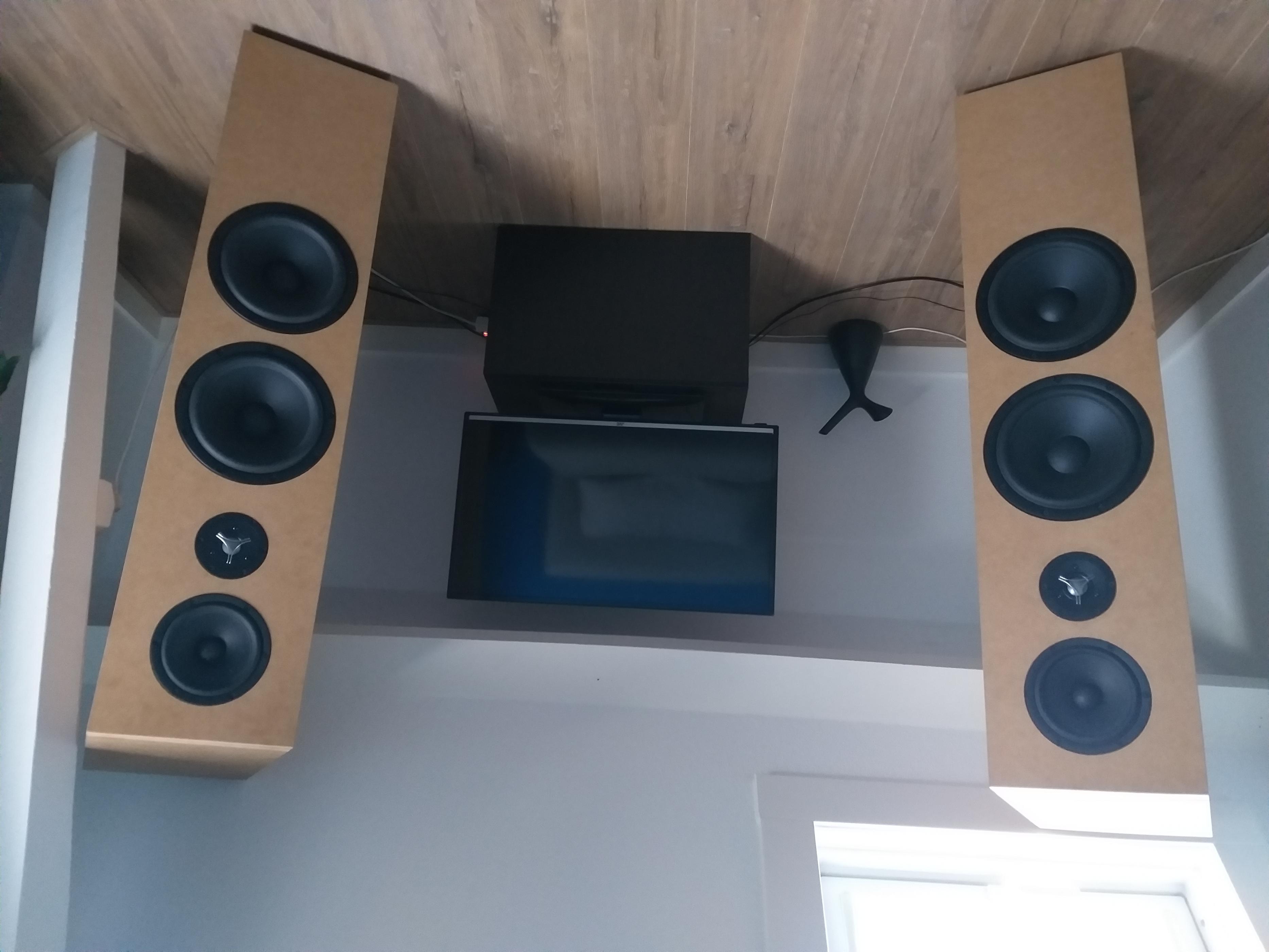

I'd still see your white version.. I'm also planning speakers in piano white.. it would be great to see a pair of such.. 🙂
I chose white because the rooms here are painted white and it would make them more lowkey and grab less attention.I'd still see your white version.. I'm also planning speakers in piano white.. it would be great to see a pair of such.. 🙂

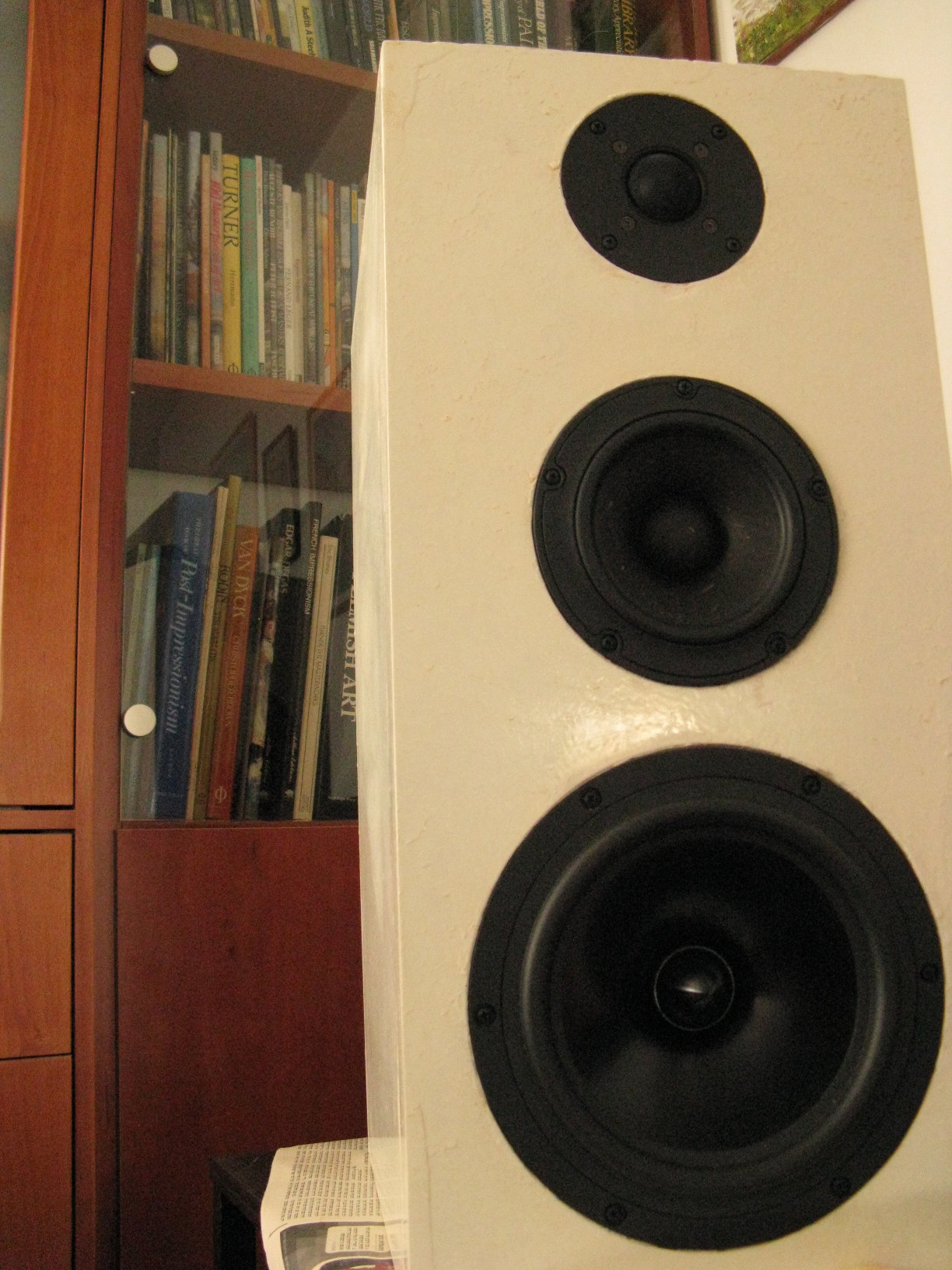

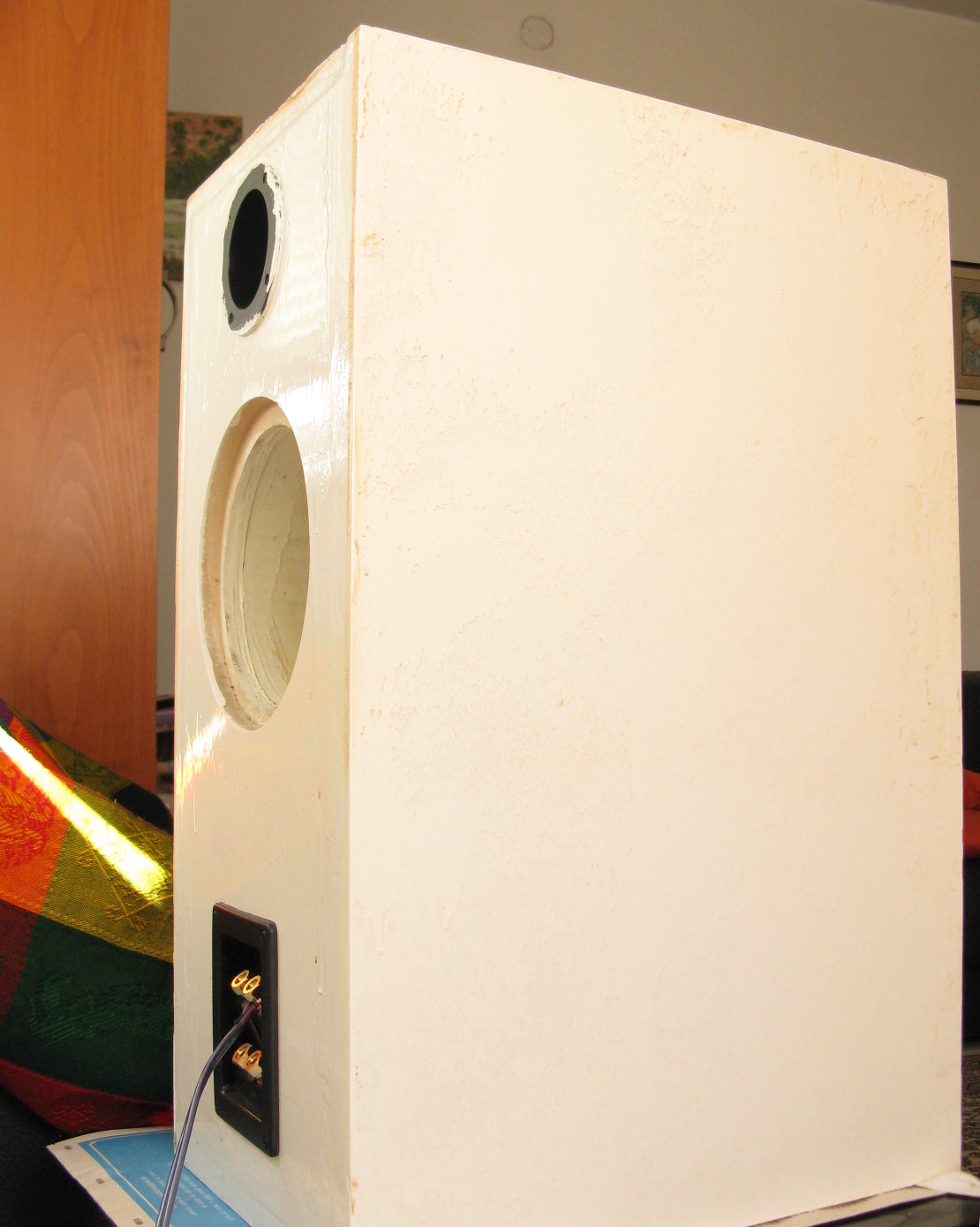

Two low quality photos I just took with my phone. I really cut corners at the end and didn't bother to fix the pink polish stains and a few other cosmetic flaws but nobody even notices from afar... I'm mostly concerned with sound quality. I just listened to the Jacques Loussier Trio, and these babies sure deliver.
Hmm they still look okay 🙂

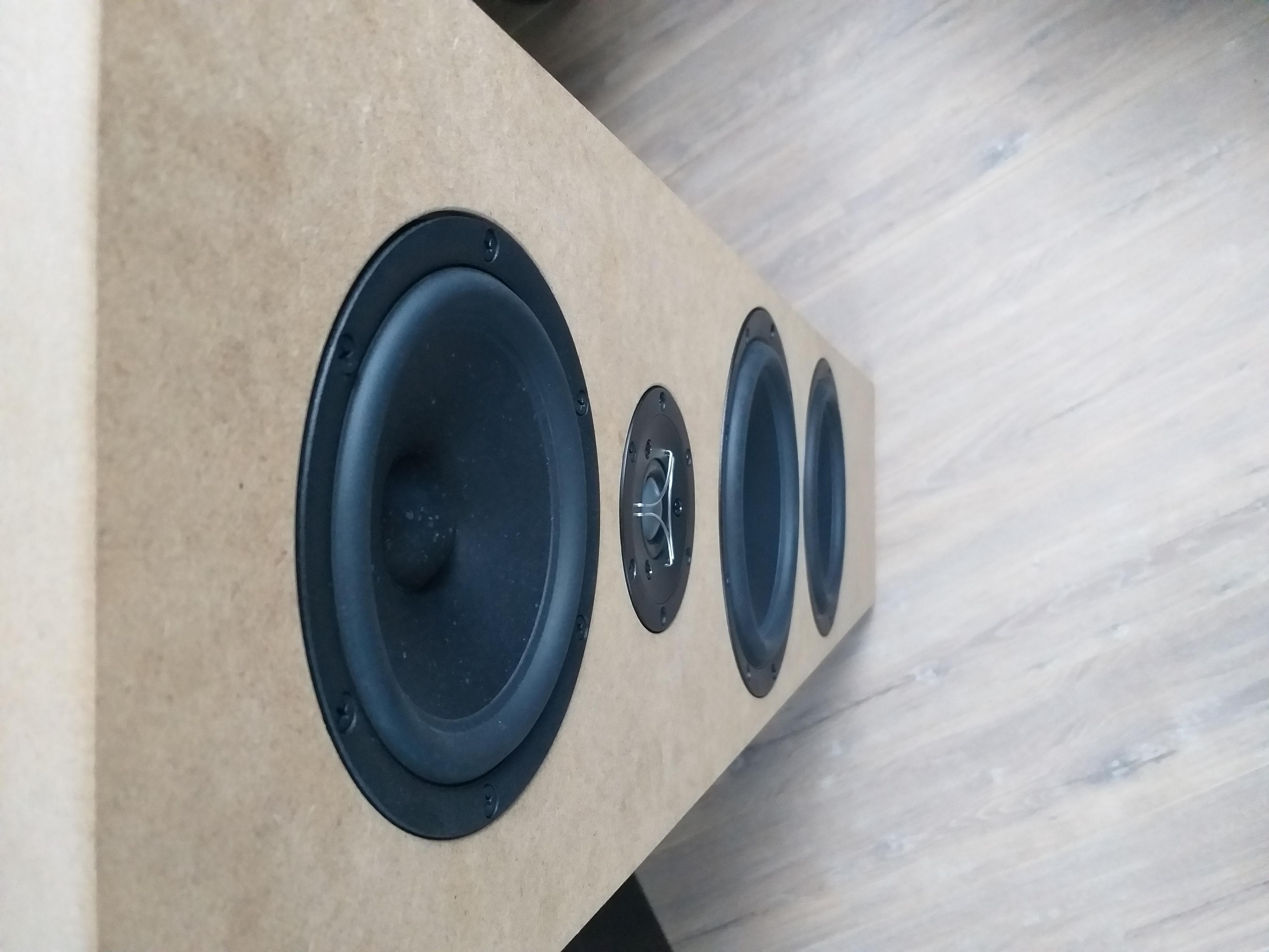

I can’t help but notice that tweeter and midrange are much closer together in designer s photo than in your design. Is there anything I’m missing?
I don't know how that happened. Maybe since the MDF thickness is different here than in the original design (metric instead of imperial) I adapted the design and ended up with wrong proportions... I know from an engineering perspective it makes less sense in that configuration but they still sound OK. I'm not going to rebuild them because of that...😛I can’t help but notice that tweeter and midrange are much closer together in designer s photo than in your design. Is there anything I’m missing?
I think there's another mistake, the mid drivers look a bit too standing out...

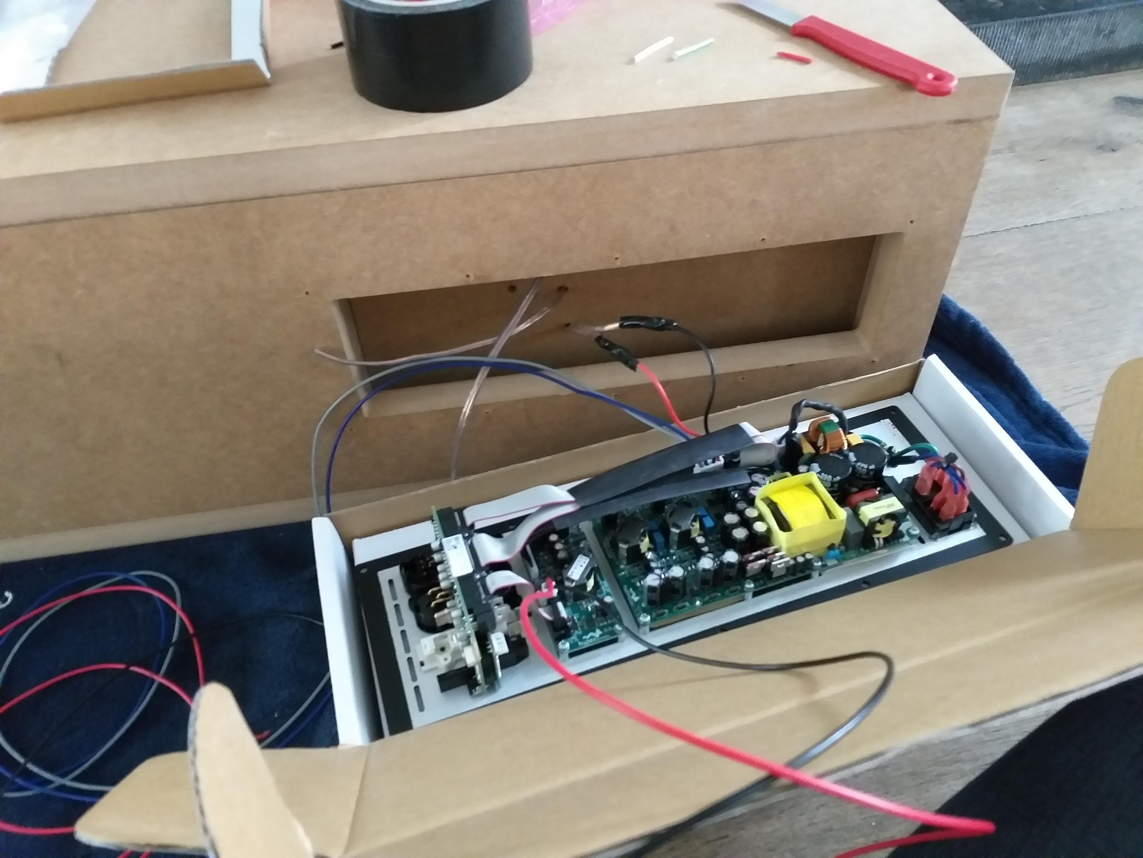

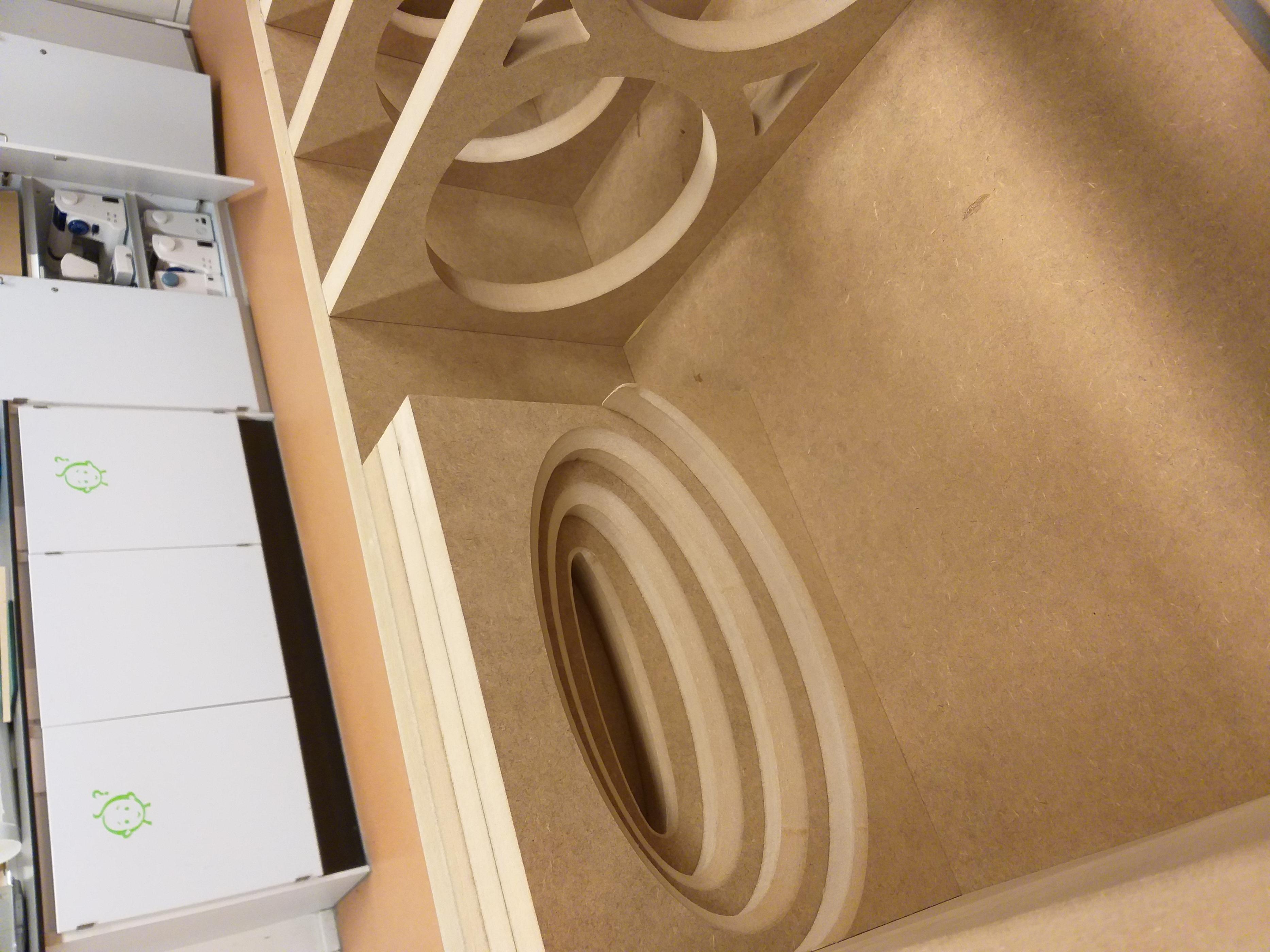

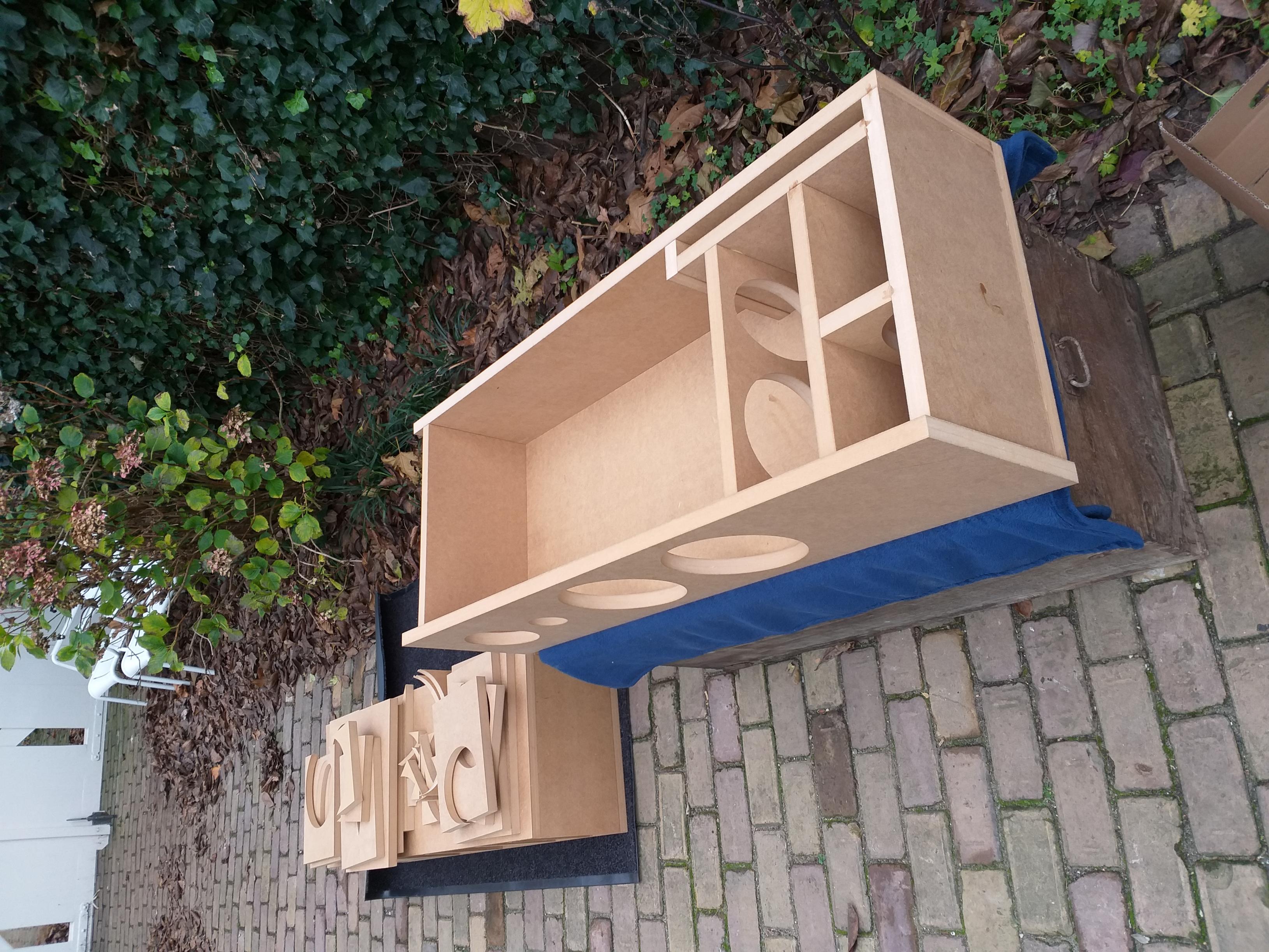

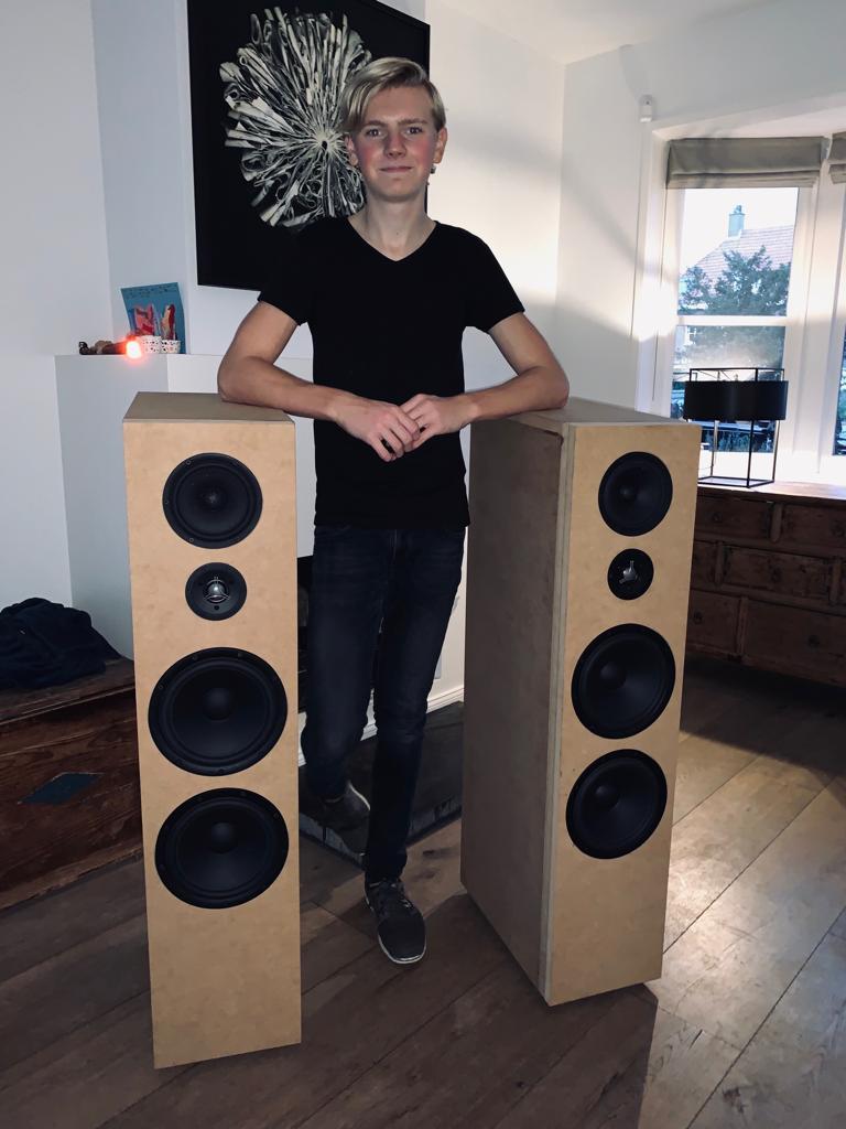

(Nearly) Finished my active speaker last week. SB-Acoustics Satori TW29B-B, MR16P-4 and dual WO24P-4's. Midrange in a 15+ L sealed and optimally shaped chamber for extremely low compression and prevention of reflections and standing waves. Woofers are in 58 L sealed chamber. It's all powered internally by Hypex FA123 plate amps with built-in DSP and active crossovers.
Crossovers and DSP have yet to be set properly, damping material has yet to be added and a couple of leaks have yet to be sealed. Though, already, after just a few hours of playing in some pretty bad placement in a way too small room with the speakers not even totally finished yet and far from optimized. They sound amazing. Absolutely astonishing. They exceeded all my expectations.
Soundstage is incredible. Very deep. Imaging is also superb since they entire midrange from 300 Hz to 3,5 kHz (which is the most sensitive range of the human ear and the frequency range of the human voice) is coming from just the MR16P-4. Midrange is very clear, full and snappy, just like I want it to be. And the tweeter and midrange deliver clarity, transparency, and detail that I've never heard before. And I've heard a lot of very good stuff with one of the best hifi stores in the Netherlands, Chattelin Audio Systems, just 15 minutes away. Bass is very tight, punchy, natural and powerful when I want it to be. These speakers are in their entirety some of the best I've ever heard.
For scale, I'm 6' 5".

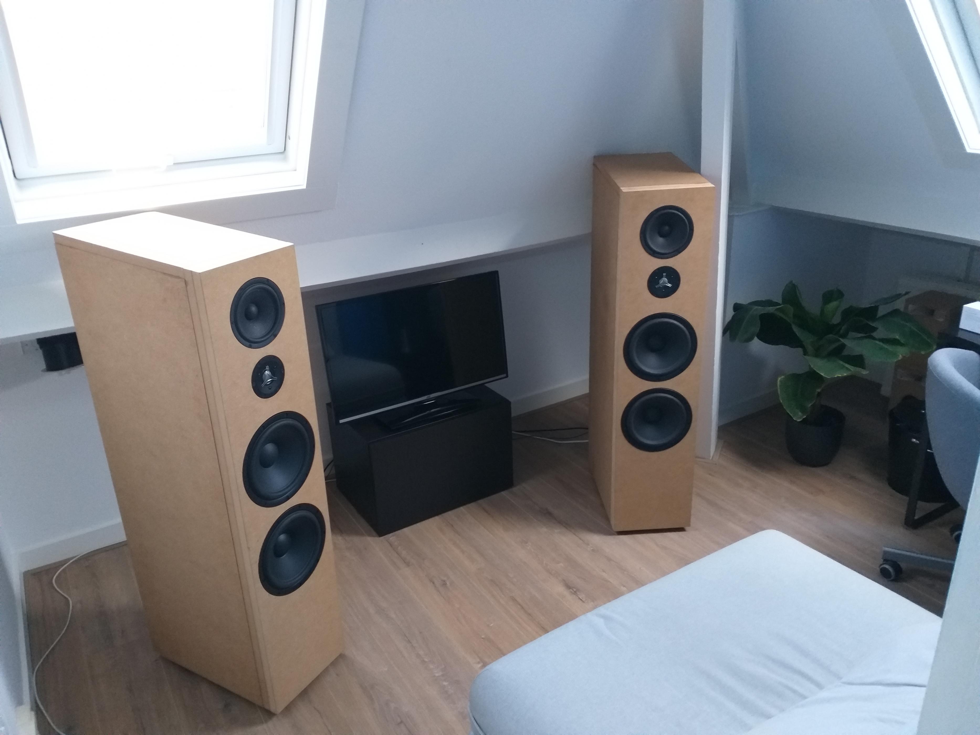

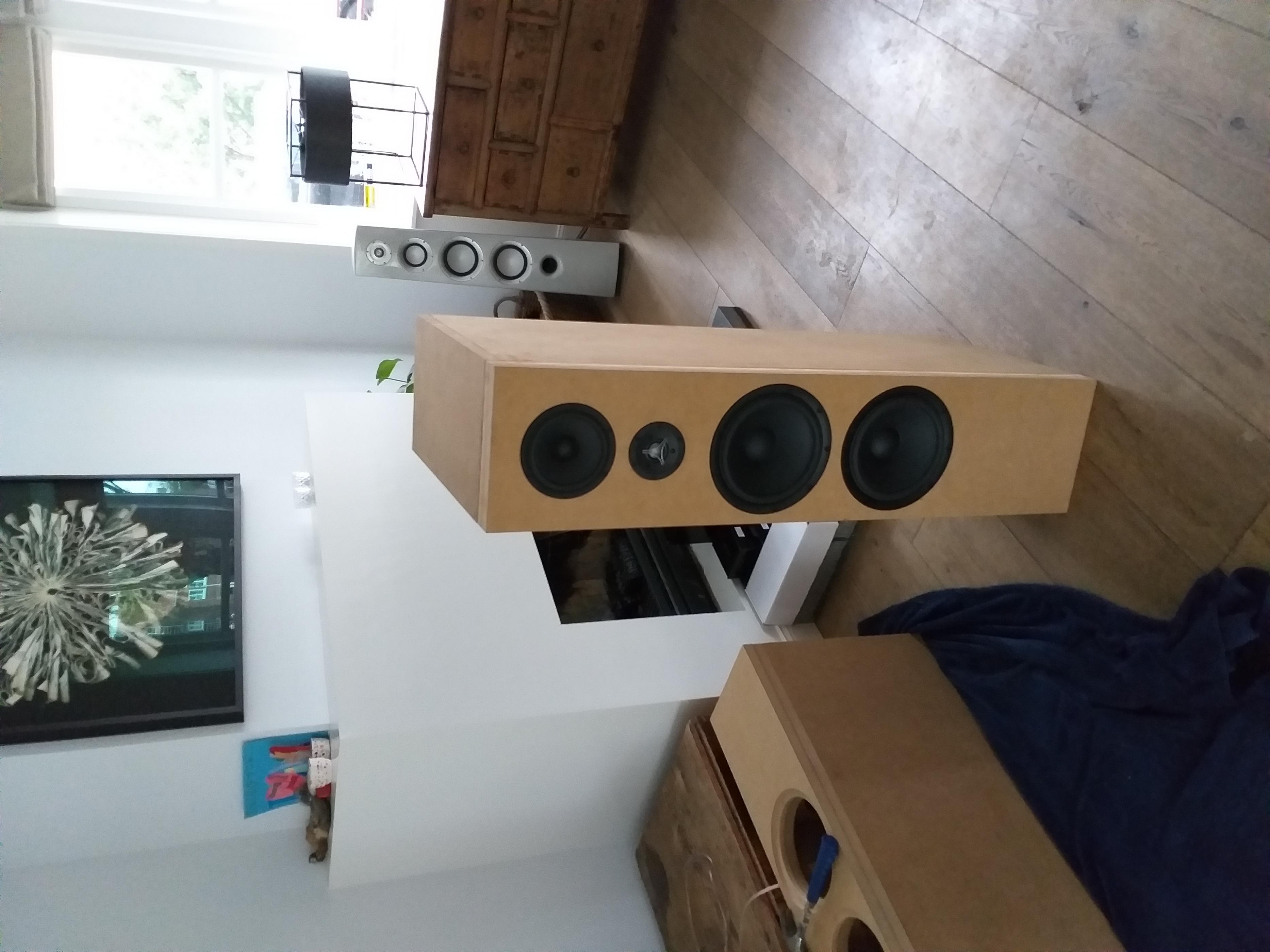

3wayaddict,
Congratulations, looks like you went for a well thought out build, and the end results are really good! What finish are you planning for the cabinets? Beware, if you like 'em too much, you might end up listening to them as they are and they will remain in raw MDF. 😀
If you don't mind me asking, what genres of music did you try them out with?
To really test the raw quality (so that's clarity, transparency, detail etc.) I often listen to a live recording of Anouk - "It Wasn't Me" (Live From Oosterpoort), a live recording of Eagles - "Hotel California" (Hell Freezes Over), Pepe Romero - "Farrucas", Stevie Ray Vaughan - "Tin Pan Alley", Tears For Fears - "Bad Man's Song" and I think The Handsome Family - Singing Bones is also a great album for sound quality. Many of the songs are also often played during demonstrations at Chattelin.
I really like a number of the songs above to listen to normally as well but normally I mostly listen to rock, alternative in particular. Like Pink Floyd, Supertramp, Genesis and obviously many more (my playlist is over 1500 songs). So to really test if the speakers are emotionally grabbing me, and to see what kind of punch they pack during loud playback of loud, complicated songs, I often play some of that, even though most of it isn't recorded too well, unfortunately.
3way , aren’t you a little bit too young for this? Go and chase some girls, you’ll have time for this later, great job btw!

Good to hear that the speaker will get some demanding music and not only Diana Krall. 😀
That's a problem with rock music, a lot of it is not that well recorded (though the music is fantastic).
Have fun listening and only request/advice is that don't play too loud, as you need to be careful about hearing damage. It's easy to crank up good systems, specially when you're young! 🙂

I tthink it's a good thing I have found my passion at my age. Now I know what I want to do later.
My hearing something I'm very careful with. I definitely don't want to miss the sounds my years have yet to bring! Thanks for the advice.
I think I'm gonna make them mat white, like Kroma Audio. I just love the look of those.
Looked up Kroma Audio and their speakers look nice. Look forward to more pics as you progress on your journey to get these finished.

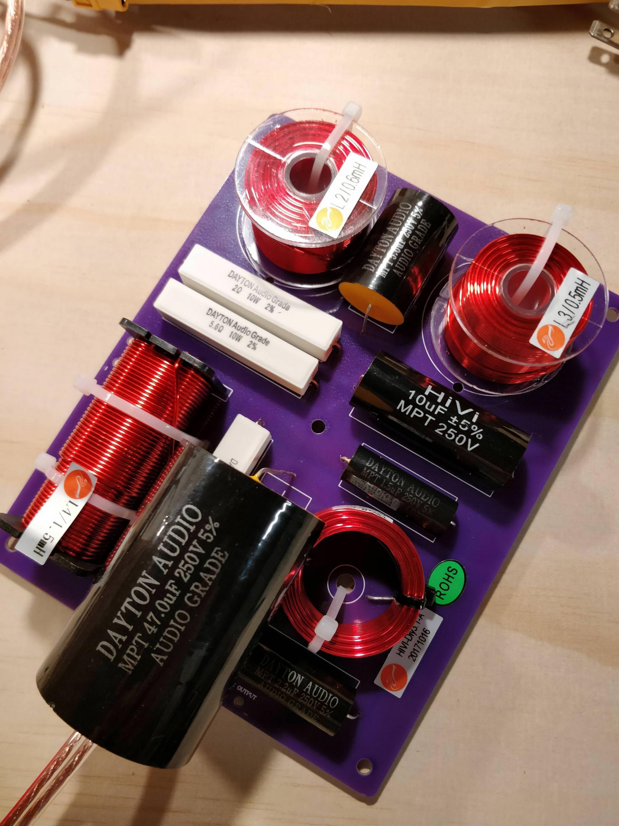

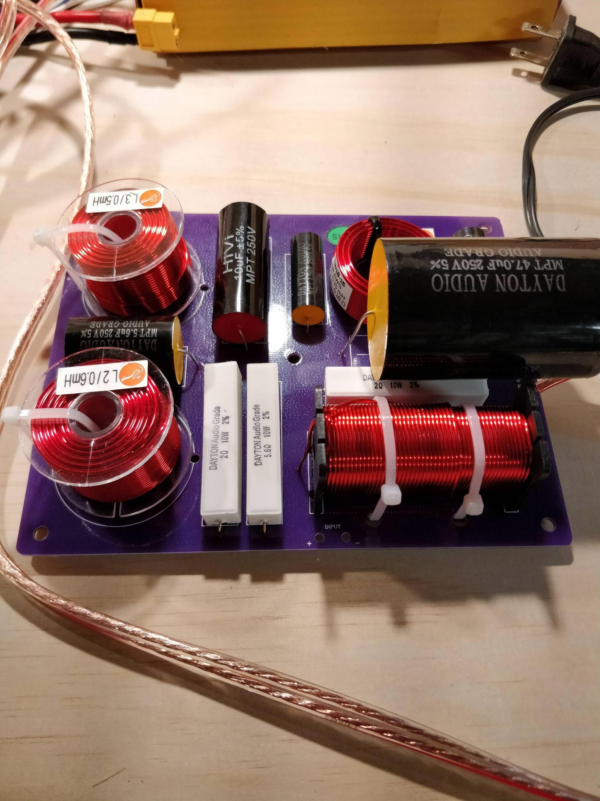

I've upgraded the crossovers on my Swan 3.1 speakers and in the process, replaced the 47uf electrolytic with a poly equivalent. Are there any concerns with the proximity of the large capacitor and the 2R resistor underneath? It's not touching and I don't think I can move the capacitor any further away.
