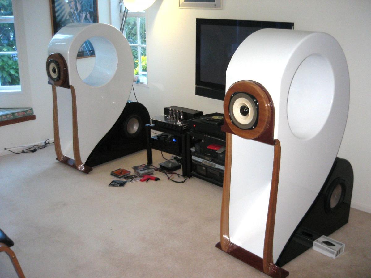

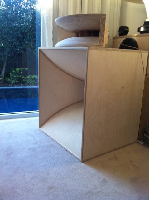

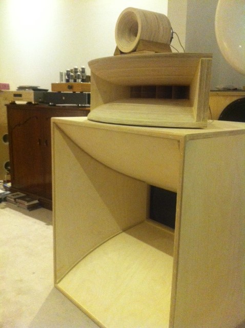

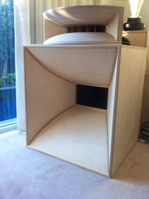

Trio horn using 416 Altec 15 inch bass, Yuichi 290Hz mid horn with Be Radian 2-inch driver, and wood turned tweeter horn with 1-inch Radian driver.
Bass is massive 120Kg each...Euro birch ply.
103dB efficiency.
CAD CNC construction.
Andrew

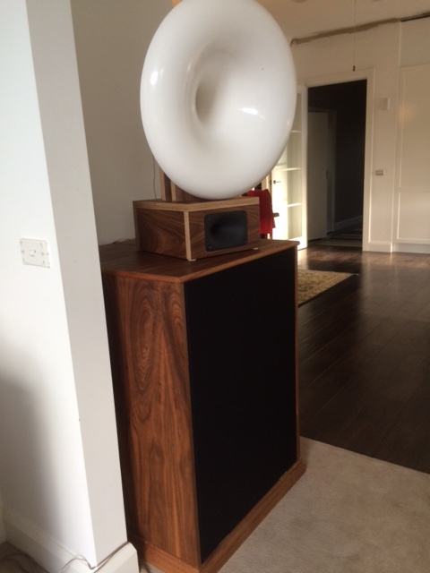

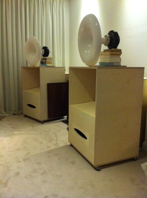

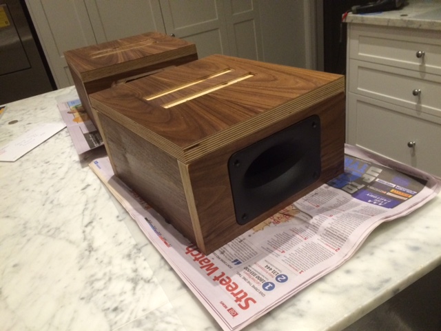

This is my current system, consisting 340Hz Azura lacleach horn with Faital Pro HF200 driver, Faital Pro tweeter horn and one inch Faital driver. Mid bass is Eminence 12 inch Kappalite in Birch ply sealed cab. Bass is EV 18 inch in mega heavy sealed 200 liter cab.
Outer cab is American Walnut, with walnut CNC'd horn stand.
Mini DSP for xover, with Holton Precision Audio six channel amp.
Moving to passive xover for the horns, retaining MiniDSP for bass.
After years of building systems for Tannoy, ALtec, Lowther etc...this is a real enjoyable system...a keeper.
Andrew

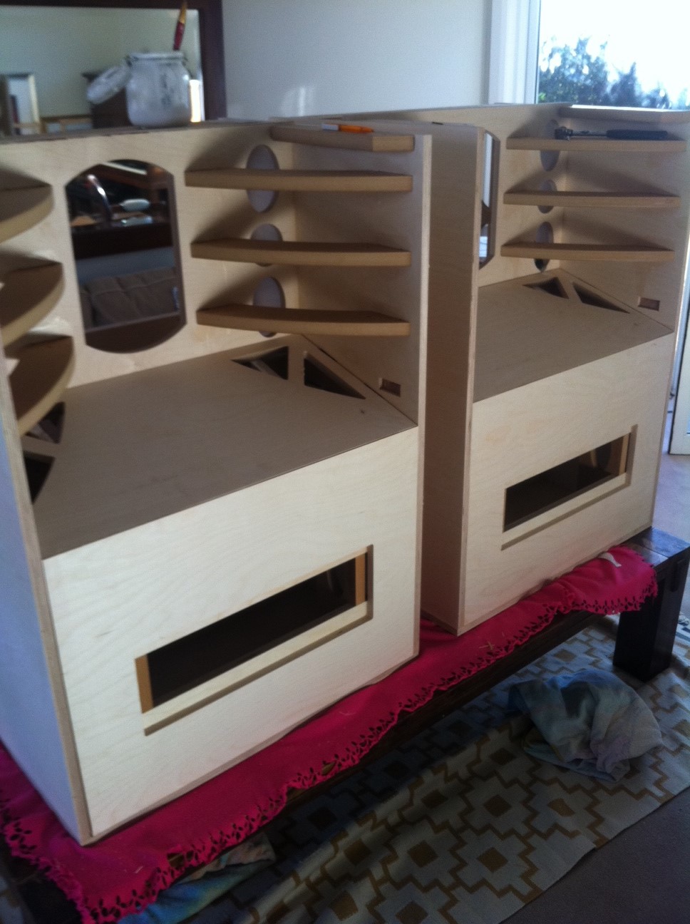

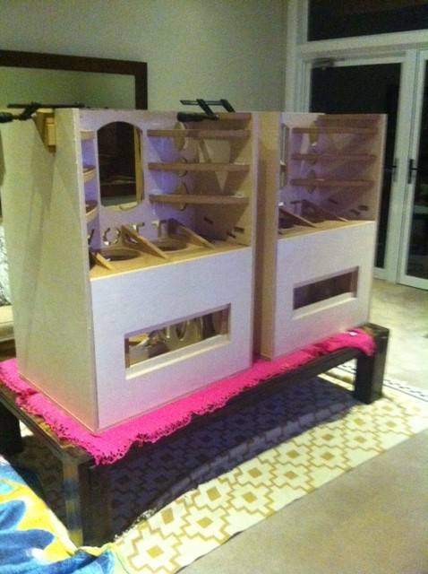

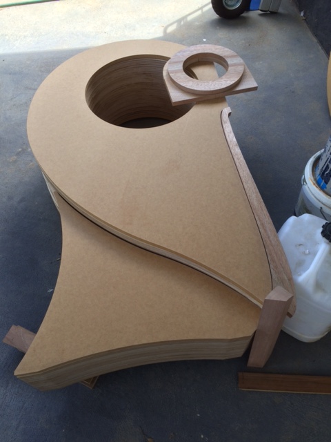

This is a CAD CNC approach I used for the famous ALtec VOTT A7, using birch ply.
Top horn is Jabo 300Hz with Altec 288C two inch compression driver.

Andrew....
Very nice looking projects. Congrats for that.
I have a question.....

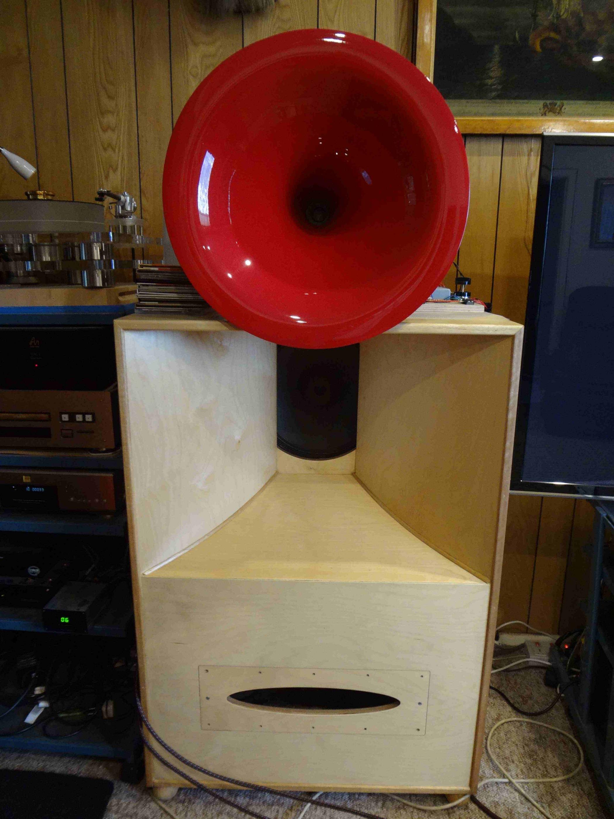

Original Yuichi 290 have curbed laterals.
Yours are straight.....or at least don't see curved sides on the pics.
Did you have some measurements to compare the differences?....
Thanks.
Thanks. I haven't built the curved side model...as Yuichi have another model with straight sides...so I thought I'd blend the two models into one.
