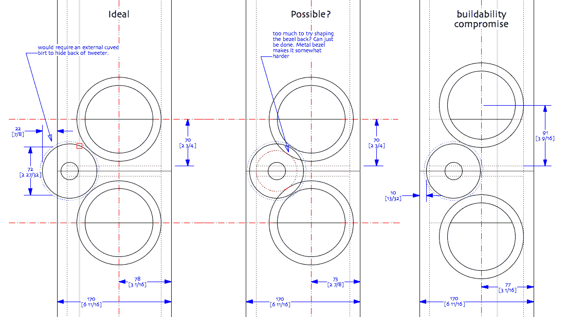

With the LD25X we compromised the optimal Zd of the VWR,
These were the options (the 3rd was our choice) -- LD22 has a 7mm smaller diameter, allowing for less compromise:

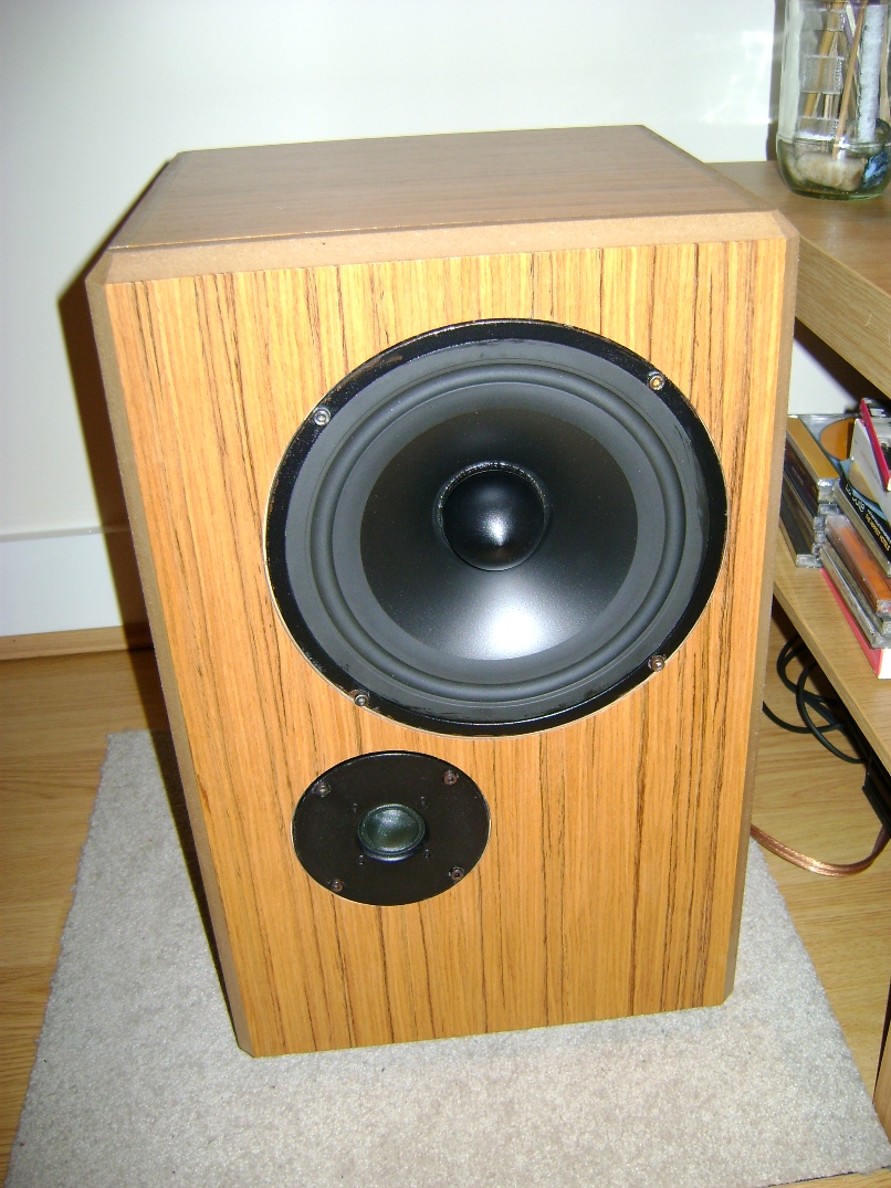

Here are my daily users which i built and then rebuilt a while ago. They are shown to be standing on the floor but they are of course supposed to be bookshelf or stand mounted.
It's a cygnet mk2 kit which I got from madisound.
I wasn't satisfied with the original kit due to "cardboard tapping" like sound 😡 , which is why I have opted for a 2nd order XO and different XO frequency, and opted for a round port at the back instead of the crazy square port on the original.
Huge improvement over the madisound series XO and enclosure, even if i do say so myself.
Original thread link:
http://www.diyaudio.com/forums/multi-way/150218-mtm-design.html
Picture of the finished article:
http://www.diyaudio.com/forums/multi-way/150218-mtm-design-6.html#post2211134
Summary of mods:
http://www.diyaudio.com/forums/multi-way/150218-mtm-design-7.html#post2211864
Summary of mods:
dave
Cant you cut the flange of the tweeter just a little where the overlap happens? or for that matter inset the tweeter's flange behind the woofer's basket?
Option 2.
dave

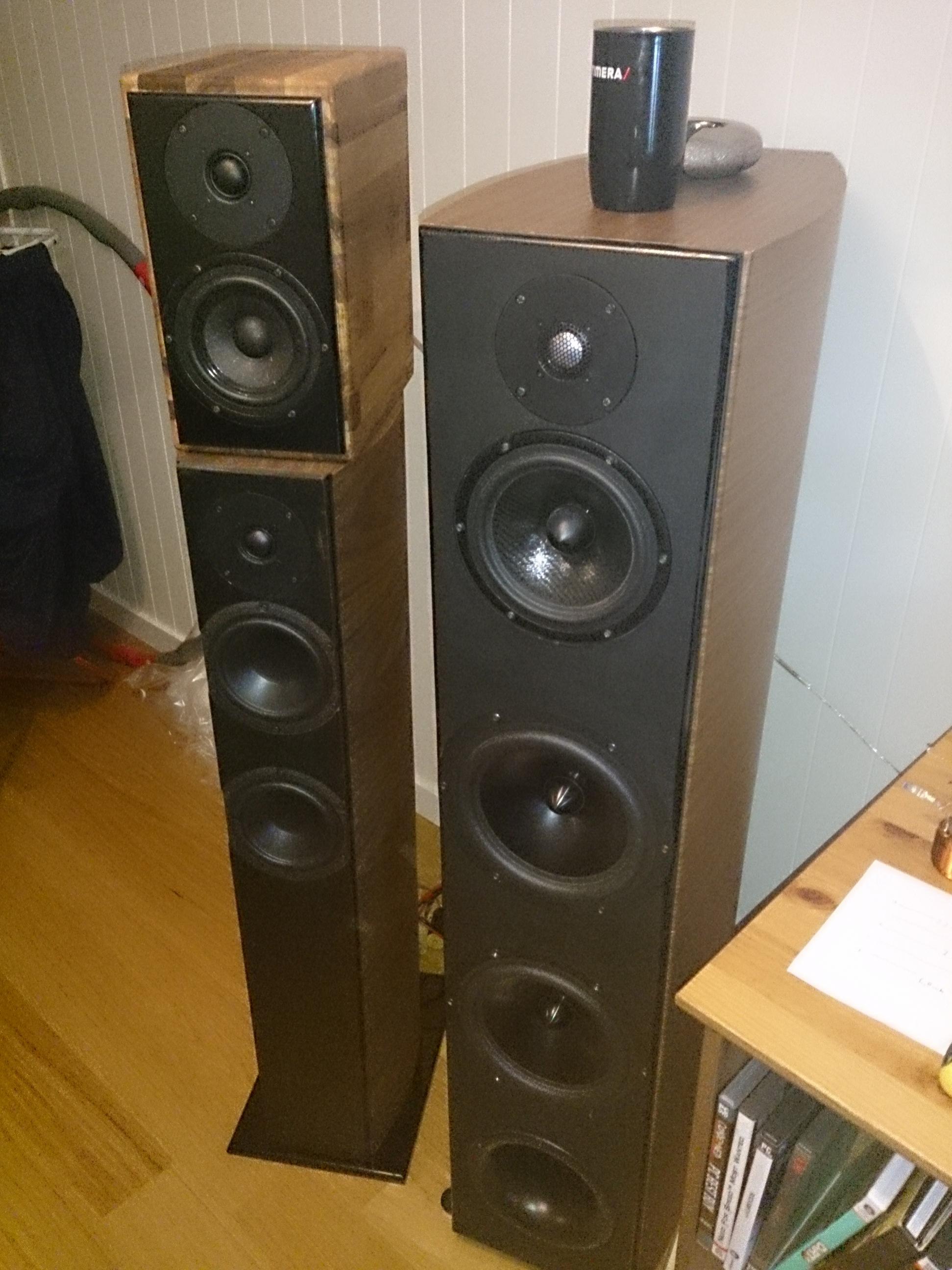

Looks great !Hello here is my 3 pair of speakers iv built over the last 2 1/2 years. All walnut, mdf inside. The big ones 38 kilos of weight.
What speakers did you use ? and filters ? any measurements ? How do they sound ? How did you construct the roundings in the back of the tall ones one the right ?
Cheers ,
Rens
Hi , thanks i put alot of work in the design. For the big ones on the right i use seas 27TBC/G, seas u18rnx and two dayton rs225. They have Linkwitz Riley 2. order.
Bass: +-- 4,7mh-------------+
-------------------|125uf --- -
Mid: 1,8mh--------100uf----------+
---------------| 6,8uf ---|6,8mh-- -
Tweeter: +-- 4,7mh------------- 2 ohm ------------- +
---------------------| 0,55mh-----------| 10 ohm --- -
Im very satisfied with how they sound. I dont have measument equipment, so took quite a wile to test different combinations, the clarity overall sound is impressive, deep powerfull bass. For making the round sides i used 5 layers of 3mm pine/mdf , bent over a "skeleton" of mdf, 6 liters was used in the prosess.
The mid have ofcourse its own chamber of ca. 6 liters.

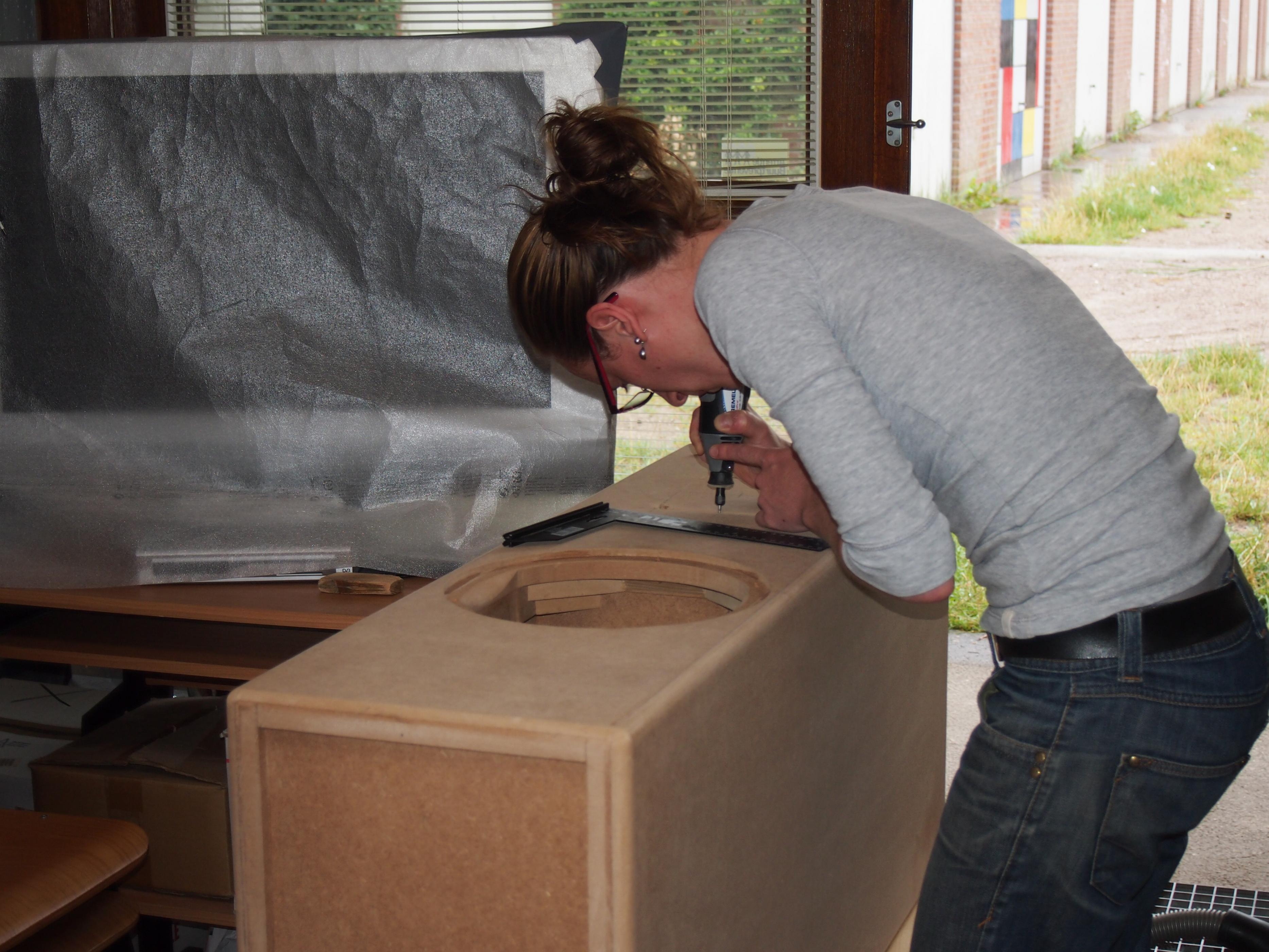

We build these a couple months ago for my daughter.
At the right side you can see the 2e hand Eidolons ; we have been testing several units till we had , for our ears , a superior sound.
Took us about 14 months to come to the right choices.
And 4tweeters , 6midranges , 4woofers.!!
We used a dbx driverack and aleph pass for getting the x-over points.
The x-over now is aircore , mundorf ; so passive for the final sound tweak etc.
About 59kg each .
She is going to paint them herself with "pictures" on the sides ; has her own ideas about design.
About 59kg each .
