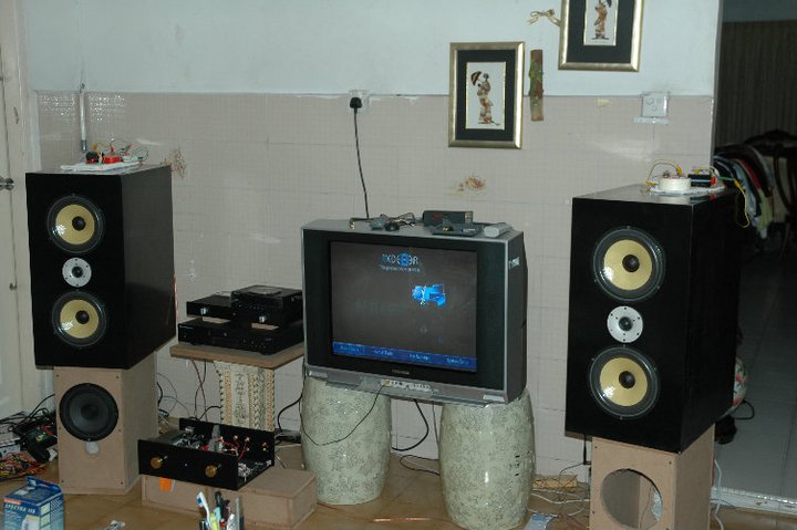

not that i have anything against tarkuses, i even modeled one once.
After a long slog (i do too many projects at once)
Its a pair of tri-amped speakers. used on my front channels(and stereo of course)
i call them "manticore" because i made tarkus before and spent tons messing with the crossover. if you look on the album cover art of "tarkus", manticore kills the tarkus.
tweeter: SEAS 27TDFC with 75uf film capacitor for safety (in case i make a mistake programming)
mid/bass: SEAS ER18RNX
woofer: CSS SDX10
tweeters and mid/bass powered by emotiva upa-500
woofers powered by emotiva upa-200
miniDSP 4x10(2x8 plugin)
the cabinet front is not finished but this is about the speakers. Im using a laptop to program the DSP with, while i make some changes to (this thing) http://imgur.com/a/R5PSO
yeah the phone us usually in the kitchen but i just got a different internet connection and had to get it out of the way.
I am really happy with this. it sounds fantastic, very clear, goes down as low as i can hear very nice sound stage, and lots of audiophool adjectives! and i can make any changes i like without buying new crossover bits.
other people have asked me if the emotivas should be stacked. here they are after being on with the TV on for a few hours and then loud music for a couple of hours.
not bad at all 28.4c is the hottest thing on the picture, and i still haven't put feet on the miniDSP to get it off the vents of the top emotiva.
a cool trick, if you do something like this, and keep your old center and rear channel powered by a reciever, is to adjust the PEQ on the midrange to be wrong in a similar way to your old speakers, and use that miniDSP preset when watching things with surround. it makes the miniDSP powered speakers sound close enough to the old ones that there is no strangeness.

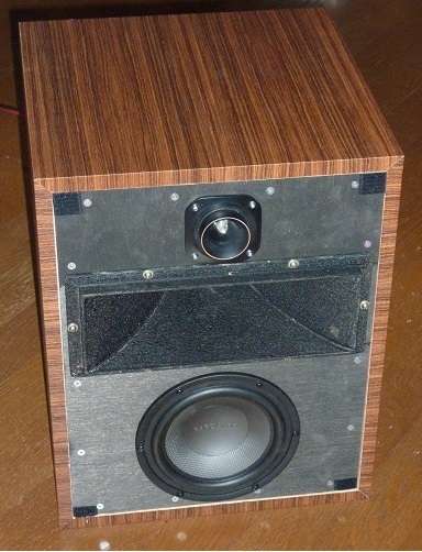

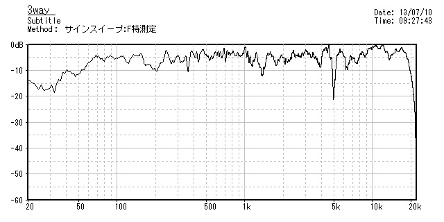

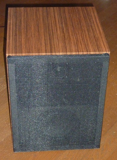

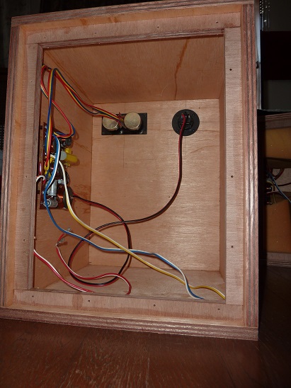

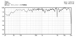

I made a speaker system 3-way system.
The size is width 340mm, depth 340mm, 400mm height, 35 liters of sealed. Thickness 15mm. 15Kg weight.
Speaker units is ParcAudio DCU-171PP (~ 650Hz), Onkyo HM500A-MK2 (650Hz ~ 8KHz), Technics 5HH10 (8KHz ~).
Network has modified those of Coral CX-77.
Super bass can not be played, however, sound a powerful and delicate is obtained, I am very satisfied.

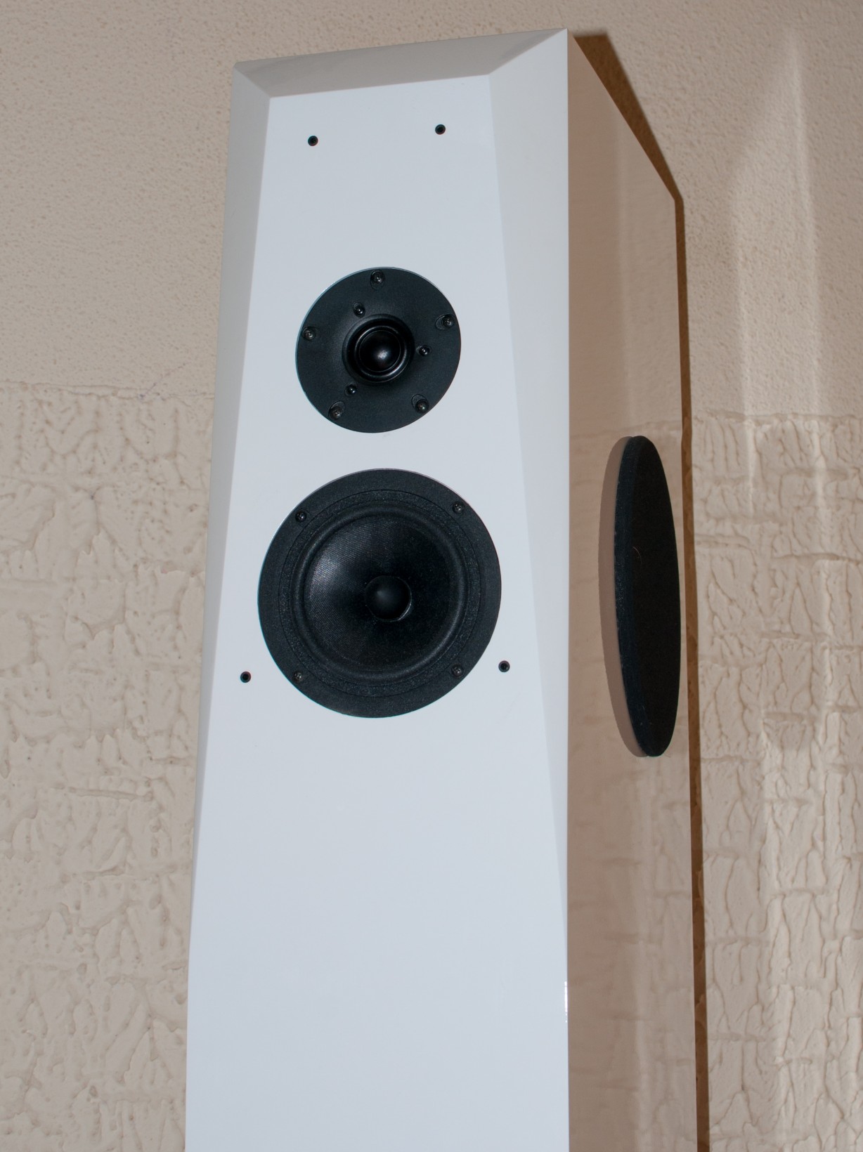

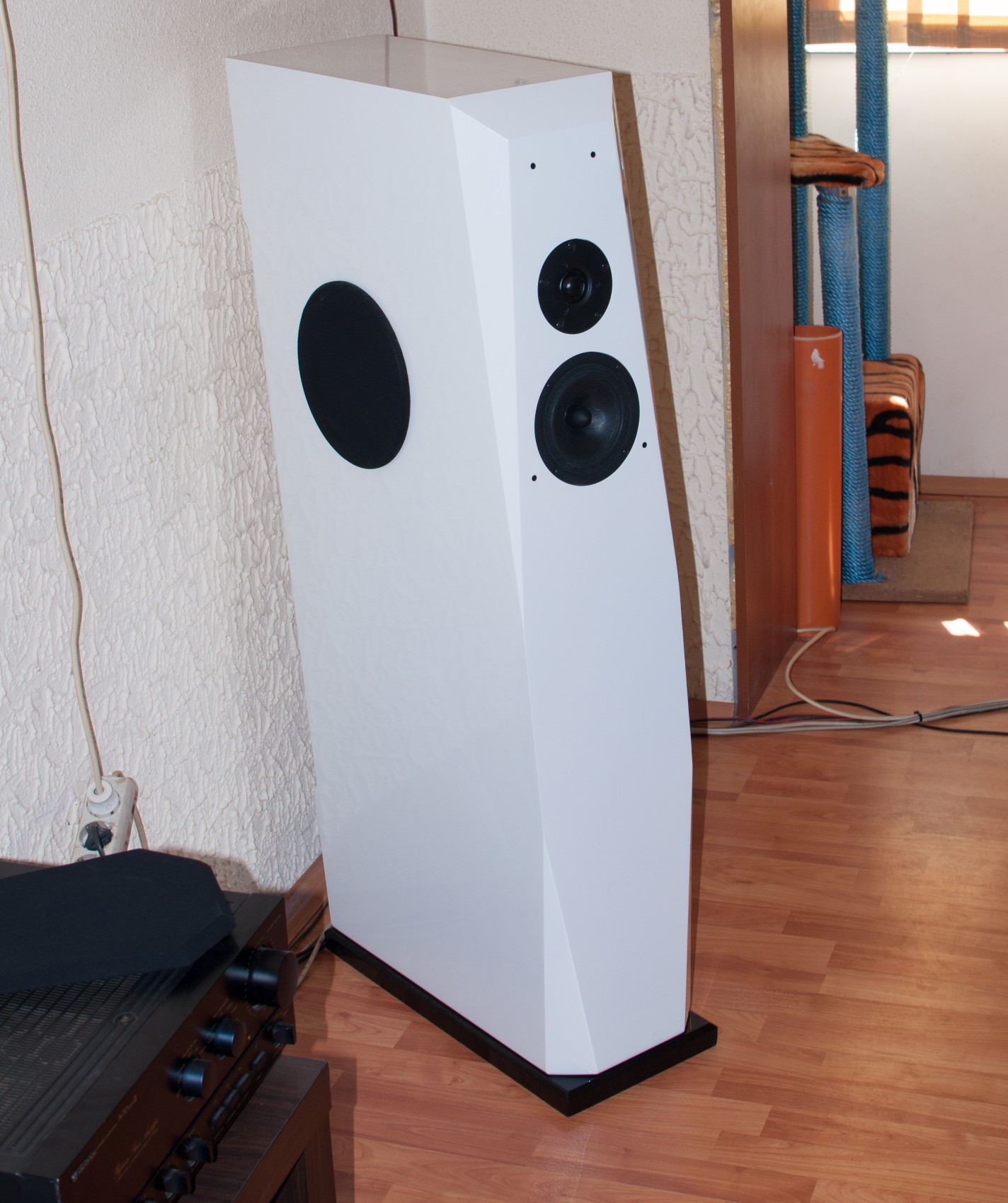

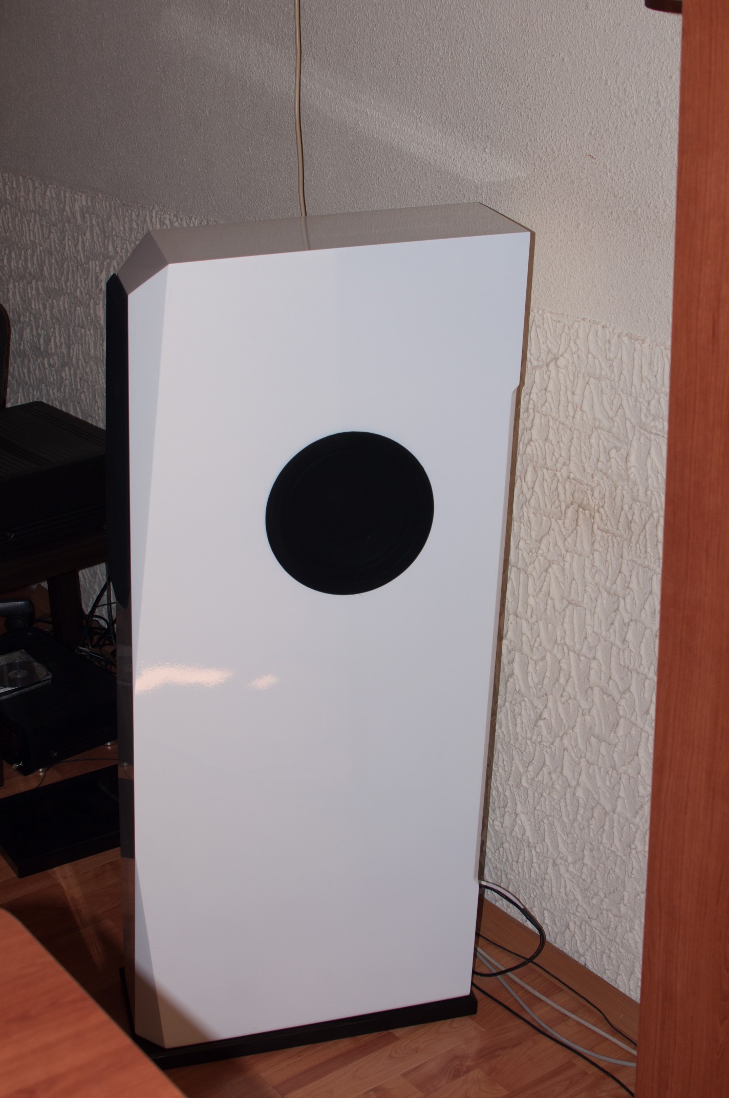

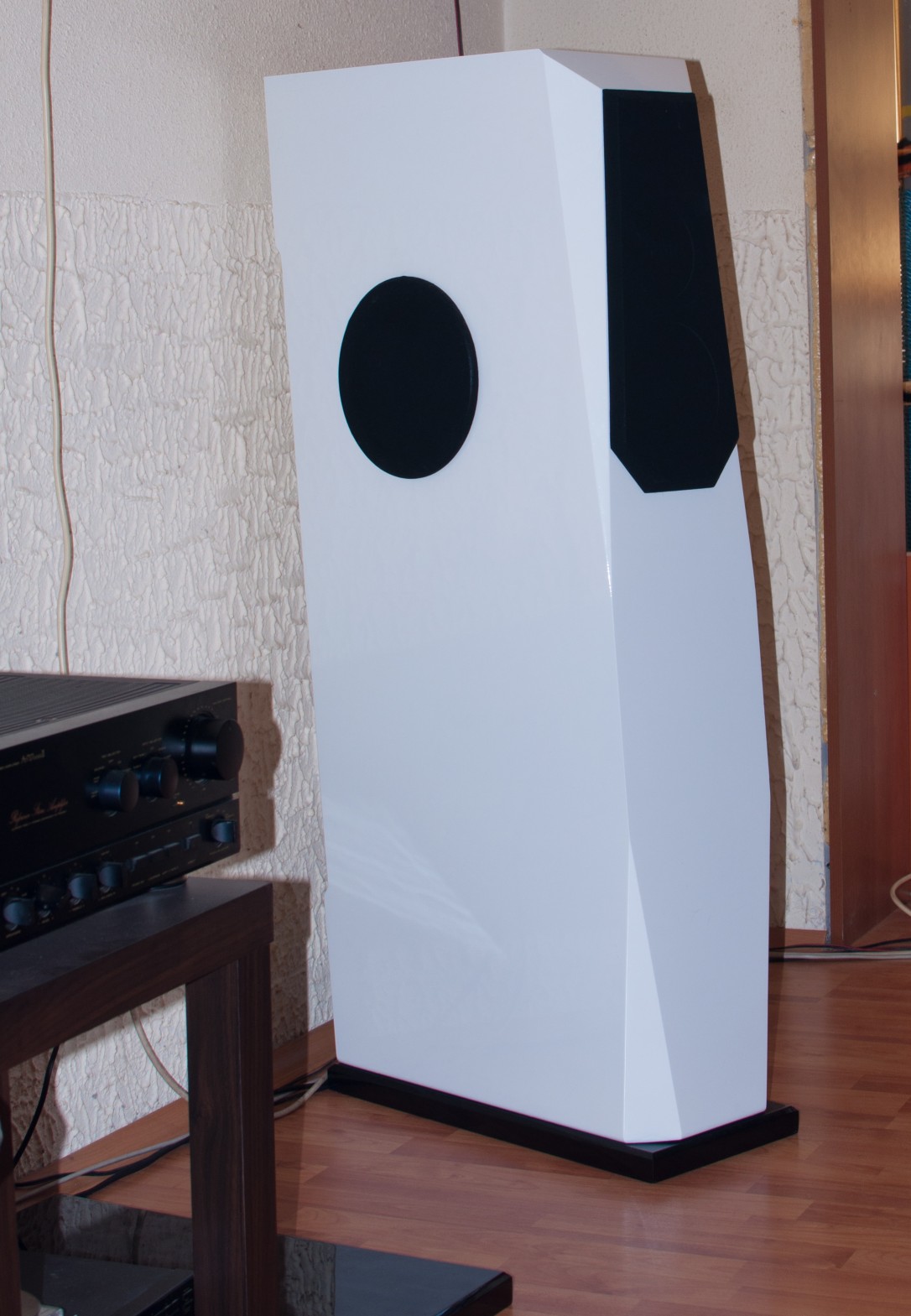

Just finished my first build: bass 2xBeyma 8BR40N sideways push-push configuration (inspired by Kef Blade), mid ScanSpeak 15M-4624G00, high Vifa DX25TG09-04.
I'ts a project inspired just by reading forums and google searching, not asking a single question from annybody...wanted to see what i can do using my head and putting together the info found over the net...
Happy with the sound, but i know i can do better 🙂
Congratulations! Looks like a well considered design overall and well executed. I'm keen to try that mid out, specs look fantastic, are you enjoying it? Where have you crossed over? I think it needs about 300Hz so I wonder how well it integrates with the side mounted woofers.
