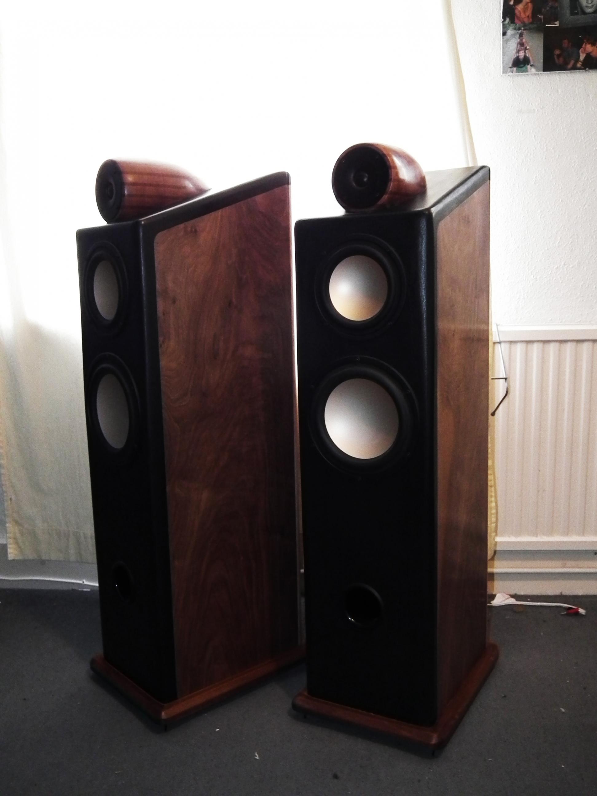

Hey guys,
Love all these designs on here, this forum has been a great source of information in regards to speaker design and creation.
I've played around with speakers a little over the years but nothing too serious, but recently I had a go at creating a set of 3-way speakers that fit my room a little better than the polk audio tsi-500's I had brought when I was flatting in a much larger room.
The project has to be one of the hardest things I have made, mainly because the lack of tools and some of the cuts I wanted to do.
Now as much as I studied do's and dont's on here I believe there are probably a few things people on here will scream at but I had the design nestled in my head and me being more of an artist chose looks over functionality, tho in saying this I am extremely happy with the sound out of these.
All the drivers are cheap random brands such as response and skytronics, proper drivers seem to be marked up a fair bit here in NZ so I couldn't afford the high end drivers seen on here but they do the job fine.
So it's a 3-way system with a passive crossover at 1200 and 5400, the bass driver is a response 8inch paper woofer which is in a 44L ported enclosure with the port firing down. The midrange is a 5.25inch sealed midrange, hence I have not made and enclosure for them and the tweeter is a 1inch titanium dome tweeter(also response).
They are really a lovely pair of speakers! Kudos to you. I can imagine they sound very open and airy.
When you save your coin up a bit, I would change the jaycar electrolytic caps in the crossover to some nice metal film caps, and the inductors to copper foil. It really makes a big difference.
Apart from that you have done a superb job on them.
How did you make the waveguide for the tweeter with limited tools?
First I cut a 1" hole with a hole saw drill bit, then drew a larger hole in which I began to slowly chisel out to making sure not to chisel out the inner diameter, then just lots of sanding, its not perfect but looks good from a distance and in the right lighting.
The bass driver hole I managed to do with a jigsaw on a 45degree angle, and lots of patients.

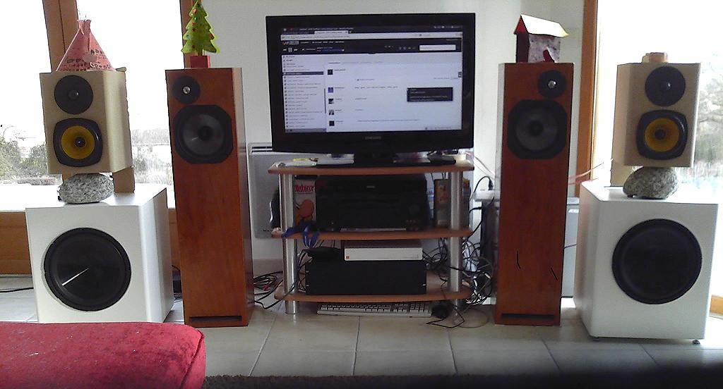

3 way using french loudspeaker
A short description of my system (almost finished) using french brands of loudspeaker 🙂 : Bass is Atohm D300P04, medium is Davis 16GKLV6M, Tweeter is Audax TW034. Passive crossover with 16GKLV6M/TW034 and active crossover between D300P04 and 16GKLV6M/TW034 via a miniDSP 2x4. Bass is powered with two Hypex 2.0 modules and the medium-tweeter section with a Poppulse T150.
This is my firts multi-amp system and also my first three way system ! What a big sound with all this, "live sound" at home :cheers:
