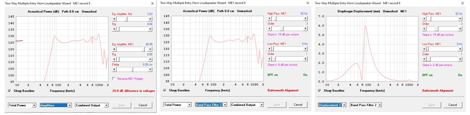

If you are willing to be less strict on the design requirements 2 and 9 stated in the OP there might be a way to get an extra few dB's without spending big bucks. Let me explain with a horn resp simulation exercise. I don't think all numbers are exactly correct, however, they give some insight in the question of ab01ns.
Here a simulation of parallel B&C 10CL51 8 Ohm - driven to peak power with (600W) 49 volts with a 93Hz HPF 3rd order BW. Gives a theoretical peak output of 126 db in 2pi space.

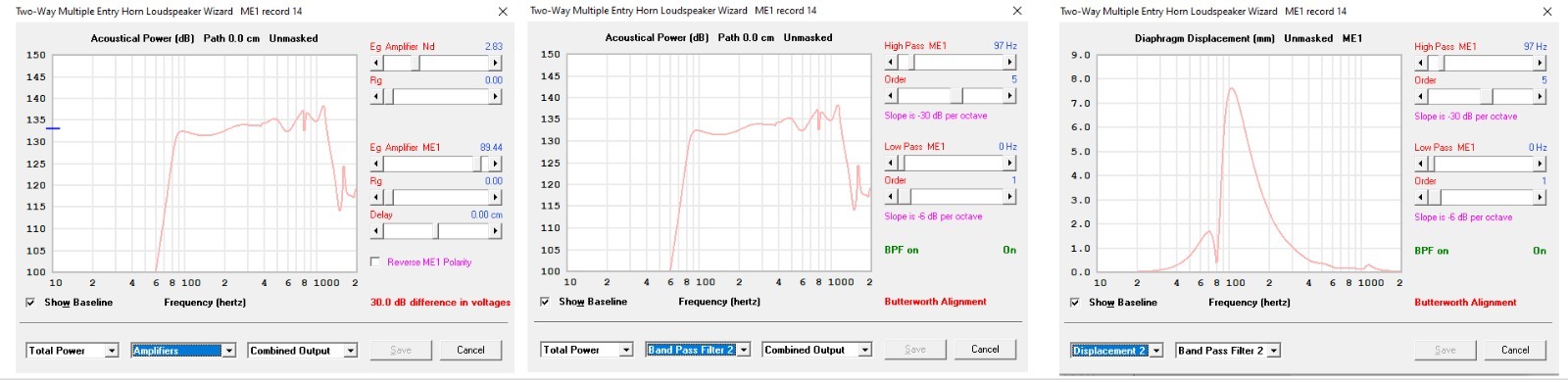

Here a simulation of parallel FAITAL 10FH500 8 Ohm - driven to peak power with (1000W) 89.9 v with 100Hz HPF 3rd order BW. Gives a theoretical peak output of 133 db in 2pi space.

Proposition: the higher you set the HPF filter, the less displacement will occur. According to hornresp at 100Hz HPF 3rd order BW the output will be now be thermal limited instead of excursion limited. An slightly higher HPF 3rd order BW could keep Vtc low enough to let you mids play high enough to meet the compression driver. Of course, you need to have a subwoofer that can comfortable play above 100 Hz.

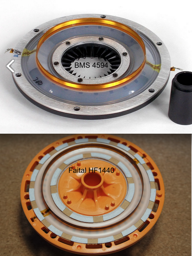

In addition to that, to leave some margin for error in the Vtc, you could combine it with a 1.4" CD Faital HF1440 with a 3.4" voice coil diameter. That would give you more output at lower frequencies due to the larger voice coil, and the HF1440 is of a ring radiotor type, mitigating the dome - phase plug excursion limit like the CDX14-3050.

Speetpeet,
49v would be 600 watts into a nominal 4 ohm load (300 watts per driver), 89.9v would be 2020 watts into a nominal 4 ohm load (1010 watts per driver). Assuming the 10FH500 can handle over three times the power (another cost..)of the 10CL51 without more power compression, the 5dB increase (133 dB peak) looks possible. That said, the SynTripP 10" HF response starts to dive at 800Hz, while the simulation shows around 1200Hz, 2/3 octave higher than measured. An acoustic crossover in the 800Hz range is required.
The Faital HF1440 annular diaphragm outer diameter is 100mm, inner diameter 72mm, for an Sd of around 37.82cm^2, while a 75mm dome diaphragm has around 44.18cm^2. The annular diaphragm is pinned on the inner and outer points, so if the center has double the excursion of a dome (0.8 or 1mm compared to 0.5mm), it's overall displacement would still be less than a 3" dome.
Mark100's tests with the BMS 4594 (see posts around 1007) indicate it's diaphragm "clanked" (sound of diaphragm hitting phase plug) at 123dB at 500 Hz. I'd estimate the BMS 4594 annular diaphragm (excursion of max. +/-0.8 mm) to be near 70cm^2, almost double the Faital HF1440 displacement.
Could the BMS 4594 do +10dB at 800 Hz compared to 500Hz? Maybe.
Could a driver with half the displacement? Test it and see!
Anyway, 95 euros may not be "too steep", but the cost of destroying HF drivers trying to "keep up" may be ;) .
