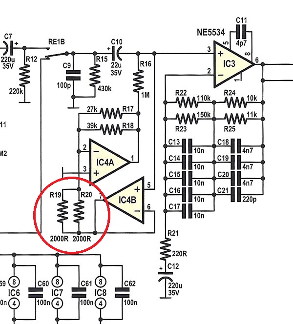

I mis-read the schematic from the Elektor article -- R19||R20 is 2k||2K not 200||200, so the gain was too, too high.

Jan,
I have the complete article but it is not about audio, it is about extending an opamp's capabilities. The second page of the article is attached and the article is all about using the circuit of figure 3. Using this in the Hoeffelman-Meyes preamp circuit (see reference 7 of the article) was just an example. If you want the entire article tell me where to email it.
