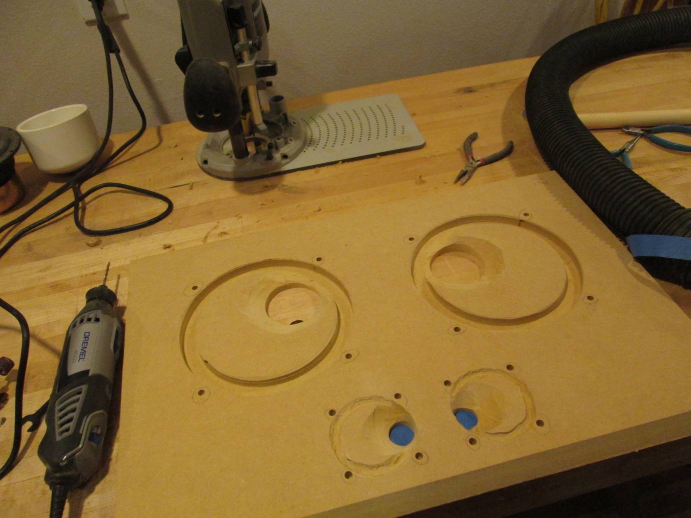

Perhaps a loose connection 😱. Anyway, adding the frustrums didn't bring much high end extension of the mids.
Try being even more aggressive with those frustrums...or putting slightly larger holes in place.
This is what I ended up with on mine...and I have 3" mids with .875" ports. I cut them back until there was about 1/8" of material at the exit. I had to make them asymmetrical to get the mids to fit...

I tried that...but I ended up finding it easier to just keep modifying a test horn until it was unusable and then....build it again.
It got to the point where I had them filled and re-drilled enough with putty I was putting putty on putty hoping it would stick.

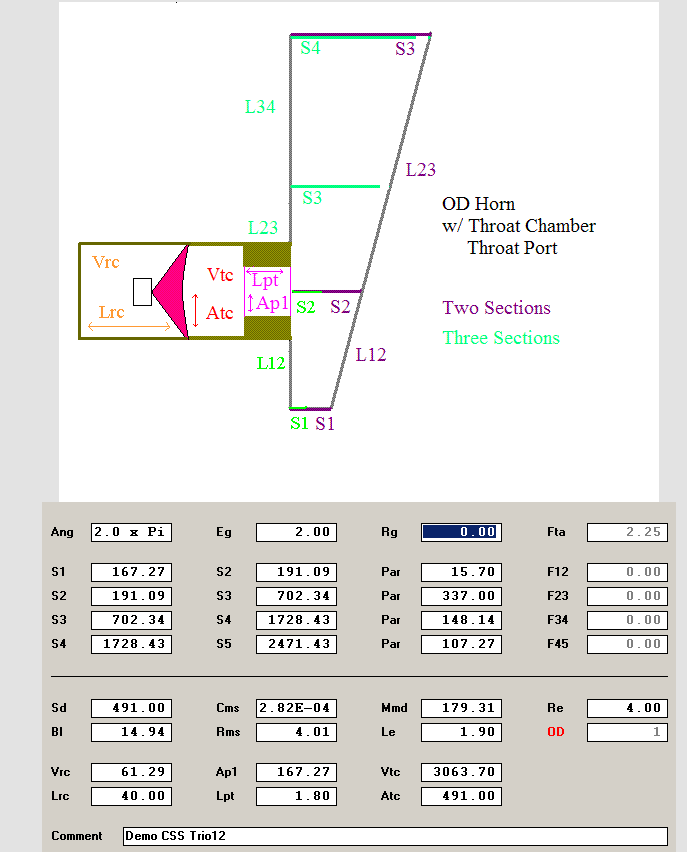

How do you determine the size of the ports for the mids? Ive simmed a horn and just copied your specs but dont really understand how to optimise them for my mids.
The relationship of enclosed space in front of the driver to port dimension and port depth create an acoustical bandpass.How do you determine the size of the ports for the mids? Ive simmed a horn and just copied your specs but dont really understand how to optimise them for my mids.
If the port is too large, the driver will roll off at a lower frequency than may be desired, too small, and the driver has a large upper peak followed by a steep drop off and more peaks.
Hornresp will show you the basic response when changing the relationships between enclosed space in front of the driver to port dimension and port depth, but does not consider driver breakup in the upper end of the response, experimentation must be done to determine the actual response.
Thanks weltersys. That part I understand, what Im missing is which tabs in hornresp are responsible for those changes?
Maybe this will help:Thanks weltersys. That part I understand, what Im missing is which tabs in hornresp are responsible for those changes?
Hornresp for Dum... hmm... Everyone 😉 - Home Theater Forum and Systems - HomeTheaterShack.com
Vrc (volume of Rear Chamber), Lrc (length rc), Vtc (volume Throat Chamber, the enclosed space in front of the driver), Atc (area tc), Lpt (Length of Port), Ap (Area of Port) and S2 placement all affect the response as I described.Thanks weltersys. That part I understand, what Im missing is which tabs in hornresp are responsible for those changes?
In a real offset horn, the Vtc and Lpt/Ap may be combined in a single conical chamber, and results need to be worked out empirically.
