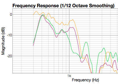

I posted some graphs earlier in this thread showing my experience with the M10 mids. It appears to me that you are suffering the same fate. Since those posts, I have milled out the entrance hole in my "test horn" to something oblong and around .75"x.875" with some tapering behind the hole as well (frustum). Below is a graph of the difference between the stock M10 and my "screen door" version (with the Misco 5" as a reference) with this larger hole. Since you are committed to this driver (based on the creative way you designed your horn) you may want to experiment with the drivers. Instead of pasting on a mesh I'm curious about gluing some kind of ridges to the cone. Perhaps toothpicks? If you play with the cone you can see that it flexes very easily around the outer edge where the slope of the cone becomes almost non-existent. This is the part that I believe needs reinforcing.
The gold color is the Misco 5", the Green is the stock M10 and the purple is the screen door M10.
Still the mids don't go as high as I'd like them to. I'm not sure what exactly is prohibiting them from going up to 1Khz 🙁.

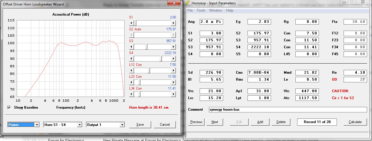

I am however not ready for what concerns the woofers who can go to 1.2 khz but then I need to keep VTC small, how to do that without trouble the port (not longer peaks!).
So fill up the cone space is not so easy I need a faseplug like thing who only fill not disturb. Speakers has 0.448 liters room in cone, and this x 2 because I use two speakers and hornresp do not acount for that.
