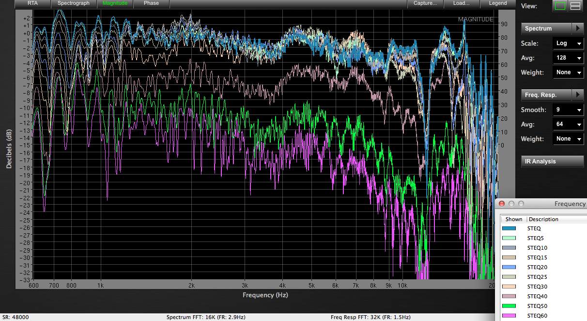

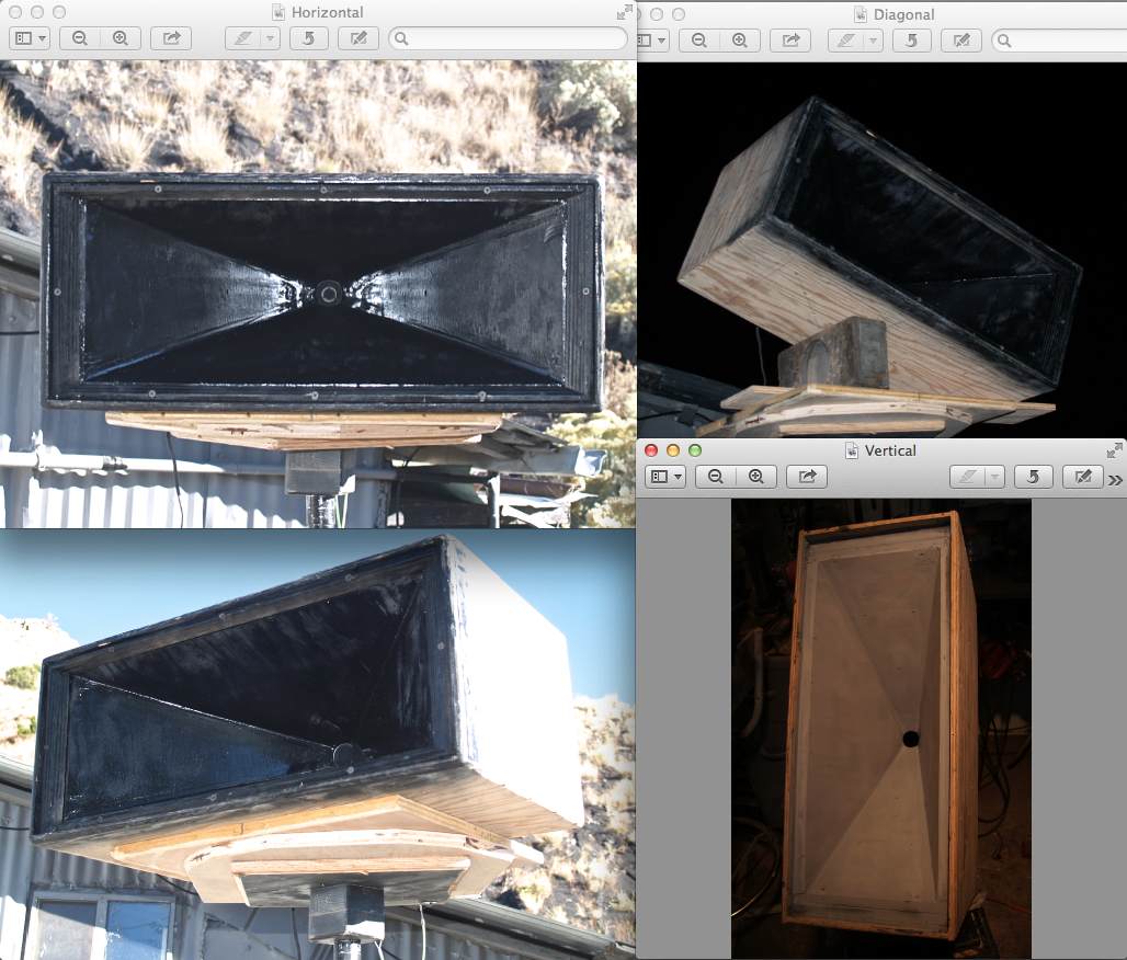

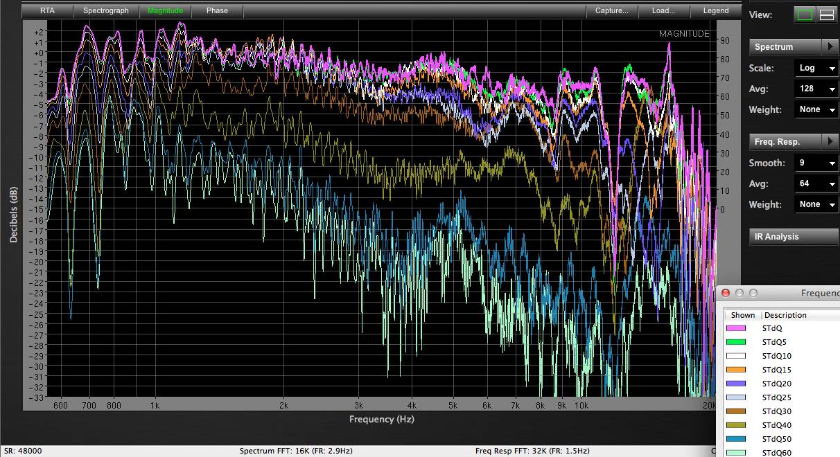

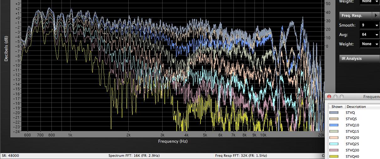

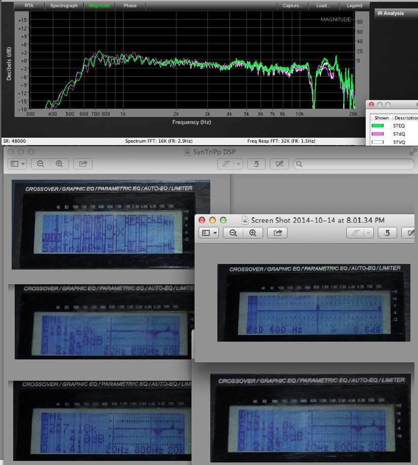

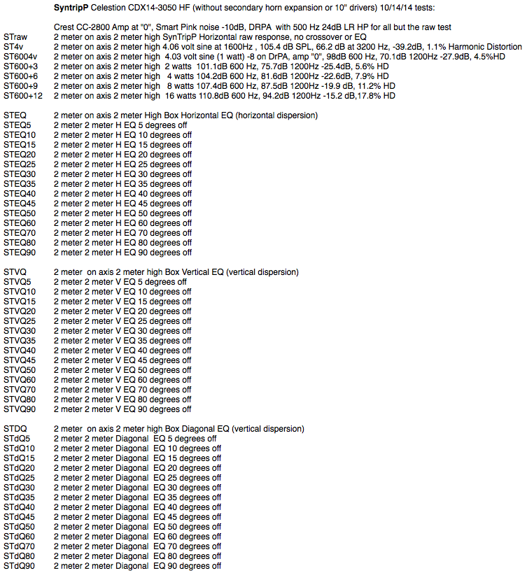

X,I am not suggesting you change your build at all, more a question of whether or not the design has enough room physically to accommodate a Hughes throat piece and the standard drivers as you designed for 5.25in injection point.
As designed and built the cabinet could not accommodate a Hughes style throat, as it would move the injection point about 1" further from the HF driver, and the driver would be located .75" further back, and emerge from the back cover.
As built, I am quite pleased with the response thus far..

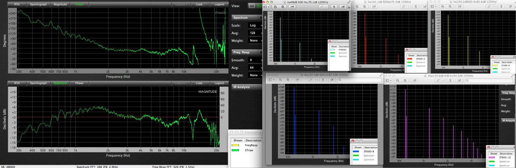

The SynTripP is designed as a two-part horn, the second portion was not attached in the following tests, and the woofer's ports have not been cut in the horn yet, so comparisons of the various stages of development can be made. Testing was done outdoors with the bottom of the enclosure a bit over two meters off the ground, test mic at two meters from the horn mouth, using Smaart with the FFT set to 32K, providing a resolution of 1.5 Hz. The magnitude response graphs below show a lot more "grass" (peak and dip detail) than the highly smoothed "marketing graphs" we usually see.
An example of how smooth the graphs can be made to look is in post #6 here:
http://www.diyaudio.com/forums/multi-way/236037-dirty-dozen-line-array.html
The SynTripP HF horn driven with the 16 ohm Celestion CDX14-3050 has a very extended response, +/-6 dB from 460 Hz to 17,000 Hz. Like most 3" diaphragm drivers, the CDX14-3050 has some "rough spots" in the VHF response, in this case a deep dip at 12,000 Hz, followed by a small peak at 13,680 Hz. Although the 12,000 Hz dip is probably not completely correctable with EQ, it is preferable to the sharp breakup peaks many other large diaphragm drivers have in that range, which even after correction with narrow band EQ tend to sound "spitty" or "splashy".
Other than the narrow VHF glitch, the response stays within a +/-2 dB window with an even gradual decline of 9 dB over the decade of 1600 to 16000 Hz. The equalization used to achieve the response for polar testing used five filters, a -5 dB cut and 4 dB boost being the largest. Did not spend much time on the EQ, as the cabinet will be going through several more test and listening evaluations as it nears completion.
The SynTripP uses a 86 x 36 degree waveguide, the wall angles of the conical horn determine the overall dispersion pattern, though driver phase plug and exit dimensions tend to mess up dispersion to some extent in the upper range where the tiny HF wavelengths are multiples of the driver's throat dimensions. "Pattern flip", the frequency at which the vertical dispersion becomes wider than the horizontal, occurs around 1000 Hz, as expected with the short vertical dimension. Waveguides like this sacrifice some sensitivity for even response, the HF 1w 1m sensitivity at 1600 Hz is 111.4 dB, actual measured response was 105.4 dB at 2 meters with a 4 volt sine wave input. The "0 dB" line on the charts is 4.7 dB below raw response at 1600 Hz, so the HF sensitivity averages about 106.7 dB 1w 1m equivalent.
After reading Earl Geddes' recent article:
http://gedlee.azurewebsites.net/downloads/On Measureing loudspeakers.pdf
This observation was of interest:
"I occasionally look at the vertical, but not that often as I don’t find anything surprising or interesting. (Except in cases where I might suspect bad things to happen based on the design and then I usually find them - i.e. across the diagonal of a
rectangular waveguide."
In my line of work providing sound reinforcement for live bands, both the horizontal and vertical response of loudspeakers are quite important, but had never really considered the diagonal response of rectangular horns (which I have used almost exclusively) separately. Being curious as to what "bad things might happen" also measured the SynTripP across the diagonal, as well as horizontally and vertically. The measurements show the diagonal polars are a bit more consistent in the off axis level reduction in the high frequency coverage compared to the horizontal, but show a bit of "waist-banding" (coverage that gets narrower, then widens back out) in a few frequency regions, though not to an extent that they would be apparent in any normal listening environment. Some of the differences may have been due to the test conditions, the diagonal measurement required propping the cabinet up, leaving a wedge shaped cavity between the cabinet bottom and the turntable.
The horizontal and vertical patterns of the SynTripP are quite consistent, the grill frame using half again the angle of the 86 x 36 degree waveguide seem to be effective both in reducing diffraction and waist-banding. There was no fabric in the frame for these tests, the fabric will fill in the gaps that can be seen around the frame in the test photos. It will be interesting to see how much effect the second portion of the horn will have when it is added.
The CDX14-3050 is rated for 75 watts, using the AES compressed pink noise signal with 6 dB crest factor, so probably is safe with no more than about 37.5 watts using a sine wave signal, as the sine wave's 3 dB crest factor presents double the average power of the AES signal. The SynTripP design uses 10" woofers, which require the HF driver to go lower than in typical designs. The woofer's bandpass output in the 600 Hz acoustic crossover range may be in excess of 125 dB at one meter, so distortion tests were conducted to see at what level the HF driver output exceeded 10% distortion, which at the relatively low output level is a likely indicator that excursion is getting near the point where the diaphragm may contact the phase plug.
The 600 Hz one meter equivalent at 1 watt produced 104 dB with 4.5% Harmonic Distortion, at 2 watts 107.1 dB with 5.6%, 4w 110.2 dB with 7.9%, 8w 113.4dB with 11.2%, and the final test at 16 watts produced 17.8% HD at 116.8 dB SPL. Another doubling of power would be close to the thermal limit of the driver, and likely would hammer the diaphragm against the phase plug- no matter your opinion regarding audibility of distortion, that noise is unmistakable and generally shortens the diaphragm's life span considerably, if not instantly.
To put those figures in perspective, note that it only took 1w 1m for the SynTripP to produce 111.4 dB at 1600 Hz with only 1.1% HD.
I expect the acoustic crossover will end up allowing the HF electrical crossover to be quite a bit higher than 600 Hz, so the 3" diaphragm HF driver should be "clean" at least to the woofer's low frequency output level.
Now that the HF portion is complete, next phase of the project, making the 10" driver volume reducer cones, and then testing various port sizes and shapes- and seeing what effect they have on HF response.

Nice work there Art. The horn does seem like you can cross as low as 600Hz to 700Hz which should be fine according to the sims.
Are these typical harmonic distortion levels for this driver? It seems a bit high to me and I wonder if it is higher than usual, perhaps cabinet wall vibrations may be contributing. As an example here is the HD before and after I quelled the panel vibrations with some constrained layer damping (CLD) using a layer of latex caulking and second layer of foam core in my tractrix.
Before CLD:
After CLD:
The HD is about 0.2% to 0.5% at 93dB after the CLD was applied. More info here: http://www.diyaudio.com/forums/full-range/259293-prv-5mr450-ndy-fast-applications-13.html#post4036324
