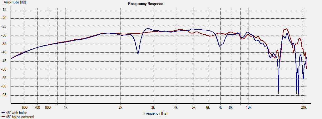

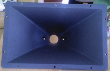

I have done measurements on a JBL SRX725 horns that does have screw holes in the profile (that is how the driver is attached, which make for a very solid and non resonant throat).
Here are the measurement, with and without covering them (I used foam and duct tape, as I did not have the original cover). Of course those dips cannot be equalized because they are different from a measurement angle to another.
Tom said putting the holes along the edges of the horn profile, like it is done in the Synergy, reduces the problem.
Bill Waslo posted some measurements of the effect of covering the woofer holes in his synergy horn (post #101) in this thread
