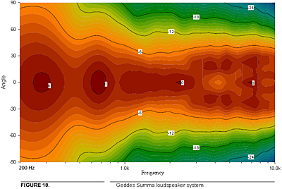

Below is an older version of Earl's Summa that has the resolution in the polar necessary to see this sort of behavior.

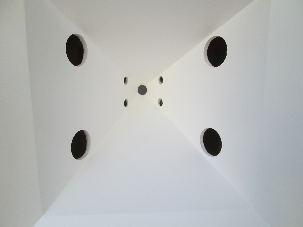

Someone posted regarding the shape of the midrange and woofer ports. The midrange ports are critical, and I can't tell you how many shaping variations I went through. Three major horn designs and more midrange porting experiments than I care to count. In one post I vaguely remember that Tom mentioned at some point you have to build a few to figure out the things you can and can't change...I agree wholeheartedly. If you have them shaped wrong you can get odd resonances that store a lot of energy. Placed wrong and you don't get the frequency response flatness or extension you want.

I personally think both can be reasonably well deciphered (perhaps it's something evolved from looking at Stereophile plots). 😛
BUT it's not nearly as clear as something like Earl's older Summa plot. In fact I don't think I've seen a plot as good as that - even his newer ones on his website aren't nearly as easy to "read". (..and even then the axis scale is a bit to "squashed".)

-but the older directivity plot itself is still overall better than anyone else's that I've seen (including your newer ones, though they have some advantages as well that the older one doesn't, like the improved detail on the Y axis and the reference to preferred listening axis.)
It will be nice when REW (Room Eq Wizard) has their's done. Hopefully it will incorporate the 3D mapping feature found in their spectrogram:

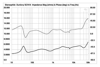

The Dunlavey SC/IV, which is in fact a multi-way (3 way actually), speaker's phase and impedance plot below..
The design's got some other serious flaws (horizontal axial response particularly), but impedance (at least with respect to being resistive) and phase isn't one of them. The impedance is quite low though, requiring a fair bit of current from the amplifier.
Aha Scott, There you have hit upon the other possible elephant in the room. Those speakers and in fact many similar, *are* 3 way speakers. They are in fact, the speakers that are being used to master the recordings we are judging the other speakers on! There are very few speakers used for mastering other than large 3 ways like my "sort of hated" 801's and the Dunlavys Dynaudios etc.One thing they all have in common is they are all 3 way, have a dedicated midrange in that critical area. The last standard 2 way speaker, which was largely abandoned BTW when the B&W's became poplular was in fact the Altec 604 and the Urie variants of it, obviously these are coaxial point source speakers with the point source and dynamic range charm but the FR discrepancies can still be heard on the recordings that have been mixed/monitored on them. This is at it's heart why I started this thread. A (3 way?) coherent speaker with extreme dynamic range and flat FR is now, at least I feel, much needed for mastering chores, not to mention that dynamic range hath it's charm just for listening (-: Fact: We are now dealing with Hip Hop as THE standard pop music, typically listened to at levels that would drive Misters Fletcher and Munson insane. A dynamic mastering speaker like this that also has midrange finesse would be a great tool.
The Dunlavey SC/IV which is in fact a multi-way (3 way actually) speaker's phase and impedance plot below..
