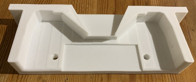

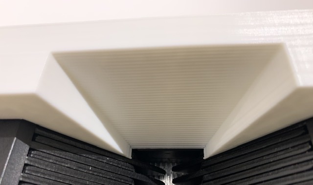

So this is a success! The test print turned out really well. The only unknown now is how the two halves will match together.
The 3FE22 would be a separate part that would be fixed to the adaptor, the port would go through. I have no idea on the size and shape of the port, I would need some help with that.

That looks terrific Pelanj! Great work.
If 60x30 is the best to go for for a Synergy horn, then that is what I will aim for if I build one too. I might just have to aim for closer to 500Hz pattern control rather than 385Hz as a 385Hz horn is more than 80cm wide!
500Hz pattern is fine. My horn was 30in wide and I would not want to go wider.
The print looks great Pelanj!
Congratulations!
Congratulations!
