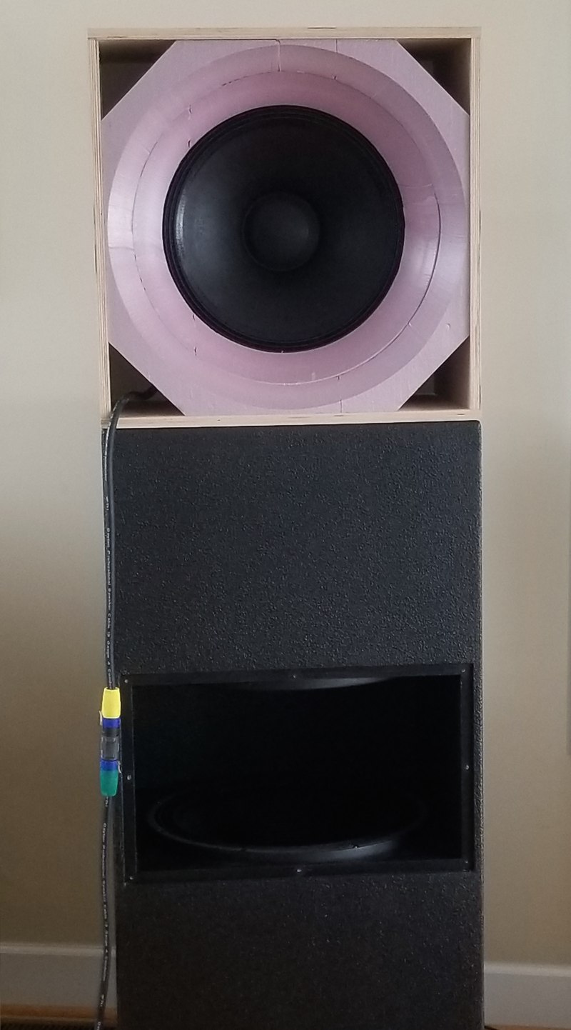

I know it's not what you're after, but here's an older project I still have going, in the same vein as the SM-80 etc....ie a coax with a horn to aid the cone output...my goal was to make an SM-80 that digs lower.
...need to change the foam horn rings .. i believe i should widen their angle, which now matches the angle of the cone... cause so far it's been better without the foam rings. B&C 15cxn.
I don't think these boxes are true synergies...but what you're thinking about is, afaict
