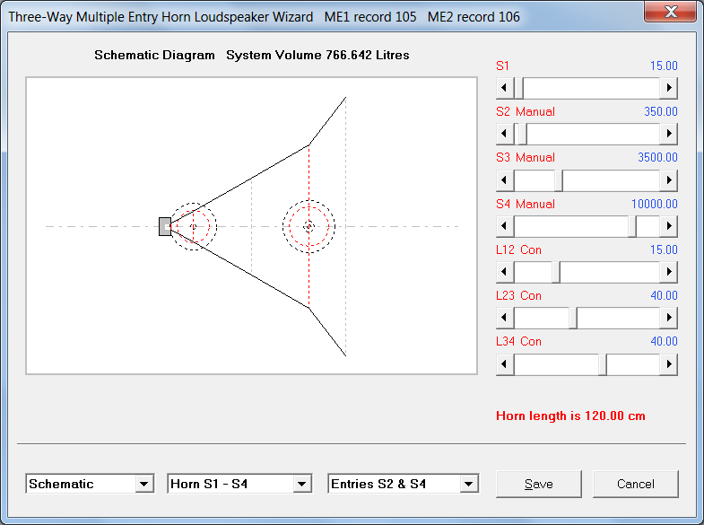

Let’s start with some simulations:
Note: 80V @ 4 ohms = 1600W, the program power of two 12NDL76s combined.
Note 2: Hornresp 39.40 is, as far as I know, not able to simulate this horn combined with a vented chamber for the woofers. I figured I could get about 6dB from adding vented ports tuned to 100 Hz and even out the bottom response.

Hi Thijs666:
HornResp is now up to version 40.30. You can simulate vented woofers as offset drivers on the horn without issue. You might not be able to do this when simulating it as a multiple entry horn but simulating woofers alone is not a problem
You should take a look and see how closely your CD and woofers are time aligned. The best indication is probably the step response of the full range measurement but you should also look at an overlay of separate driver measurment IRs.
Damn, I must have been living under a rock or something. Totally missed that. Took a shot at it, but I’m not feeling confident I got it right…
(had to guess some T/S-parameters from the Beyma CP850Nd, so that's not accurate!)
In fact… I’m pretty sure I didn’t get it correct :s.
I would be happier with something like this: (I hope I summed the vented OD horn correctly)
That would mean I would have to enlarge the vent holes from 39.10 cm2 to 120 cm2. So far for my simulation with WinISD
I tried letting my DCX2496 calculate the time alignment and it suggested to delay the CD by about 4 ms. I don’t believe that would be correct. Below is the impulse response of the full system (from the second from last graph of my first post). Am I correct in reading a 20 microsecond delay on the woofer section?You should take a look and see how closely your CD and woofers are time aligned. The best indication is probably the step response of the full range measurement but you should also look at an overlay of separate driver measurment IRs.

That would be a concern indeed. I don't see a way to get those 12's playing any higher than you can see in the graphs above. They are literally up against the mounting plate of the CD. So you need a pretty beefy CD, hence I picked up the CP850 and I fear even this one isn't capable of keeping up. Distortion measurements will have to point that out.
120 sq cm is a pretty large hole but then they are large drivers. You might get a better answer if you simulate a shorter port length - equivalent to a thinner horn wall or frustrumizing the port. A shorter port should allow a smaller hole for the same velocity.

The measurements above are done with 4 vent holes of 65mm diameter.
3.25^2*pi = 33.18 cm2 ... *4=132.73 cm2; hmm, doh, I think I screwed up at least one hornresp sim by using only 33.10 for AP. But the sim for 33.18 measures up better to my measurements than the sim with 120 cm2😕😕
