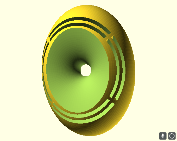

I have some measurements with and without this phase plug:
I'll post those tomorrow. Basically the enclosure is two parts:
1) the egg shaped enclosure for the woofer
2) a phase plug for the woofer and waveguide for the tweeter

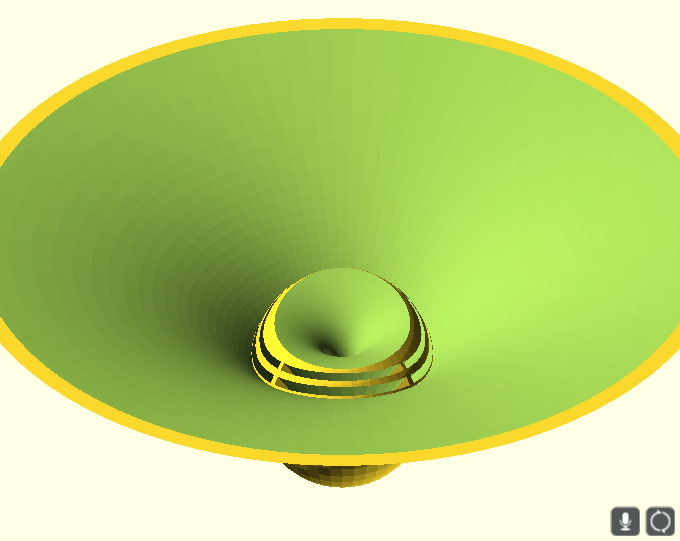

Here is a summary of the invention :
This is way to take a coaxial speaker and improve the polars with the use of a phase plug. Basically the phase plug mimics the shape of the loudspeaker enclosure, so that the wavefronts radiated by the tweeter don't "see" the woofer cone, they only "see" the enclosure. There are 'channels' on the face of the enclosure, so the surface isn't 100% continuous, but it's an improvement over a conventional coaxial. In addition to an improvement in the polars, there's a shallow waveguide on the tweeter. This waveguide is about 3.5cm deep, which provides horn loading down to approximately 2428hz. (2428 Hz is 14cm long, one quarter wavelength is 3.5cm long.)
In summary: for the cost of a plastic waveguide (about $1) you get improved polars. It looks neat too. IMHO it sounds better also. (I'll get to that.)
Here's the polar response of the 'stock' coaxial. This is a measurement of the speaker pictured in post 33, but with no phase plug.
Here's the polar response of the coaxial with this phase plug. This is a measurement of the speaker pictured in post 33.
Here's the difference in output, with phase plug vs without. The reduction in output in the octave from 3 to 6khz is because the 'stock' speaker has narrower beamwidth. Basically the waveguide is taking the same amount of energy and spreading it over a wider beam, hence the lower output level.
Here's the frequency response and distortion without the phase plug and WITH the phase plug. I think the 'channels' on the face of the enclosure are behaving like a diffraction slot, and raising the output in the midrange, basically 'filling in' a suckout in the midrange that exists in the stock speaker. Note that the coax with phase plug has 10dB less distortion than the stock speaker. But this isn't really a "reduction" in distortion, it's actually a bump in output, again from the channels in the phase plug. These channels are fairly long because they run horizontally, they're about 8cm long. That loads the woofer down to approximately 1063Hz.
I'd love to tell you guys that I built eight of these and came up with the perfect combination of enclosure size and 'channel' depth to come up with these results. Nope, this was just dumb luck. I basically nailed it on the first try, it's neat when that happens.

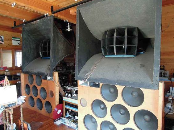

I like it, what I see is a horn in a horn. Kind of like:
...but smaller.
Don't mean to detract from the newness of this particular idea. Coming up with a new way to put a horn in a horn and throwing in a minimal diffraction enclosure is pretty cool. The "mid horn" in your egg is probably so minimal that it is ridiculous for me to call it a horn. Now, if you took the assembly and integrated the largest ring to an actual mid horn that might work too (except for defeating the small).
...but smaller.
...but smaller.
