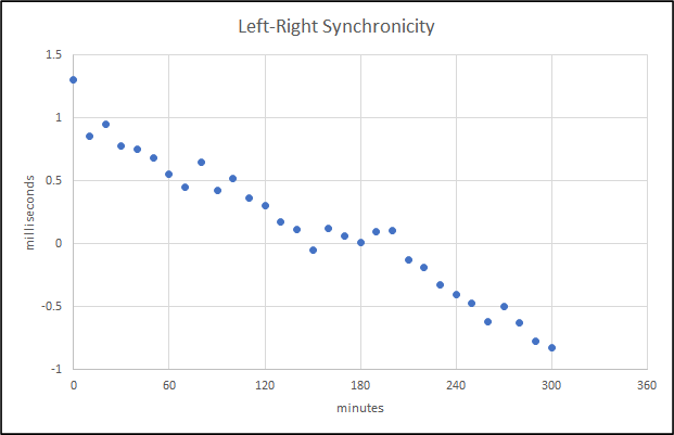

I finally have some data to post on the synchronicity of the left and right speakers in the system.
Honestly, it has been a bit of a struggle to get everything up and running. Initially, the measurements were more than a bit disappointing. The synchronization would start out around the 1msec target and then would drift away, sometimes by a lot! So I began a long journey of trying to understand what was going on, and how the various Gstreamer parameters were influencing the performance. I seem to be getting a better understanding of these now, and about various contributions to the timing across the system.
Currently I am using NTP to synchronize the sender and the two clients. The sender is synchronized to internet time servers and maintains around 0.5-1msec accuracy at any time with a polling interval of around 15 minutes. The clients poll the sender every 32 seconds and they stay within 100msec of the sender's time. This is pretty good performance for NTP that does not use a local GPS based time reference (that can be more than 10 times more stable and accurate). But for the purposes of what I am doing here, this is enough accuracy.
So, with that being said, I am attaching a plot of what I would consider to be "good" performance. The goal was to keep the left and right playback timing synchronized to within about +/- 1 millisecond, and this is more or less achieving that goal.
There is a slow drift in the synchronicity, and I am still trying to track down the source of that.

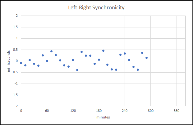

After a small tweak to Gstreamer's alsasink properties, I have been able to compensate for the slow drift shown in the previous two datasets.
The synchronicity between left and right speakers now remains within 1 millisecond, as shown in the measurement below. Most of the time there is less than a +/- 0.5 msec difference.
attachment.php
That looks very good. 0.5ms means the head is 15cm closer to one of the speakers, IIUC.
It means that the listener's perception is that the stereo image stays centered.
If you prefer to think about it in terms of "distance" that is fine, but I prefer to think about it in terms of what has been studied and reported for the precedence effect. I can support that with my own personal listening experiences as well. When there is a timing difference that is large enough (e.g. several milliseconds) it seems as if one of the speakers has been turned off. When you walk up to that speaker you find it is still playing, but at the listening chair the stereo image is shifted all the way away from it, over to the other side. It's an interesting effect. Once you stay below about 1 msec difference in playback timing, this effect is absent.
I think that many "bit perfect" audiophiles will look at the data above and scoff, but it comes down to whether or not you can hear any difference. Who cares if bits are perfect or not, if you cannot tell one way or another? To get the system synchronized in this way, samples are added or removed or the playback pointer moved as needed. Just back away from the dual channel scope and take a listen! It's otherwise all 24 bit PCM audio.

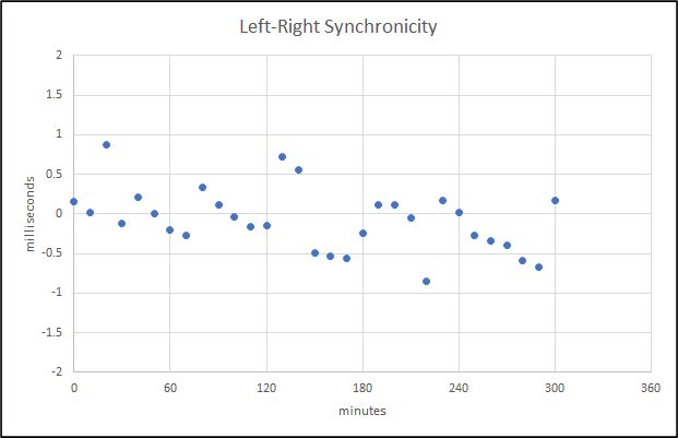

For this series of data, I performed a slightly different experiment. I previously had NTP on the "sender" synchronized to internet NTP time servers, and the two clients synchronized to the sender. For this experiment I wanted to see what happened if there was no internet connection available. The same NTP arrangement can be used, except the time reference can only be the local clock on the sender. That clock is running freely and is not necessarily keeping accurate time. But NTP can still be used to set the other clocks in the system to have the same time, and therefore the same rate, as this "reference". The funny thing is that NTP actually performs BETTER under these conditions. There is less time offset on the clients compared to when internet time servers are used. This is probably because the local clock on the sender Pi is not being modified/slewed to keep it synchronized to anything. By letting it run freely it is only changing smoothly and slowly from external disturbances such as temperature changes, etc. Since the system is set up in my basement where temperature changes are minimal, and the system is constantly running, the clock is probably quite stable even if it is not accurate. Under these conditions the offset on the clients is about 2 or 3 times lower than when using internet time servers as the reference. This amounts to under 50 microseconds of offset, often much less.
You can see how the lower offset improves the left-right synchronicity in the data below, compared to the last dataset I posted. This was collected over about 5 hours. I would have more data except my laptop decided to reboot to install a stupid Windoze update before the run was complete. Thanks Microsoft! But I have every reason to believe it will just keep going like this. Synchronicity is now within about +/- 500 microseconds. In terms of the goal I was hoping to achieve, and with the precedence effect in mind, this is excellent.
I will collect some additional data under the same conditions, and then will probably try to do some listening for a change. After that I might try to explore what happens when there is a larger drift in the reference clock. I think I can force NTP on the sender to have a fixed drift rate of my choosing but I need to read up on NTP in a little more detail to confirm that. Even with a larger drift rate the system should still work properly, however, it would be good to get some confirmatory data. The other experiment I could try is to shut down one of the client Pi for several hours until it cools down to ambient temp. I can then start it up and immediate begin streaming while it heats back up while performing regular left-right synchronicity measurements. This will help to test whether drift in a client's temperature will cause disturbances in the system synchronicity. On paper I expect NTP to be able to compensate for this, but it would be good to measure it.
The latest measurement data is attached, and shown below.
attachment.php

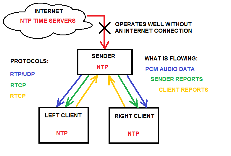

I have attached a schematic of the setup I am using to implement synchronized streaming and measure the synchrony, shown here:
attachment.php
The system hardware consists of three Raspberry Pi 4B configured as:
  • A SENDER (or server)
  • A LEFT CLIENT (or receiver)
  • A RIGHT CLIENT (or receiver)
The sender Pi implements a WiFi hotspot on an unused 5.8GHz band. The software that is used to implement the hotspot are hostapd and dnsmasq. Hostapd is configured to use wmm (quality of service prioritization) for traffic. This results in a low-latency link between the three Pi computers.
Gstreamer is used to implement the streaming, comprised of RTP streaming plus bidirectional RTCP "reports". RTCP reports include timing information and the combination of sender and receiver reports make up a feedback loop. Using this feedback, the system can adjust the Gstreamer pipeline current time and clock rate as necessary to synchronize the rendering of audio from the left and right clients.
The system also uses NTP to synchonize the OS system clocks on each Pi. The reference time used by NTP can be obtained from internet-based NTP time servers OR the sender local clock may be used as a reference for the clients.
To obtain a measurement of the synchronicity of the system, the following additional components/software is used in the manner described:
  • An analog input (ADC) HAT is used on the "sender" Pi
  • A 2-channel AMP HAT on each client Pi powers the tweeter and woofer of a DIY 2-way speaker
  • A Windows laptop running ARTA ver 1.9.3 and a Focusrite Clarett 2Pre audio interface is used to perform measurements
  • A microphone is placed close to the tweeter of each speaker system. Each mic is connected to an input channel of the 2Pre
  • ARTA is operated in the "Record > Signal Time Record" mode
  • Delay (implemented as part of Gstreamer playback chain on the clients) is used to introduce a playback timing difference between left and right speakers
  • One speaker is delayed by X msec. The mic channel signal from this speaker will be used to trigger the ARTA measurement
  • The other speaker is delayed by Y>X msec. The output from this speaker will be captured by the measurement
  • The ARTA software sends an impulse out of its analog output, which is connected to the input channels of the sender analog ADC HAT.
  • The impulse travels over WiFi to the clients, through the Gstreamer DSP chain, and emerges as audio from the speakers.
  • The impulse is first reproduced by the speaker configured to have less delay. ARTA sees this signal and starts recording
  • While ARTA is recording, the impulse is reproduced by the speaker configured to have more delay and is captured by the recording.
  • The recording ends and the data is saved to file on the Windows machine.
The above measurement process was automated using the software AutoIT. Using the automation, a series of measurement data files were created at a regular interval (e.g. 10 min, etc.). This comprises a data set that must be post-processed to determine the synchronicity.
Because there is a fixed delay difference between the two speakers and the recordings are triggered by the earlier impulse, the time at which the impulse is recorded minus the difference in the delay that was programmed into the DSP marks the timing difference between the two speakers. For example, if the earlier speaker is delayed by 10msec, the later one is delayed by 20msec, and the recording captures the impulse appearing at 10msec (the difference between 20msec and 10msec) we can say that the two speakers are in perfect synchrony. When the impulse arrival deviates from 10msec there is a timing difference between the two speakers.
To process the measurement data, an Excel spreadsheet was used. Each audio record (consisting of time,amplitude pairs) is imported. The time at which the impulse maximum amplitude is observed is then saved into a table. Each measurement of the data set series is processed manually in this way, and then the data from the fully completed table is plotted. These are the plots that have been presented in this thread. The typical synchronicity is obtained via inspection of the scatter in the plotted data.

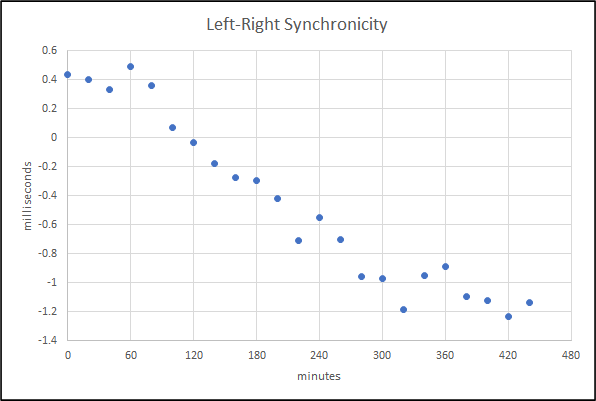

I had my system setup using an isolated master NTP clock on a local server all my clients connect to. Seemed to work fine. In my observations NTP wouldn't make a step change of the system time unless things got really out of wack. It tries instead to make small tweaks to it's time scaler to bring things back inline. The biggest issues seemed to come when NTP itself adjusted it's own time scaler, but I didn't know that's what was happening yet. I had previously tried to compensate for accumulating error by taking a running average to determine the rate at which that error accumulated, then use my acquired error drift rate to correct for drift. This seemed to work well, until something happened to upset my calculations. It would stabilize and work again on it's own, but not without a big interruption in the audio. Once I figured out the NTP scaler change is what was causing my issue, I figured out how to read that scaler instead of guess at it. It's basically 1 + (1 / (1000000 / the value in /var/lib/ntp/ntp.drift)). If you're doing something like creating an audio timestamp by constantly adding in the period_time, multiply the period_time by that scaler first and it won't drift away from the system time anymore.
Once I moved to the ALSA API library to get an accurate timestamp each time I send a period of audio, I didn't need NTP correction anymore as ALSA takes care of that for you.
The only time I use the NTP correction scaler now is generating timestamps and metering data out of librespot and shairport to be a multiroom audio source.
