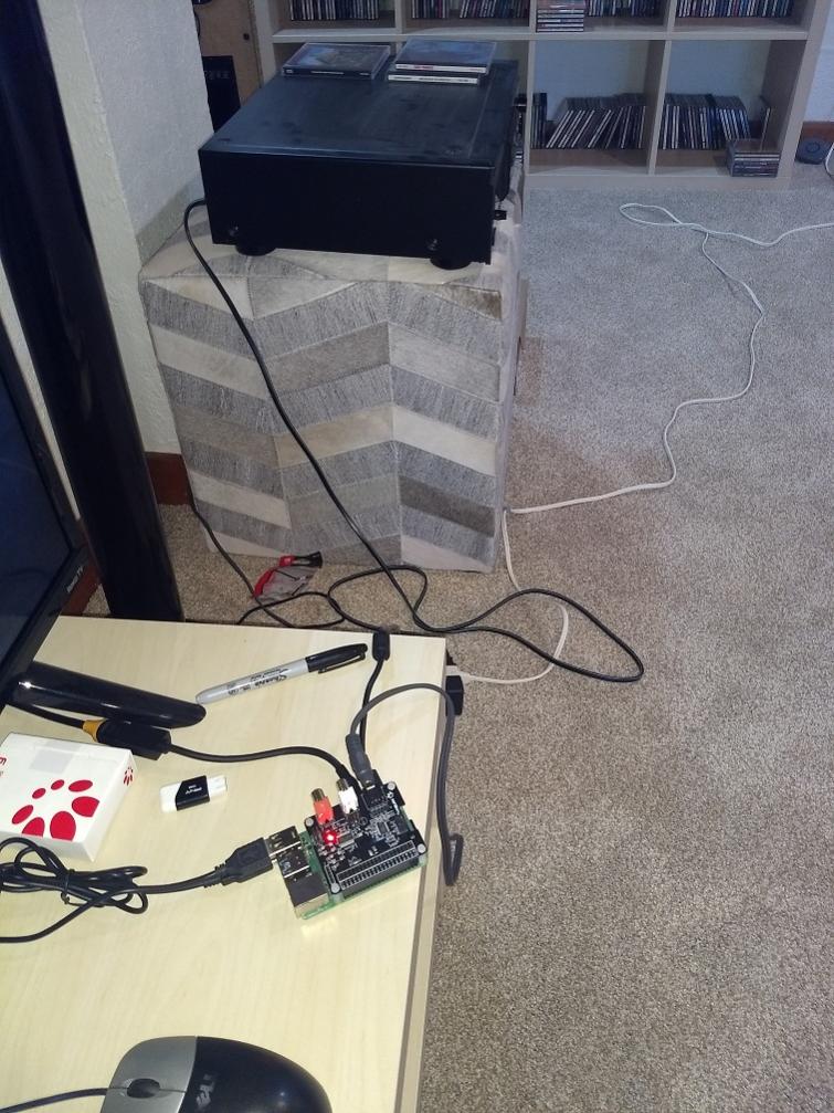

I have started to create a new, independent group of three Raspberry Pi 4B computers to test out the synchronization in the absence of NTP.
One R-Pi will act as the streaming audio server. It will have an audio input, either spdif or analog (have not decided yet). It serves up a WiFi network to which the clients can connect.
The two client computers will each be incorporated onto the back panel of a small 2-way speaker that I built several years ago. Its an active DSP speaker so there is no existing onboard crossover - that was previous done via outboard components. To implement the crossover and amplification I am using the DSP crossover functionality of my GSASysCon software. For amplification I am using HiFiBerry Amp2 HATs plus a Meanwell LRS100-24 SMPS. These components can all be mounted to the back of the speaker, with an AC power cord providing power to the system. There will be no other physical wiring to the speaker. I am still in the process of setting up the clients, but hopefully I should be able to get them working in the next few days.
This implementation is portable because the server generates its own WiFi network. I could take it to another location like a DIY show and it should work without having to do any changes or setup. I can add more clients, e.g. for a subwoofer, etc. as necessary.

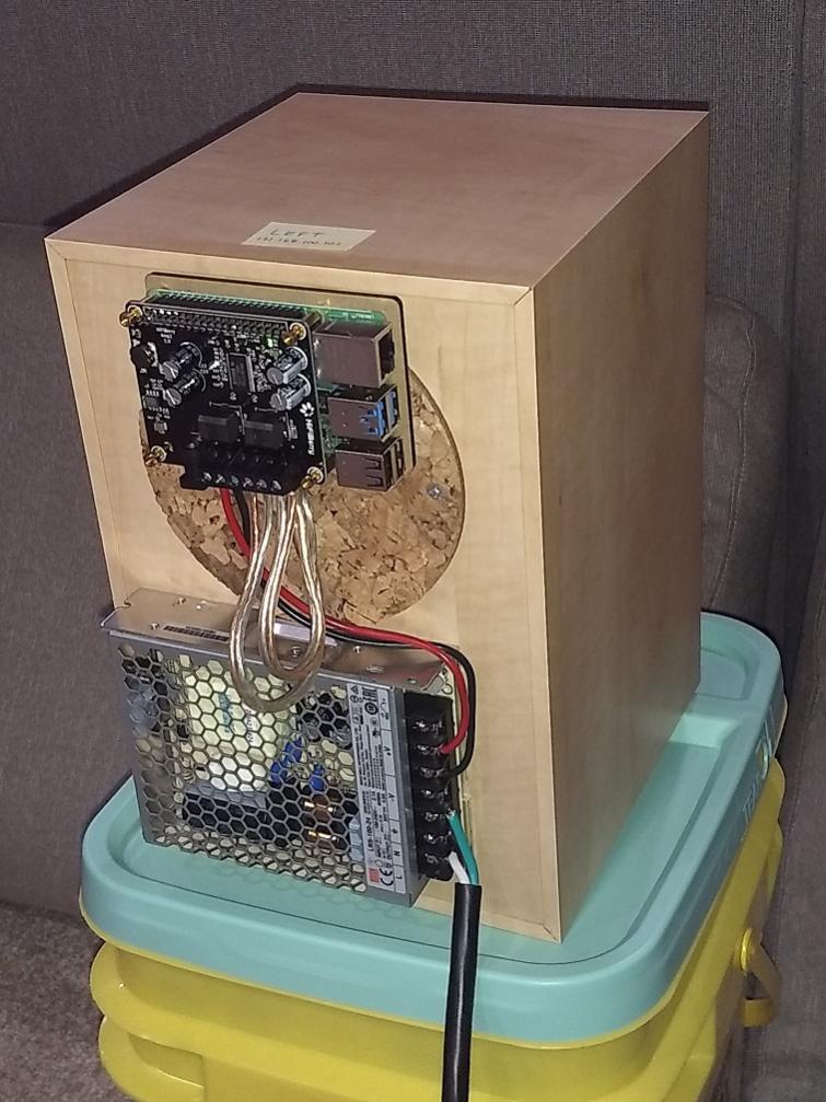

I finally have the multi-client synchronized streaming test bed up and running, the one described in the last post. It's alive and working well!
I have been streaming 24bit uncompressed audio wirelessly over a private 802.11n network and so far everything seems to work perfectly.
I've attached a pic of the SMPS and Pi+Amp2 HAT bolted on to the back of the speaker. Sorry the lighting was bad and I snapped this with my phone, so the pic quality isnt' all that great.
I will do more listening and testing over the next few days.

I have done several hours of listening now and the system seems to be working great. Each speaker is running an independent client Pi and the DSP crossover filters are implemented on the clients, in software. While streaming 16/48, 24/48, or 24/96 uncompressed audio the speakers never lost sync and I did not hear any audible glitches or other hiccups. The system can be started from a "power off" state to active playback in about 1 minute.

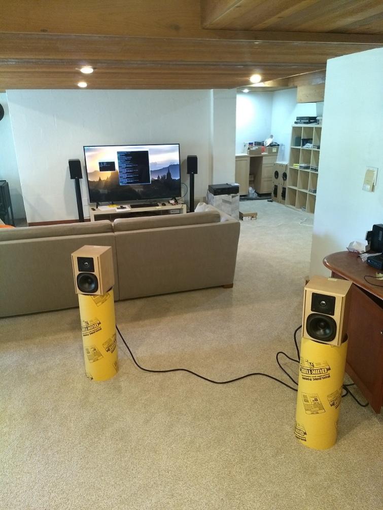

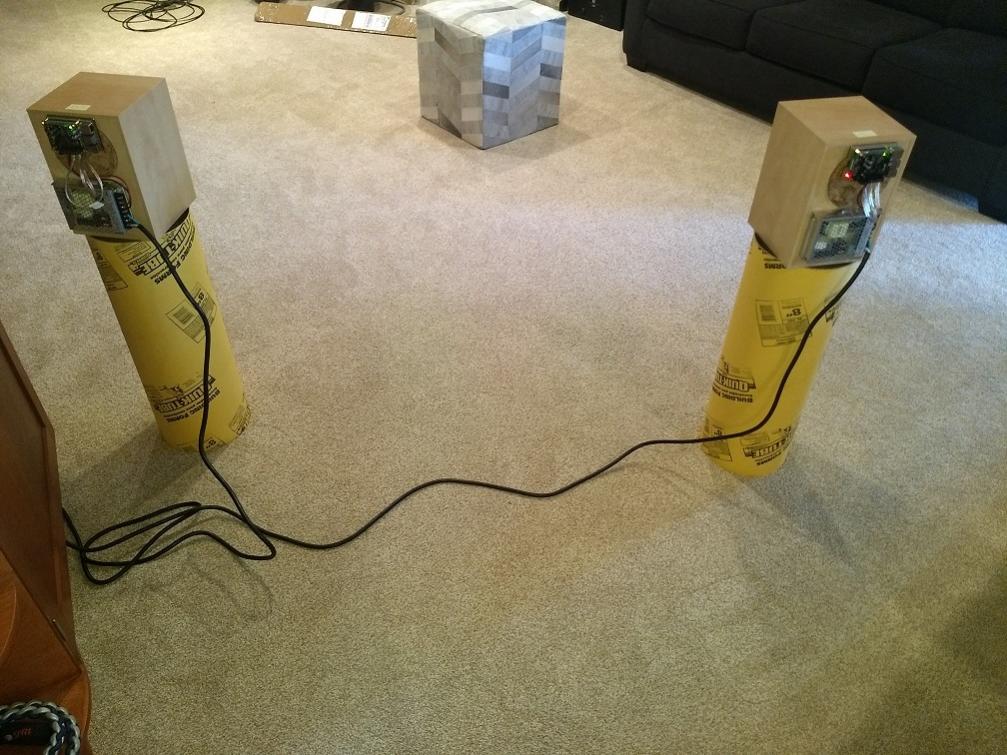

Below are a couple more pics of the system, set up in my basement speaker testing cave: front side and back side of the speaker, and a shot of the Pi with ADC HAT connected to CD player input.
The system is working great and is small enough to be installed right on the speaker. Amp HAT puts out about 30-40 WPC, 2 channels, in a nice and compact package. Temps on the Pis and the amp HAT seem to be quite reasonable, although I have not really pushed the amp to high output levels yet. The Pis are set for a fixed CPU frequency of 1GHz and with no heatsinking run at around 55-60C depending on the ambient temp. I also reduced the CPU core voltage a few notches to keep the heat generation down. The CPU usage on the clients, while receiving the audio stream and doing DSP processing, is only around 35% of one core (on a Pi 4), so the Pi is not really working that hard.
