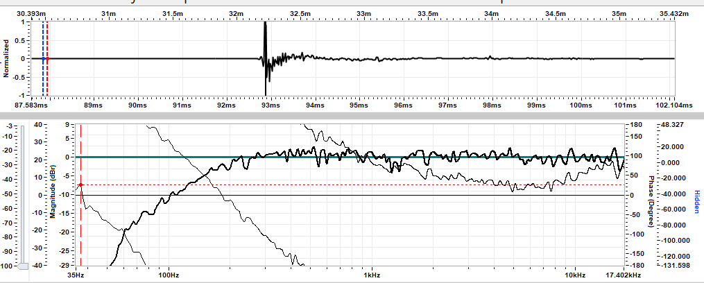

Hi Steffen, yes, as you asked in another thread, the IIR work I've been doing is for syn10.
I've put all my main speaker DIY attention into trying to find processing improvements. I don't really want to build any more syn versions, and even if i did, baltic birch (russian) is not available. Lesser quality ply is just too hard to work with ime.
Anyway, I made some nice sonic improvements with FIR, by studying the actual electrical FIR filters, in addition to measured acoustic response.
Getting the electrical filters impulse responses as clean as possible, while maintaining the desired acoustic target response, has had a positive effect maybe best described as subtly lowering the noise floor. Just sounds like there a little more contrast between quiet parts and the music....a little more real.
The IIR work now, is because that FIR work seems maxed out. IIR is all that left Lol. And what a pain it is...
That said, the sound from my first all-out attempt is very nice. I could live with it. Doesn't quite have the grab-me capability that some songs under FIR have, but damn close.

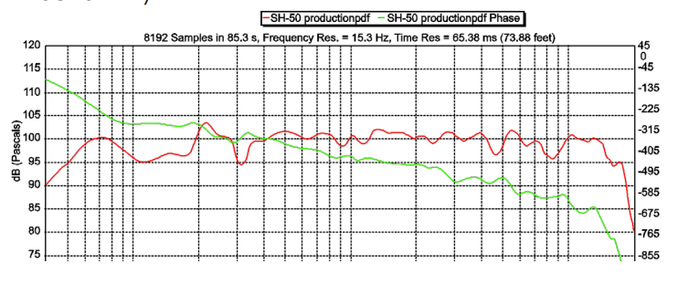

I also think the SH-50 shows phase rotation that disavows the idea of anything less than first order electrical xovers. Looking at DSL's spec sheet, I'd say there is about 360 degrees of phase rotation between high and low, ignoring the phase tails at the very bottom and very top.
Given there are two crossovers in play, let's just call it 180 degrees for each. Very nice indeed !
Anyway, seems to me there has to be something probably close to first order electrical on top of natural drivers rolloffs.
If you look at my first order mag and phase graph above, there's about 540 degrees of rotation from the high end down to about 80Hz. Syn10 is meant to be crossed at 120Hz, so it's phase tail will kick in sooner that sh-50.
Syn10 also has an extra xover compared to the sh50 due to the coaxial CD, so I dunno, first orders on top of natural rolloffs seem to make decent sense.

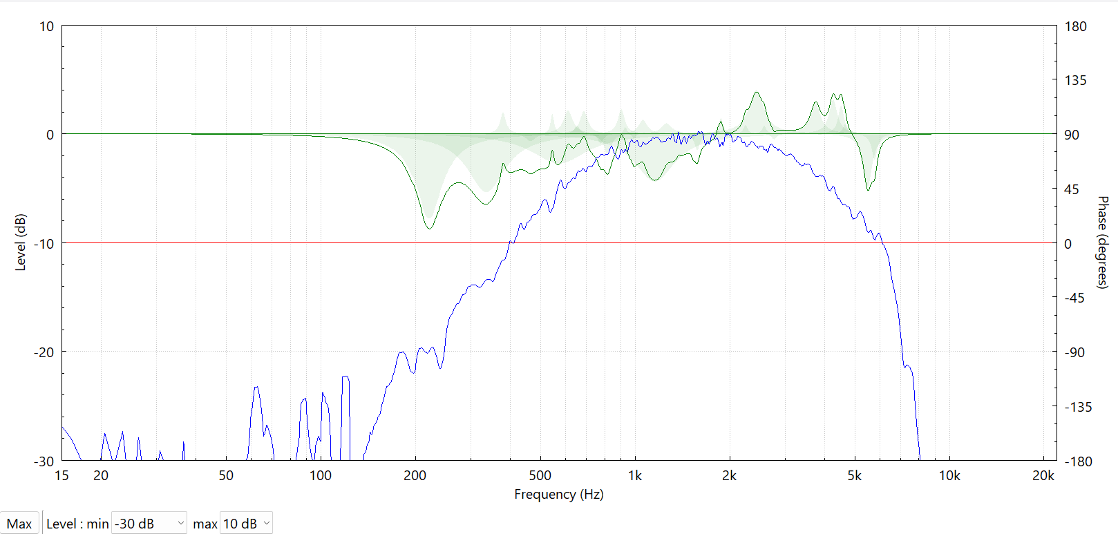

Here's a fun, albeit rather overcooked example of using IIR PEQs to accomplish high-pass and low pass...
This is the lower section of the dcx464 CD, filtered with only PEQs to give a LR24 1k to 4k bandpass.
The green stuff is the PEQs.
With DSP PEQs less is more.
Paying attention to the phase via time delays and these small PEQs has as big a sound quality upgrade as going from a cheap MM cartridge to a nice MC / SUT setup - I kid you not!

Now I've built the SH60 alikes, The SH50's will be used for a couple of weddings in marquees. 50 to 70 pers.
I will revisit the setup and perhaps impose more HF driver safety for the BMS 4550 that will be used.
It's reportedly pretty robust but want to be within safety margins - even if that means using a 2nd order along the way.
PA is new to me and I guess I'm likely to underestimate somethings, but aim to compensate with a cautious measure and test approach to build my understanding of how things respond.
