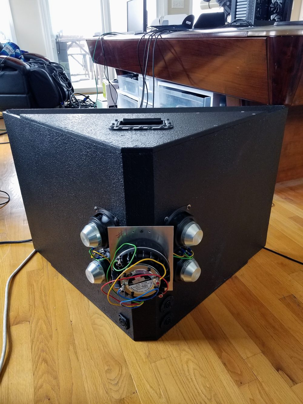

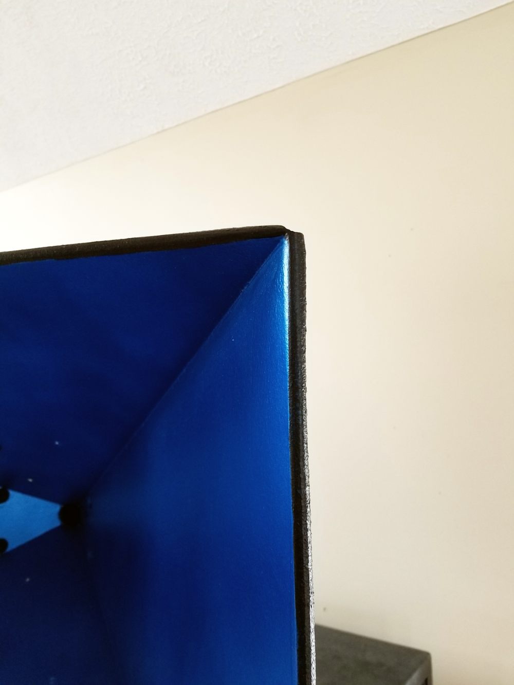

The corners on mine aren't the greatest because I built them to BWaslo's sheet dimensions, but instead of beveling the primary horn flares to work with secondary flares like the sheet is set up for, i simply let the mouth ends stay square, and did a 1/4" roundover on them, inside and out.. That leaves a little angle gap in the backs of the corners.
I was gonna epoxy the corners' backs in to make them look really nice, but since i'm leaving drivers exposed ....i thought wtf..."what price pretty?" Lol
Besides Duratex black is still my favorite finish haha Although i'm loving the electric Chrysler blue in the horns 🙂
here's a pict...not sure it shows much.

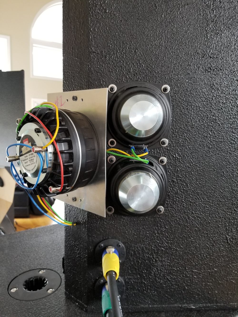

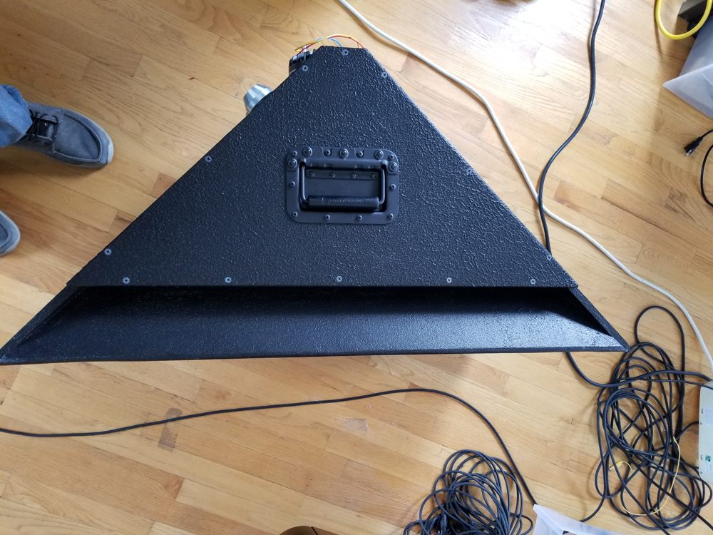

also followed by top and back in case it helps...
ask away if needed....

Wiring question I noticed "I believe" an nl4 only. I see two but wondered how you have them configured.. wouldn't one nl8 be "better"?

That's a NL8 on the bottom left.
I
also put two NL4's on the right, as i have different amp feeds at times..

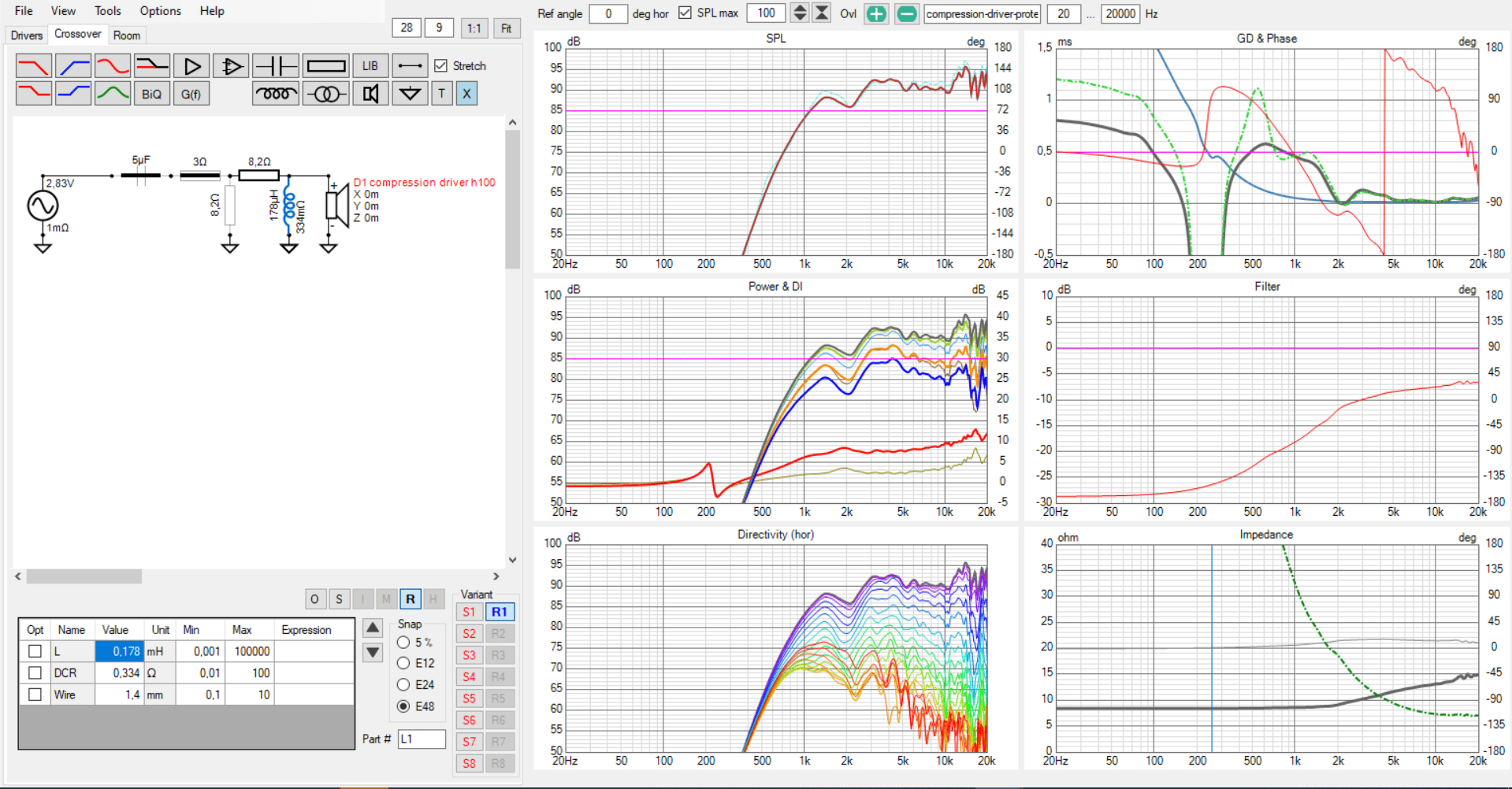

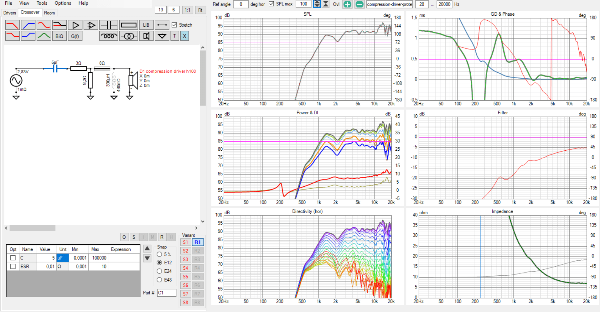

So given the above explanations I think you and I are thinking alike, what each "source" sees as load impedance. Hopefully the magnetic damping part also makes sense now? If not, then perhaps could you comment how you think about it? perhaps I don't have required understanding yet.Tmuikko, I don´t think there is any magnetic damping!?
As I understand it the parallel inductor is part of a second order high-pass-filter (with a series capacitor). So the amplifier sees the second order filter, the compression-driver sees a short circuit in the form of the dc-resistance of the coil.
As I read the above text there is some inconsistency like first sentence from above post "If eddy current flows, with low impedance circuit as load for the driver, the compression driver diaphragm doesn't move much. " which should of course read more accurately "If eddy current flows, with low impedance circuit as load for the driver on its resonant frequency, the compression driver diaphragm doesn't move much on its resonant frequency as magnetic damping resists the movement. ". Writing in a hurry is never a good thing, possibility to increase confusion rather than understanding so sorry for this, was in a hurry but wanted to let it out 😀 See the links for better delivery.
How this relates to active systems? We can somewhat optimize load of amplifier and load for driver introducing some passive parts between, if we want to, and if it yields audible benefits. I don't know, surely looks like THD would reduce but that doesn't correlate with perceived quality so the stuff would need to be listened in each application if it was worth it or not. After all, passive and active system is about double the cost and trouble 😀 Small coil and a resistor, for compression driver in domestic application doesn't cost much though, so perhaps easy and cheap test. Cost is about as much as L-pad and protection cap would. Plan to test this some day soon after get opportunity to find good values for my system and make an order.

But, don't miss the possibility here if you have these as your ultimate HiFi system at home listening levels 🙂 For example I have series capacitor and L-pad for my compression drivers to reduce noise of my poor amplifier and provide protection just in case. Instead, I could use series resistor and the shunt coil for similar response and utility and for about same cost. Both implementations give protection and attenuation but the coil version also dampens the driver resonance better. Or more accurately allows the driver magnetic damping happen. I guess your 2nd order filter does about the same thing so you are good.
Also nothing between the driver and amp is good for the damping to happen at resonance, but there is some aspects raised on the links I posted that past the main resonance, at higher frequencies, it would be worthwhile to reduce current generated by the driver in the system. Not sure about audibility, as this kind of systems are very low distortion at home listening levels anyway.
See the attachments, both implementations fullfills same criteria for my system, but the version with coil makes the driver resonances damped better.
Perhaps all this is very familiar to most speaker designers 😀 I'm enthusiastic for it now as this is something new I've learned 😀
I'm not great with passive xo stuff, have used digital for years. When I looked for calculators to work out a 1st order high pass using an inductor I could not find much info. Did I miss something simple or does it have to be a 2nd order slope ? (I'm working on re-doing my meh xo using 1st order slopes at the minute)

Do you have active system as well? You could use just first order filter if you wish, and if it has benefit in sense as discused here before. Just adjust your DSP accordingly. You could make second oder filter if you wanted to. All that matters is the acoustic slope in the end (and now you have changed the impedance in the circuitry with passive parts, hopefully for better performance) even though the frequency response now looks exactly the same as before 😉
