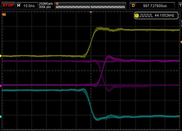

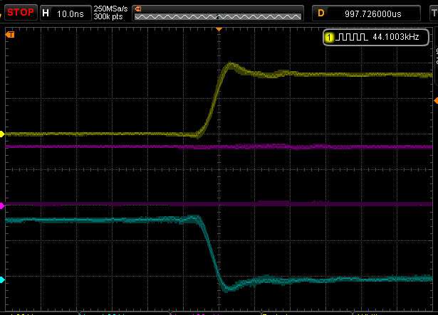

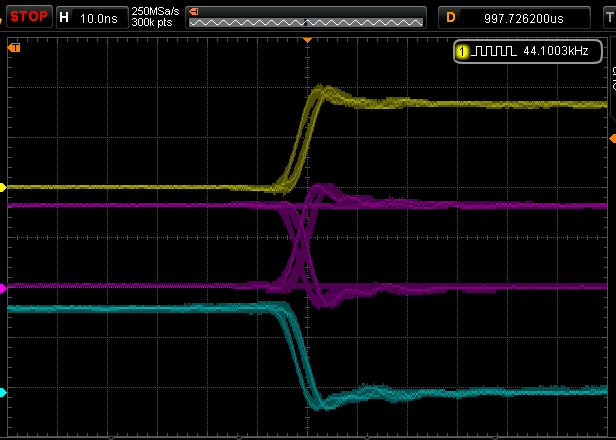

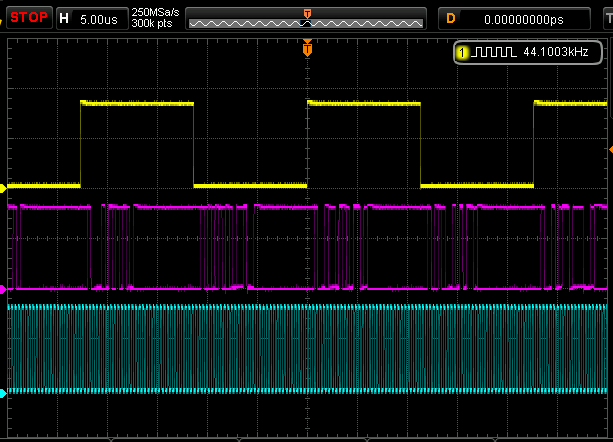

Here is an oscilloscope screen capture of the well-known BCLK swing in I2S of raspberry pi.
Here's a comparison between volumio2 and symphonic-mpd.
I2S signal Yellow: LRCK, Red: DATA, Blue: BCK
volumio2 Hifiberry-dac driver (DAC slave) 5us
volumio2 Hifiberry-dac driver (DAC slave) 10ns
symphonic-mpd v0.8.x hifiberry-dac driver (DAC slave) 10ns
symphonic-mpd v0.8.x hifiberry-dacplus driver (DAC master) 10ns
This was taken with an older version (v0.8.x for RPi3).

Hi papalius,
That are some interesting images, not quite that, what i would have expected.
so, the difference in signal-quality between different software is much bigger
than the the difference between master or slave mode, right?
and i don´t know if read the picture with the measure from Volumio right,
so the doubled lines on the edges of the signals (when it shifts from 0 to 1 or from 1 to 0 )
are the phase-shift of the signal, but phaseshift is practical phasenoise aka Jitter,
and when the gridlines are 10 nanoseconds apart you have a shift of ca. 2,8 nanoseconds.
(distance of th gridlines is 50 pixels in the picture and distance of the lines is in aveverage 14 pixels)
i mean, it can´t be really THAT bad, because jitter is usually measured in picoseconds !!😱
on the other hand the difference between master and slave mode isn´t so big,
it even gets covered up partly by the background noise.
it would be interesting to see a measure from Volumio in master mode...
i wonder, if maybe the PLL of the rasberry isn´t so bad after all, and the real reason for
the bad quality of I2S output is a poorly optimised OS...
papalius, could you please tell us which oscilloscope was used ?
Hi M_Balou,
I am told that this image was measured with a RIGOL DS1054Z.
The person making the measurements is the designer and developer of DAC HAT.
Probing with an oscilloscope is an advanced technique in itself, but I have complete faith in his skills.

The clock used in I2S is obtained by fractionalizing PLLD (500 MHz).
For example, to generate a BCLK 2,822,400Hz for a 44.1 KHz sound source, RPi3 can be used to generate Two frequencies, 2,808,988Hz and 2,824,858Hz, are combined in a specific ratio to It generates a BCLK of 2,822,400Hz.
If we simply turn off MASH, RPi3 produces a BCLK of 2,824,858 Hz and It causes a change in pitch and a change in playback speed. (For those who don't have absolute pitch, the changes in pitch are just something you get used to while listening to the music. and sensitive to changes in tempo, which is unacceptable to most people.)
There are two things that I am acutely aware of throughout the development
The first is that for the hardware to perform properly, it needs to be configured correctly for its intended use.
The Raspberry Pi is a versatile hardware and many of its default settings do not take into account the quality of audio playback.
By properly initializing the hardware for a specific application, BCLK shake (a type of jitter) caused by MASH in the PLL can easily be countered.
Second, and more importantly, there is still a significant difference in sound quality between a DAC master and a DAC slave, even if there is little or no difference in oscilloscope observations.
Furthermore, we have experienced that the sound quality difference between the DAC master and the DAC slave can be reversed through software optimization.
In fact, the sound quality of a DAC slave with software optimization is higher than that of a DAC master without software optimization.
