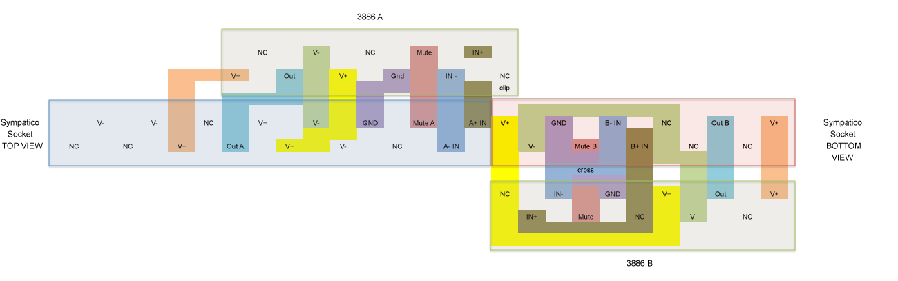

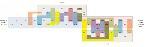

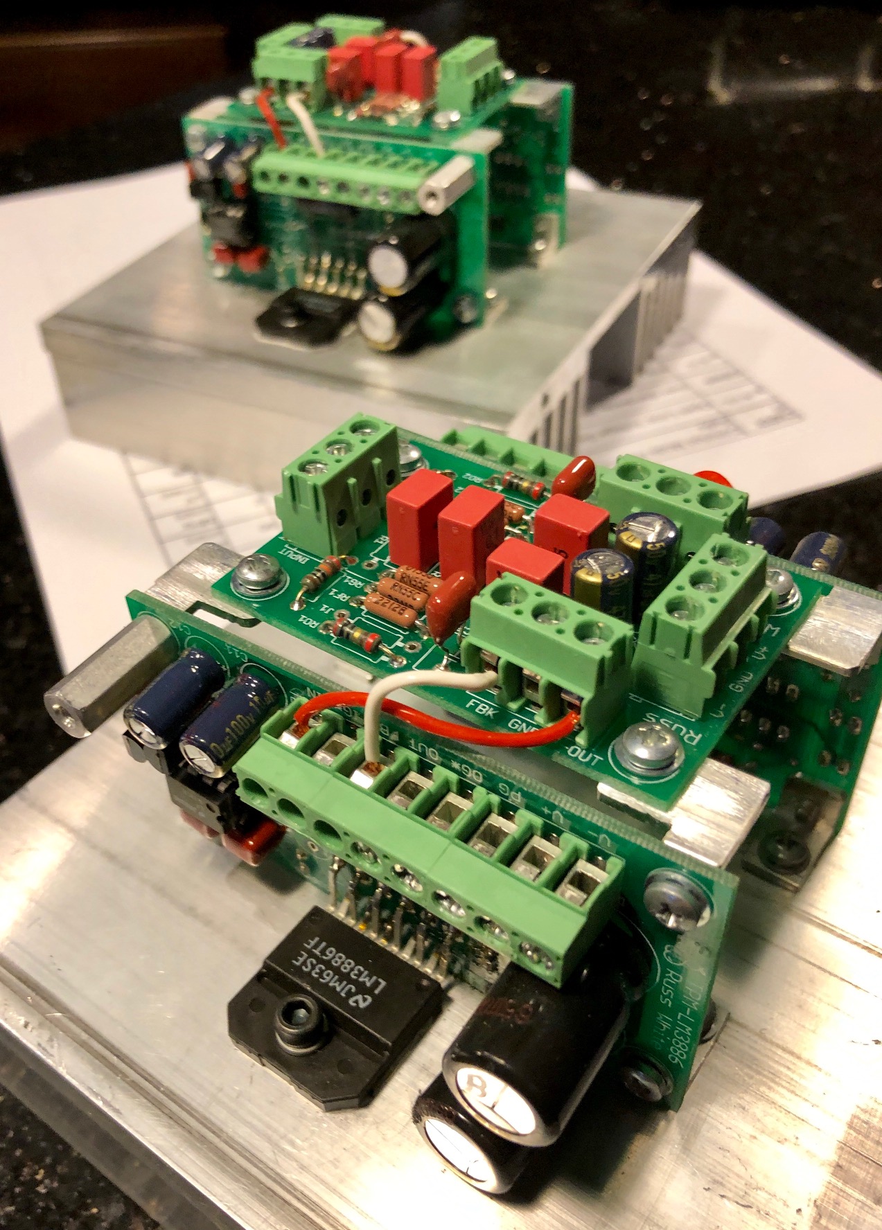

A mini audio project over last weekend was to update an older TPA amp. I didn't need a whole Sympatico kit so I went with bare boards. Since LM4780s are no longer available, I substituted 3886's, like the amp being updated. No smoke, no problems. Output is to tweeters only, and they are crystal clear... Attached is the pin layout, in case anybody else has reason to try this. Cheers!

The old heatsinks were perfect for the paired 3886s. I realize their S/N isn't quite up there with the 4780, but this works. I would certainly trust our friends here, but I'm naturally skeptical about the quality of hard-to-find parts from far-flung internet sources. Stress on the board? I used dead-soft solid silver to connect so there would be no stress at all. 😉

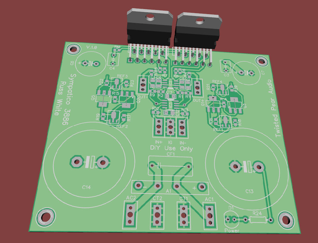

This morning I did this:
Any thoughts?
Cheers!
Russ

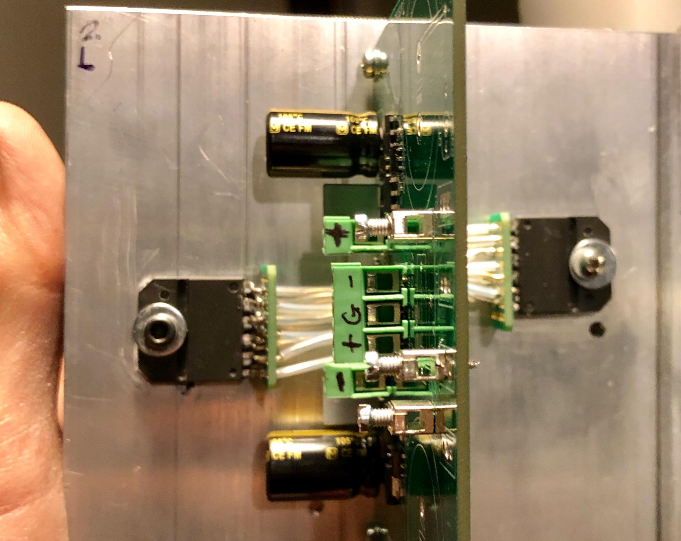

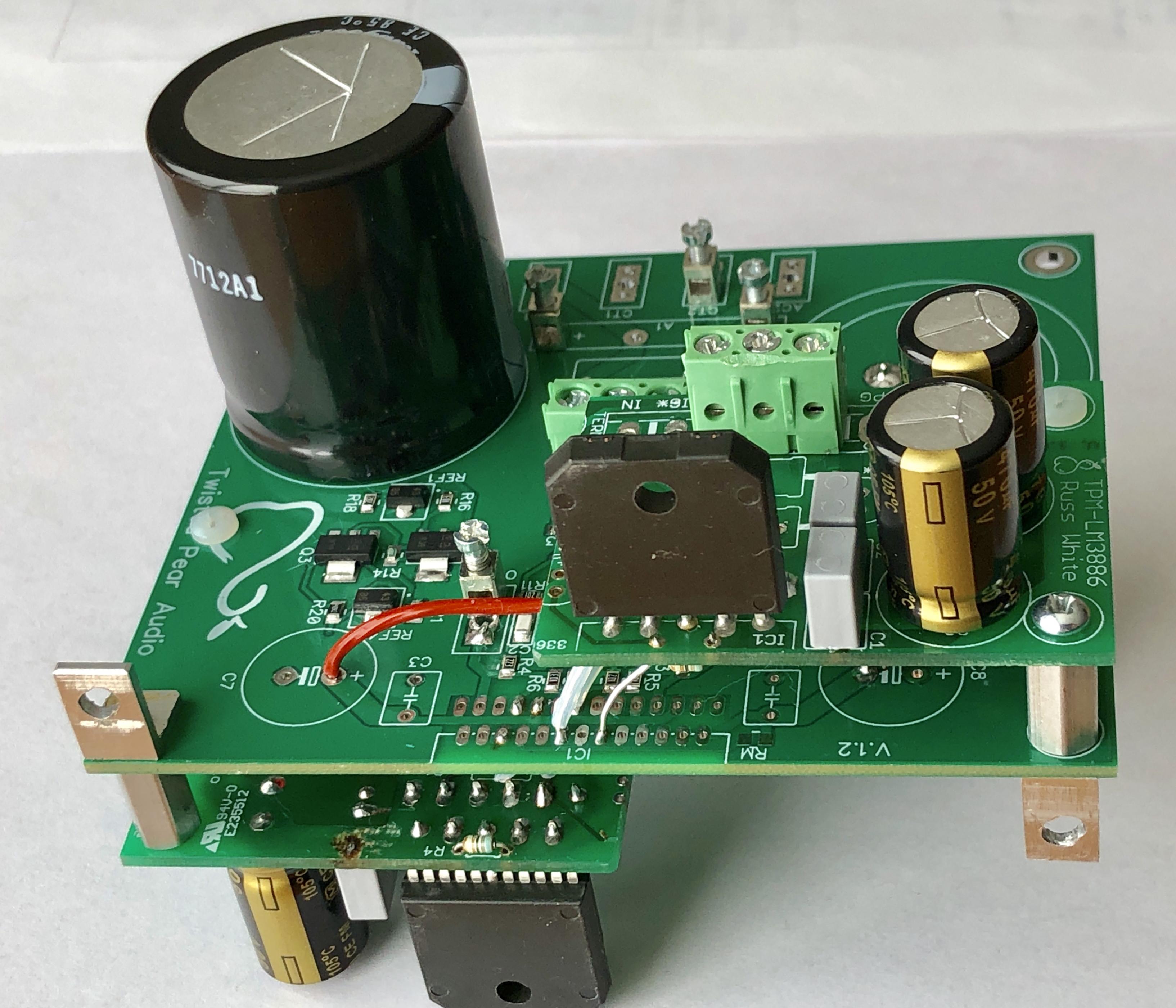

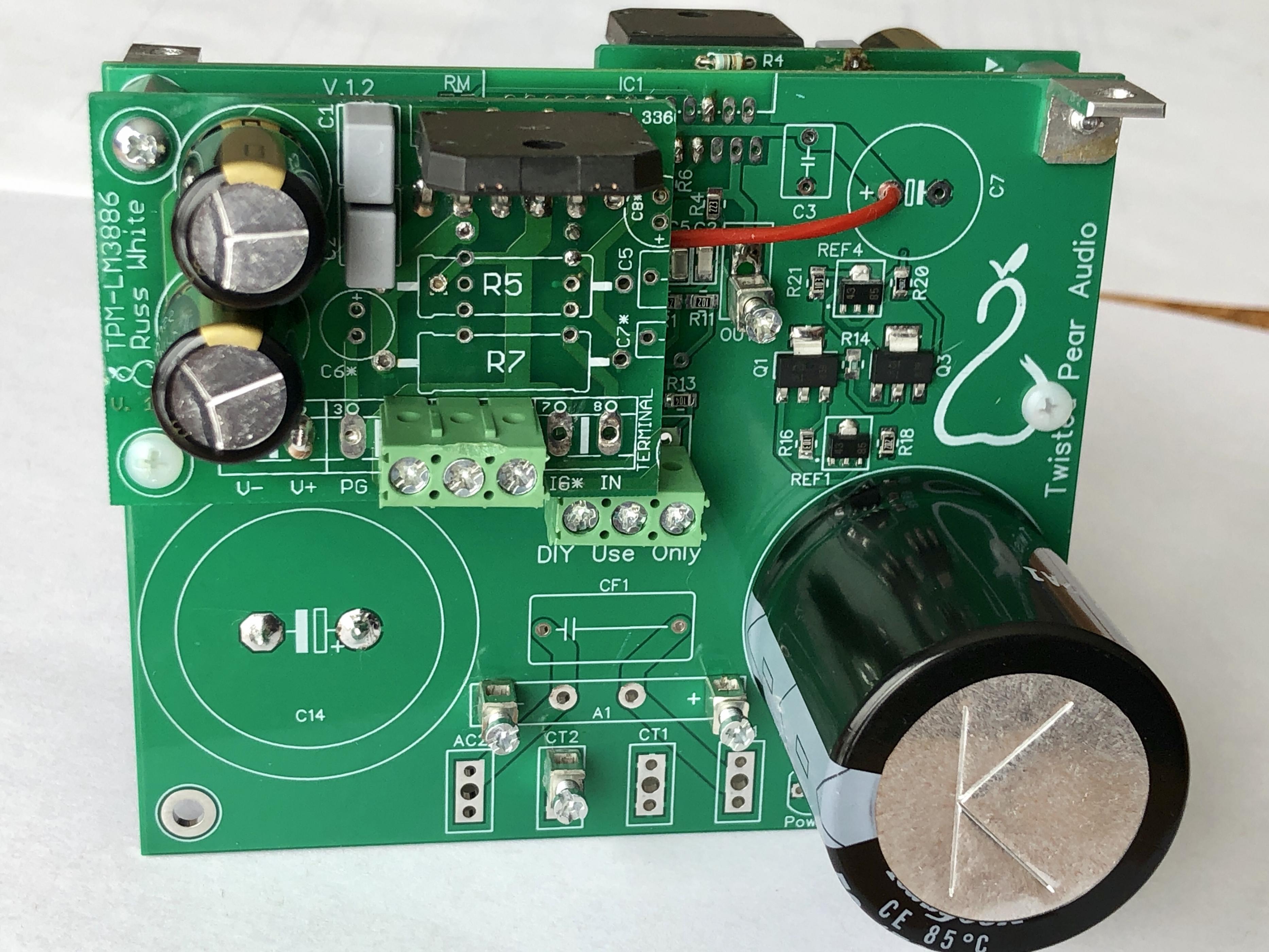

The photo below shows the TPM/TXD modules that came off of the heatsinks onto which the current Sympatico mod boards were attached. My TPM/TXD amps served very well and gave me years of pleasure. When the DIY bug bit to upgrade, I built an Aleph J. It sounded great but was just not a good fit as my system evolved - sooo much heat! So my next amp project was a new Sympatico, which was very pleasing and very comparable in sound to the Aleph J (with my drivers). Comparing my builds and uses, Sympatico (w/ 4780 & 45K uF capacitance/channel in the PS) is noticeably more refined than the TPM/TXD amps with their 3886s. ...and just last weekend I could hear an immediate improvement in the >2kHz band with the Sympatico/3886 vs. the TPM/TXD. BTW, both new channels showed only 12 mv DC out on first cold startup.
Re: Russ' musing, I seriously thought about adding extra decoupling caps on the little 3886 adapter boards! I recall reading about 10 years ago that decoupling directly to the power pins of 3886 gainclones helped eliminate some noise. But I finally ruled it out for a number of reasons, among them my pleasure with my alredy-running Sympatico and the fact that the adaptation was an experiment.

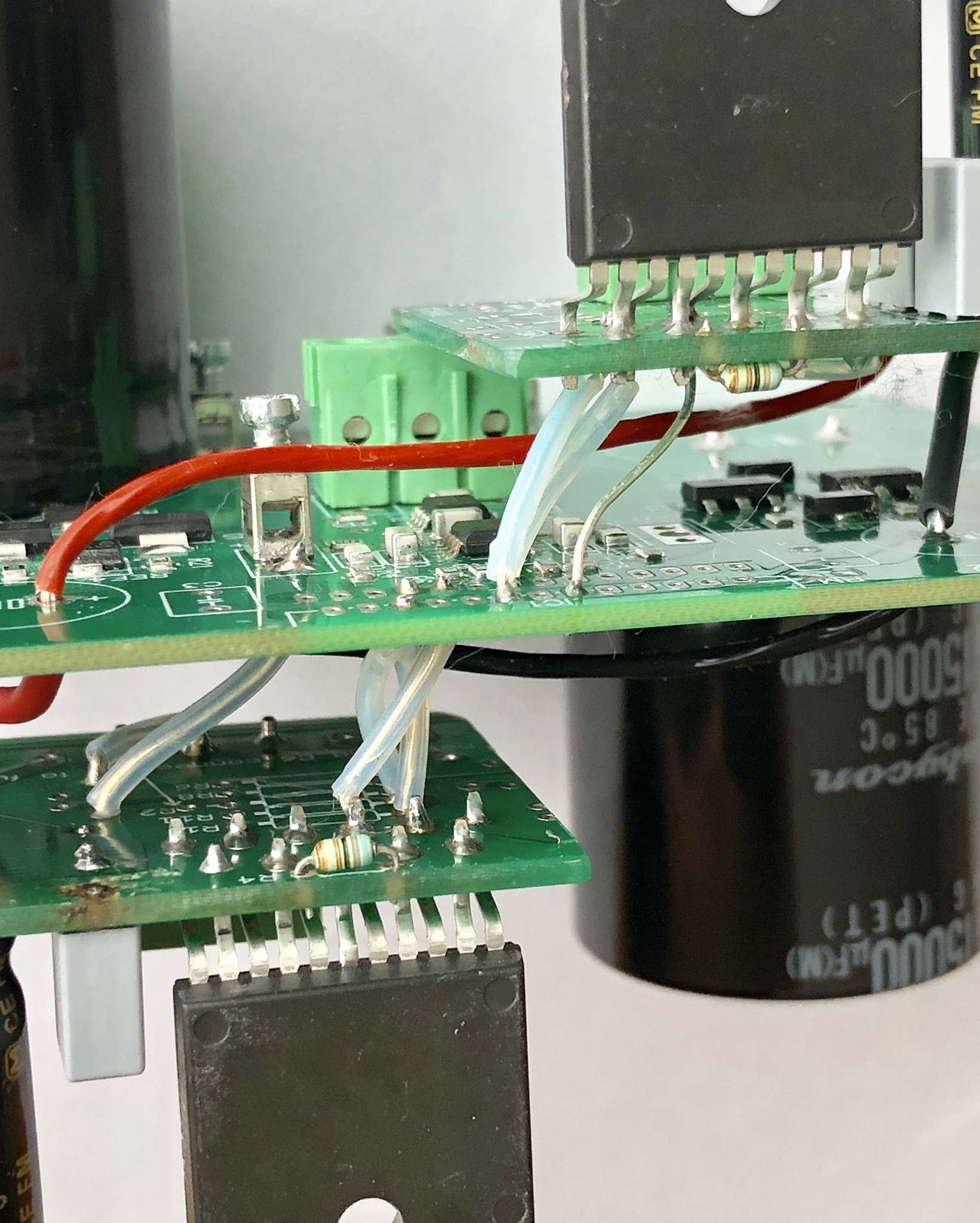

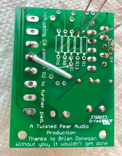

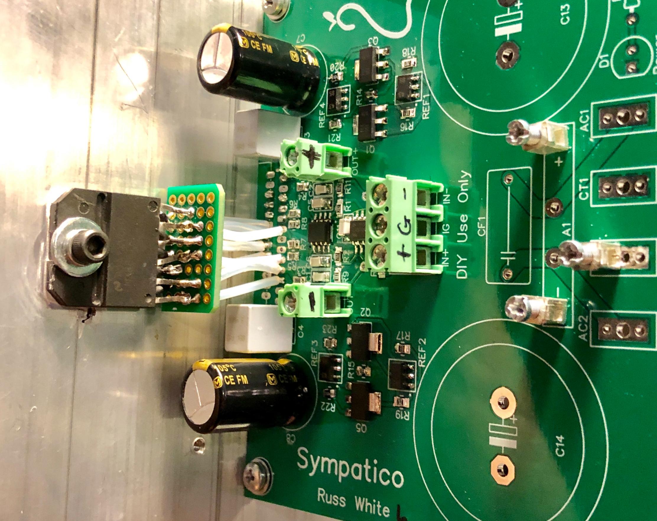

It seemed the damage could have been in the 3886s so I started over, this time with more confidence in the quality of the outcome. I was about to start making some custom chip adaptor boards but then it struck me that I could re-work some of the retired boards. ...can hardly wait to power these up!

A quick note to say 'mission accomplished'. Thanks, Brian, for helping me past a brain-freeze.
The Sympatico-3886 is a nice amp! My woofers are clearly playing tighter and with more control - especially 'cranked'. My other LM4780 Sympaticos are on 32V rails but this one is getting 36.5V. I tweaked the gain from stock to ~14x per side, but also added an extra 20mF capacitance to each power rail. I like that the re-purposed adaptor boards give each 3886 its own decoupling caps (note the nice inscription on the back 🙂). The gray Vishay .22uf film decoupling caps are a personal favorite that I've used in my other Sympaticos as well.
