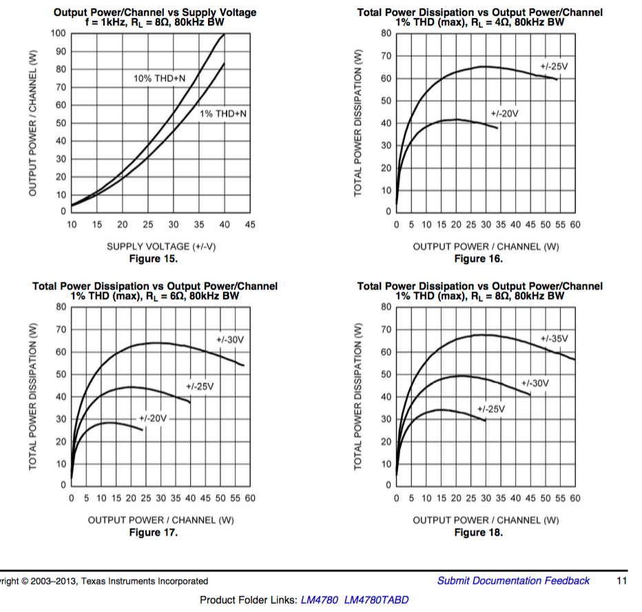

Agree with the last point. Four thoughts re the other recommendations:
1. I used a bridged amp with paired LM3886 chips at +/- 37 volts for 8 years. The chips still work.
2. Consulting the LM4780 data sheet, the maximum supply voltage is listed as +/- 42v on page 4.
3. Figures 15 and 18 from page 11 (photo) suggest that +/- 28v is quite conservative and gives up significant potential power.
4. The LM4780 has built-in protection against damage by a) over voltage, b) instantaneous thermal spikes, and c) long term over temperature of the die. That long-term thermal cutoff is 150°C - way hot!

Sympatico is using its 2 channels in bridged mode, so you should look at the max voltages applicable to the BR100 configuration. Those are described in the BPA200 application notes.
I assume you are referring to table 1 here: http://www.ti.com/lit/an/snaa021b/snaa021b.pdf
This information seems intended for configurations of LM3886. If I am not mistaken, the amp circuits being replaced by my Sympatico are that very configuration of 3886s. So again, I had no problem after 8 years of running at +/- 37v and driving midranges that can dip down to 6.2 ohms. I am not an engineer nor qualified to critique the circuits per se. If you have a brief explanation of why in this BR100 circuit Ti apparently derates their chips compared to the abilities listed in the chip's data sheets, it might be academically interesting. Is it simply related to heat dissipation? In any case, I'll be running at +/-31.7v and just take my chances! :cool:
Frank
Unless you simply have no other transformers i see no reason to run higher voltage. I'm going to re-assemble my Sympaticos soon and i'm actually thinking of using 20V trafos - there's more than enough watts already, if only running higher voltage could add more current capability as well, but i heard it's the opposite...
It's all explained in the application note in detail (see Pdmax). Basically if you exceed 40W per IC then the limiter will kick in. The LM4780 essentially has 2 LM3886 ICs in the same die and is isolated hence the lower Pdmax limit as opposed to the LM3886T or LM3886TF ICs.
By all means, run it at 31.7v and report back! :devilr::hot:

Doesn't figure 15 (copied above - 8 ohm example) of the data sheet inform this decision? Watts and voltage being proportional, I see a slope of less than 1 only below about 17 volt rails (where you get only 15 watts per channel).
Back to figure 15 again, I see no inflection point at or near the a 40 watt/channel output and the text concerning Pdmax suggests to me that the 'limiter' is in fact the built-in thermal protection. Am I confused or is figure 15 incorrect or irrelevant?

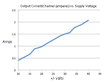

Here is the current output from one LM4780 channel vs. supply voltage. This was simply approximated ('eyeballed') from the 1% data in figure 15 of the data sheet (watts/voltage). So, higher voltage rails give more output current. Another advantage of higher supply voltage is shown in figure 28 - a half volt increase in clipping threshold. ...just have to manage the heat...
