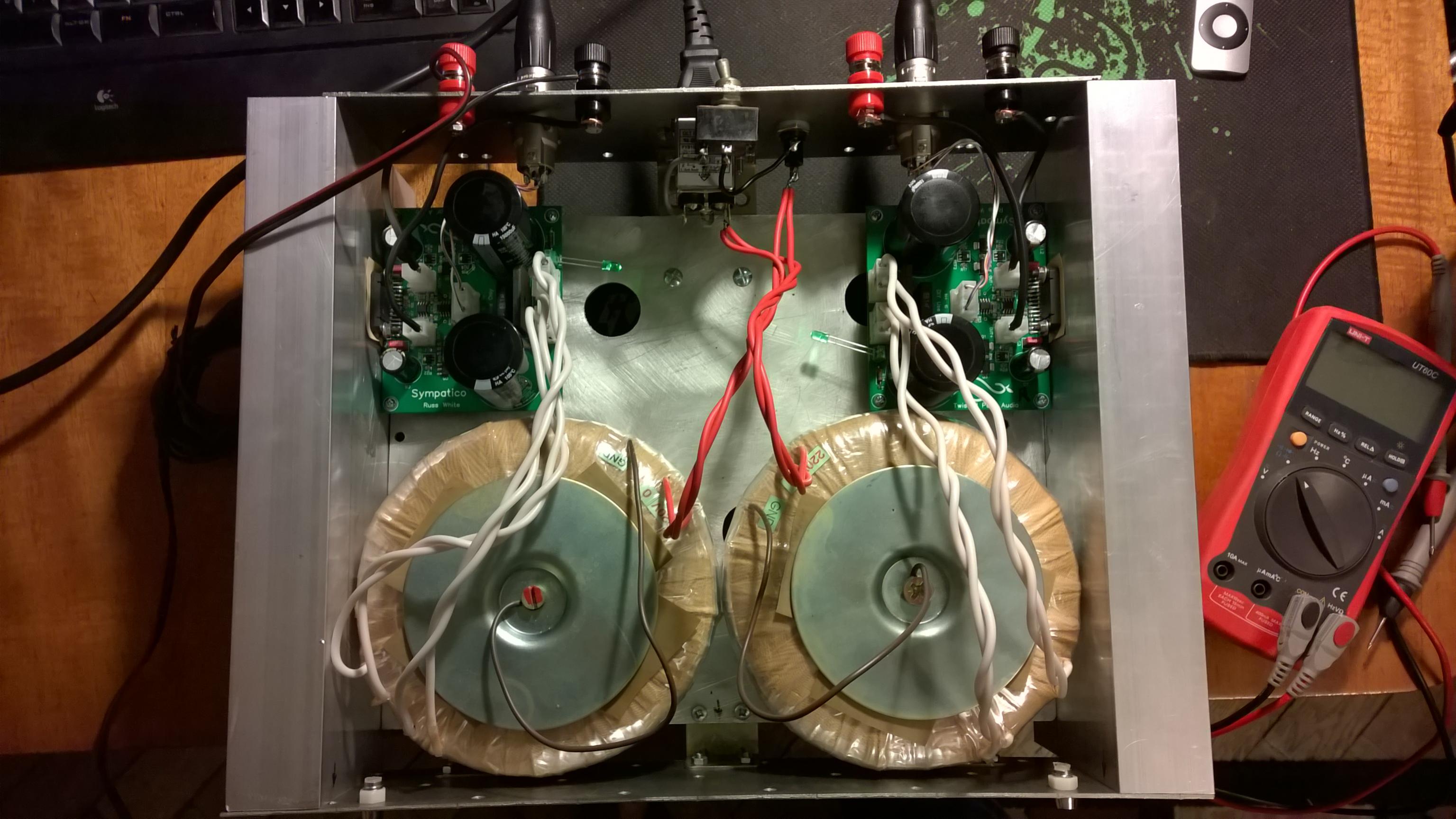

here's mine. Assembled it a couple of days ago - all went smoothly. I'm using digital volume control on Buffalo (II and IIISE), so no analog volume in the amp.
