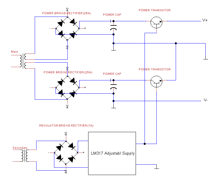

Hi everyone!
I plan to make a regulated power supply with two symmetric positive sources but I'm not sure my idea. 🙄
To explain a little, there would be a plate with a small adjustable control transformer and power sources with another transformer, filtering, etc ...
I made a pattern but there must be problem I think. 😀
Regards!
And one more thing, you can't tie the bases of those transistors together like that and expect it to work.
You've got the idea of making a + and - regulated tracking output supply, but as you surmised by saying "there must be a problem," you're not quite doing it right.
