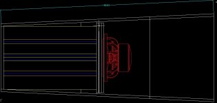

progress pix, took a bit longer to build as I had to keep stopping to go set up PA & do shows...I'm sure many here can relate lol

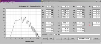

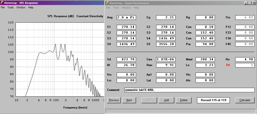

Hi epa,
Looks like this will become a nice thread 🙂.
I just took a look at your AkAbak script in Post #1, and there may be some errors in it.
In the keyed in schematic the driver should return to the horn @ node 19.
In the script for 'Horn segment 10' the nodes seem to be wrongly assigned, and the Radiator should not connect to node 19, but to 20? Also, you seem to missing a 'Horn segment 12'.
I'm no AkAbak expert, maybe somebody who knows what he's looking at can take a look at this.

Just started spl testing on first cab, no question...it's a real sub by golly 😀
My chosen method & tools: Cheap voltmeter, Radio Shack SPL meter, Apex 220 reference mic, Behringer mini mixer for mic pre, SmaartLive, QSC RMX 2450 Amp (the same one that will be driving these when installed). Used voltmeter to set 28.5V to the speaker at 100Hz, took reading with rat shack SPL meter at 10meters, 6" off of the ground (just above the grass) to establish a baseline & calibrated Smaart to that fed by the Apex in the same position, on a stand, 6" off of the ground. After that initial calibration I'm merely toggling frequencies in the generator & logging the readings. Not exactly lab accurate, but it should give usable real world numbers, right?

Remember I built two of these at once. The first one involved all of the figuring out how to actually build, miscuts & recovery, & the like that comes with my occasional carpentry. The second went together to the actual spec...so cab 1 is solid & respectable in appearance, but tolerances were tighter on #2...#2 is louder across the spectrum, but both behave very well in subjective listening (no huffs/puffs/growls/farts/burbles/other sonic complaints). In fact, they came out wonderfully & they absolutely exceed the modest requirements of the venue.
Here are the SPL test results:
calibrated to 28.5vrms @ 100hz measured at 10meters

hi oliver.Hi epa,
just like you im not an expert in akabak😀.
did you look at the actual script ,or did you look at the picture.
the pic is missing a few lines.
ill repost it in ful now.
S1 = 900.00e-4; |Horn segment 1 throat area (sq m)
S2 = 900.10e-4; |Horn segment 1 mouth area and horn segment 2 throat area (sq m)
S3 = 900.20e-4; |Horn segment 2 mouth area and horn segment 3 throat area (sq m)
S4 = 1105.00e-4; |Horn segment 3 mouth area and horn segment 4 throat area (sq m)
S5 = 1105.10e-4; |Horn segment 4 mouth area and horn segment 5 throat area (sq m)
S6 = 1563.00e-4; |Horn segment 5 mouth area and horn segment 6 throat area (sq m)
S7 = 1563.10e-4; |Horn segment 6 mouth area and horn segment 7 throat area (sq m)
S8 = 1771.00e-4; |Horn segment 7 mouth area and horn segment 8 throat area (sq m)
S9 = 1771.10e-4; |Horn segment 8 mouth area and horn segment 9 throat area (sq m)
S10 = 1800.20e-4; |Horn segment 9 mouth area and horn segment 10 throat area (sq m)
S11 = 1799.30e-4; |Horn segment 10 mouth area and horn segment 11 throat area (sq m)
S12 = 1804.40e-4; |Horn segment 11 mouth area (sq m)
L12 = 0.10e-2; |Horn segment 1 axial length (m)
L23 = 50e-2; |Horn segment 2 axial length (m)
L34 = 0.10e-2; |Horn segment 3 axial length (m)
L45 = 50e-2; |Horn segment 4 axial length (m)
L56 = 0.1e-2; |Horn segment 5 axial length (m)
L67 = 50.75e-2; |Horn segment 6 axial length (m)
L78 = 0.10e-2; |Horn segment 7 axial length (m)
L89 = 71e-2; |Horn segment 8 axial length (m)
L910 = 0.10e-2; |Horn segment 9 axial length (m)
L1011 = 22e-2; |Horn segment 10 axial length (m)
L1112 = 25e-2; |Horn segment 11 axial length (m)
Vtc = 10000.00e-6; |Throat chamber volume (cubic m)
Atc = 840.30e-4; |Throat chamber cross-sectional area (sq m)
|Parameter Conversions:
Sd = 1225.00e-4; |Diaphragm area (sq m)
Ltc = Vtc / Atc;
|Network node numbers for this tapped horn system:
| 0-Voltage-1
| -Chamber-5-Driver-
|8-Segment-9-Segment-10-Segment-11-Segment-12-Segment-13-Segment-14-Segment-15-Segment-16-Segment17-Segment-18-Segment-19-Segment-20-Radiator
Def_Driver 'Driver'
Sd=1225.00cm2
Bl=24.70Tm
Cms=1.39E-04m/N
Rms=5.13Ns/m
fs=30.9998Hz |Mmd = 164.97g not recognised by AkAbak, fs calculated and used instead
Le=4.60mH
Re=5.00ohm
ExpoLe=1
System 'System'
Driver Def='Driver''Driver'
Node=1=0=5=19
Duct 'Throat chamber'
Node=5=9
SD={Atc}
Len={Ltc}
Visc=0
Waveguide 'Horn segment 1'
Node=8=9
STh={S1}
SMo={S2}
Len={L12}
Conical
Waveguide 'Horn segment 2'
Node=9=10
STh={S2}
SMo={S3}
Len={L23}
Conical
Waveguide 'Horn segment 3'
Node=10=11
STh={S3}
SMo={S4}
Len={L34}
Conical
Waveguide 'Horn segment 4'
Node=11=12
STh={S4}
SMo={S5}
Len={L45}
Conical
Waveguide 'Horn segment 5'
Node=12=13
STh={S5}
SMo={S6}
Len={L56}
Conical
Waveguide 'Horn segment 6'
Node=13=14
STh={S6}
SMo={S7}
Len={L67}
Conical
Waveguide 'Horn segment 7'
Node=14=15
STh={S7}
SMo={S8}
Len={L78}
Conical
Waveguide 'Horn segment 8'
Node=15=16
STh={S8}
SMo={S9}
Len={L89}
Conical
Waveguide 'Horn segment 9'
Node=16=17
STh={S9}
SMo={S10}
Len={L910}
Conical
Waveguide 'Horn segment 10'
Node=18=17
STh={S11}
SMo={S10}
Len={L1011}
Conical
Waveguide 'Horn segment 11'
Node=18=19
STh={S11}
SMo={S12}
Len={L1112}
Conical
Radiator 'Horn mouth'
Node=19
SD={S12}
exelent results,great jobRemember I built two of these at once. The first one involved all of the figuring out how to actually build, miscuts & recovery, & the like that comes with my occasional carpentry. The second went together to the actual spec...so cab 1 is solid & respectable in appearance, but tolerances were tighter on #2...#2 is louder across the spectrum, but both behave very well in subjective listening (no huffs/puffs/growls/farts/burbles/other sonic complaints). In fact, they came out wonderfully & they absolutely exceed the modest requirements of the venue.
greatz erik
i see the flaw in the akabak script.
no time today to correct it,i look in to it later.
maybe the radiator must be 19 not 20?
maybe this is it?
doesnt change responce,well as long as we have the numbers right.
DATA EXPORTED FROM HORNRESP - RESONANCES NOT MASKED
|COMMENT: th 18 sound 1400
|REQUIRED AKABAK SETTINGS:
|File > Preferences > Physical system constants:
|Sound velocity c = 344m/s
|Medium density rho = 1.205kg/m3
|Sum > Acoustic power:
|Frequency range = 10Hz to 20kHz
|Points = 533
|Input voltage = 2.26V rms
|Integration = 2Pi-sr
|Integration steps = 1 degree ... 1 degree
|Integration method = Cross

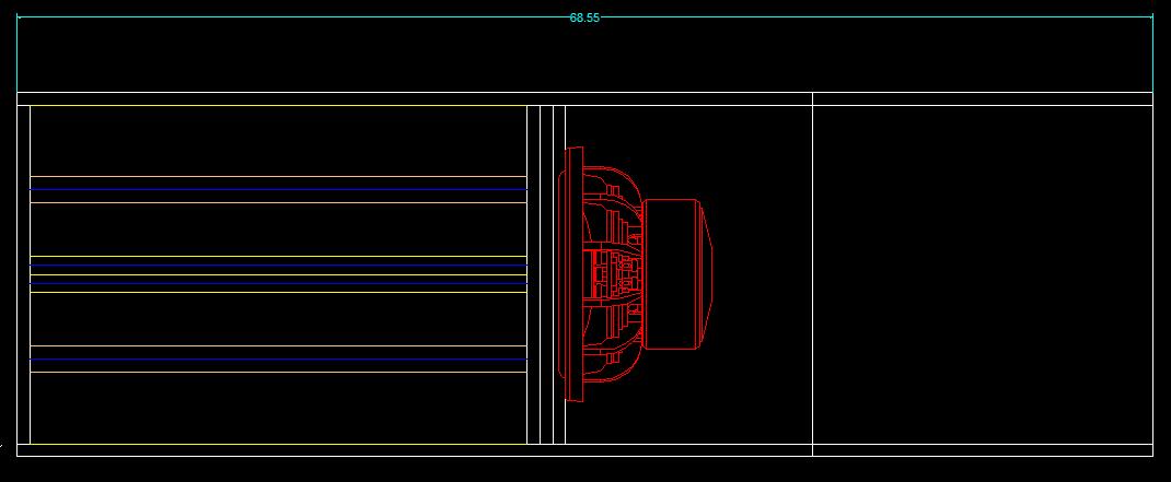

Oliver, thank you for taking the time to chart my data!
TITTH is a nice technical tag for these, I've been calling it 'onion fold' because I'm fond of silly intuitive names for projects 🙂
Ramsey
Ramsey

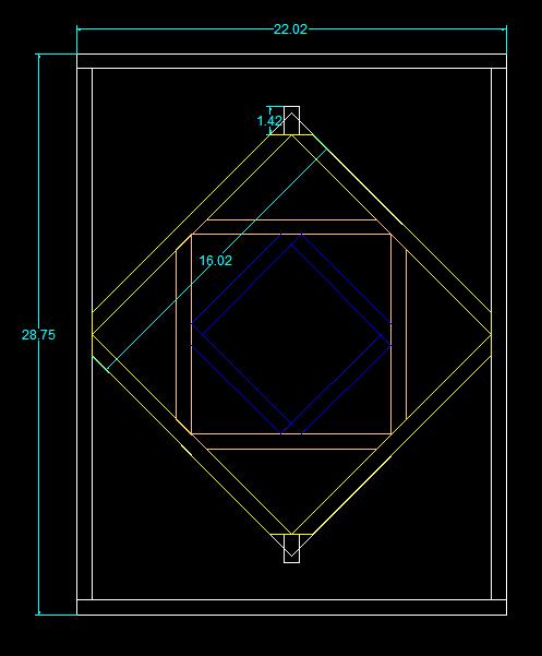

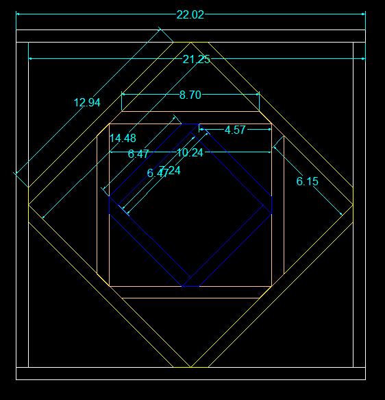

i'm a bit busy with a big gig for the weekend.(yes i wil take some pics)
as soon as i find the time il make a schematik of my fold.
btw i like titths 😛
btw i like titths 😛
here is the schematic of titth ,the akabak script above.
