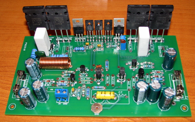

Not so good,fired up one channel with a light bulb tester stays bright light;Fired up without tester C15 gone in smoke blew up

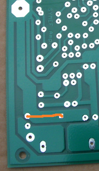

I have an un-stuffed set of the 'Drowranger' v1 boards, which are somewhat different than yours. I was initially sent the v2 boards so that is what I built.
C15 is just a little rail decoupling. From your pic I think the polarity was OK. The only things I can think of that would pop C15 would be applied voltage polarity was wrong, a really significant oscillation that heated the capacitor via its ESR / ripple current being exceeded or uncontrolled quiescent current, again resulting in heating if the capacitor.
Are you able to run it on a properly limited supply and check for oscillations and verify the bias circuit is functional?

With the bulb tester the current was limited but the bulb stayed lit so there was something wrong but what?I checked everything for right polairity like caps and diodes.What can cause the current draw?The pic isn't my board it is only to let you know what version I have

I use a 2x30Vac transformer and C15 is a 100V type

Found the mistake my own fault the drivers Q2 and Q16 weren't insolated from the heatsink forget to use the nylon bushing

I replaced the output trannie use the light bulb tester so far so good.Setting the bias slowly reach 23mV then C 3 begins to smoke

So, it behaves OK until you get up to the desired bias point by the sound of it. Still smacks of oscillation. I would try relocating the 39pF compensation caps that currently go from VAS collectors to ground to VAS collectors to their respective bases. In other words trade the shunt compensation for Miller compensation. Connect C5 across Q4's B-C junction and C12 across Q15's B-C junction.
