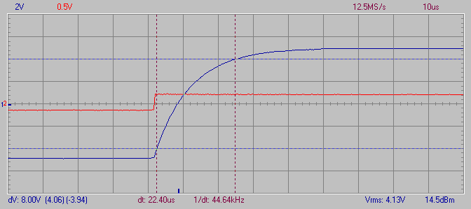

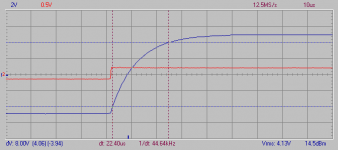

Slew Rate of SYMEF
OK, I know I initially brought this up in my initial evaluations but I recently cycled my SYMEF into to listening room. Some of my initial impressions rushed back, reinforced by additional comments of my company that day. The really soft, rounded treble is what I have always wondered about. I decided to take some accurate measurements. I don't mind some subjectivism, after all that is the experience, but some objectivism is good too.
Attached is the scope shot. The amplifier was powered by +/-31V and operating into an 8 ohm resistive load. It is an image showing 10Vp-p square wave out at 100Hz where I am focussed on the leading edge. The cursors are set to 10%/90% for a voltage rise of 8V, the time cursors show a 22.4us rise time. The math says we have a 0.36V/us slew rate. An LM741C can do better!
My question is, has anyone else taken direct objective measurements of this amp? I was quite surprised by this result and am quite frankly looking to see if my build is unique (that is did I make an error killing the performance - both modules mind you) or common experience in this regard.
I can say there was some oscillation in the initial build and had to go from shunt compensation as Harrison specified to Miller compensation. There seemed to be no difference in speed, just a low oscillation riding on top of the signal prior to altering the compensation. Comments?
