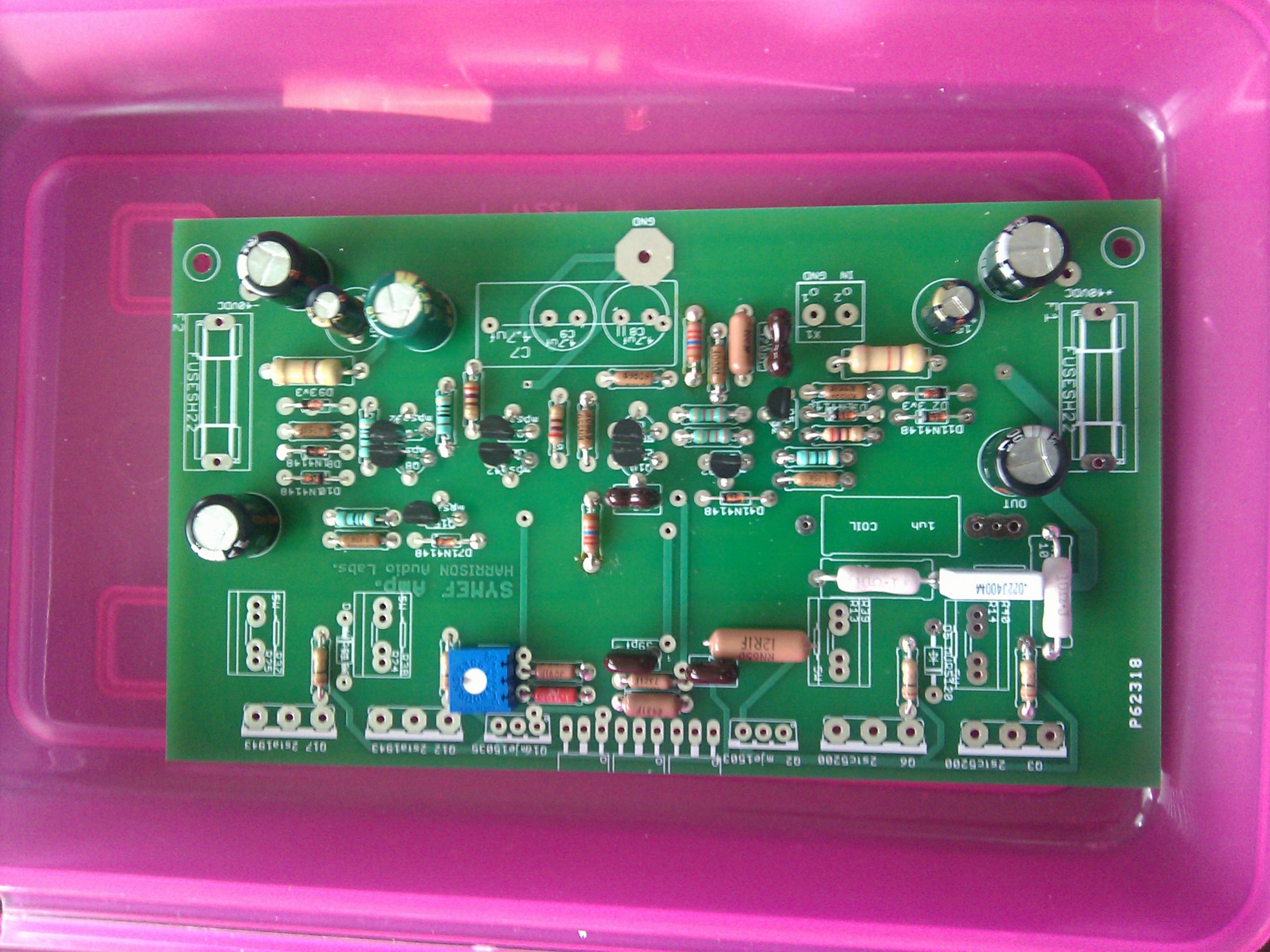

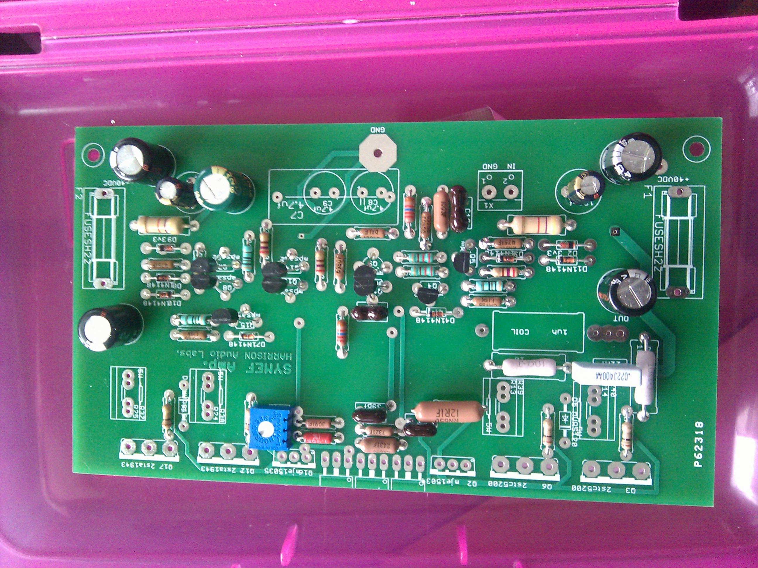

Little progress
Here is my progress so far, long way to go. Couple of comments, output device leads to be bent for properly attaching them to the heatsink. Also input capacitor holes are two small to fit 4.7uf film capacitor, need to widen them littlebit. Will continue rest of the build in the weekend.
Nice progress.
About the input film there are options:
1. Surface mount the film to prevent damage to pad 😉 . add extra support with some glue.
2. Sand or file the film lead tips to fit into pad hole
3. ....
kind regards,
Harrison.
