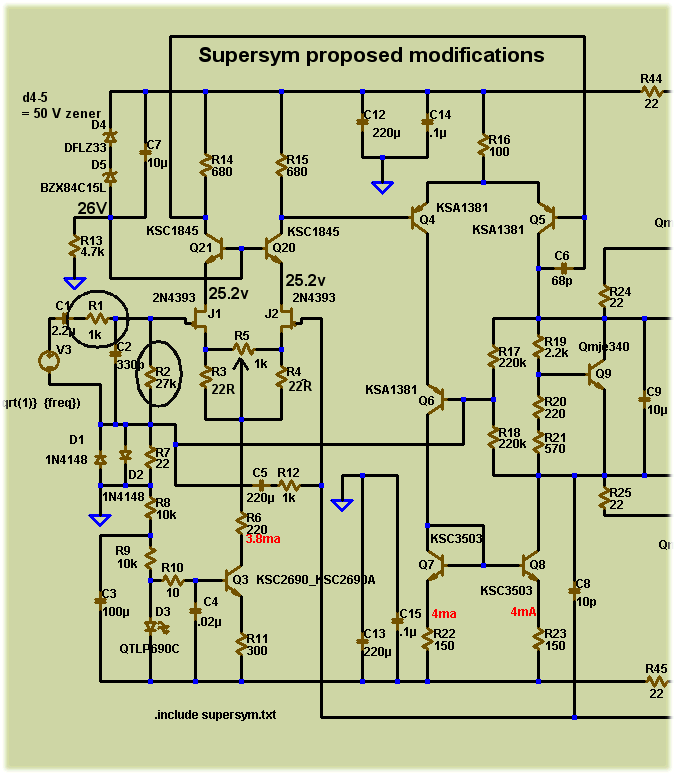

You lucked out , I just did the cascoded Jfet version , I will also include the original (the one I'm listening to now).
Anyone please comment , I did notice the jfet's doubled the THD20
to .014% max (up from .007%) I used 2N4393 , mouser still has them at $1.84 apiece !! these devices do not have the gain of the KSC's so less degeneration was in order. (22r instead of 100r).
In the .zip is the original and the new cascoded version , make sure
all 3 files are in the same folder.

Measure the open loop or Middlebrook, Negative feedback should be reduced in HF with cascoded Jfet.

4mA in Vas! needs to triple output or Mosfets as driver.
That is what I originally thought , simulation at a 2R load and real life use with 3R loads have shown almost no loading of the VAS.
But feel free to run this VAS at 7-10mA (47R - R16), it is not the symasym one. 😀

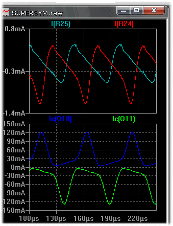

Just to show an unrealistic output and load, (2R and 120v p-p)and how this loads the VAS at 4ma, the (attached) file shows (top plot)
current through driver basestoppers and (bottom plot) total Ic of the Mje15032/33 , not even close to their SOA , even at 100 C.
I would not want to be the speaker or touch the wire at this level.. 😱

Hi OS,
I think I see a mistake in your latest schematic. In order to have cascodes for J1 and J2 the resistor R13 needs to switch places with diodes D4, D5 and capacitor C7. In this case, the cascode voltage must be referenced to GND not to power supply line.
Hi, bluesky . You mean use a 15V zener referenced and decoupled from ground ? That does seem to simplify and improve things. It also is confirmed by the Ampslab zener arrangement. Thanks

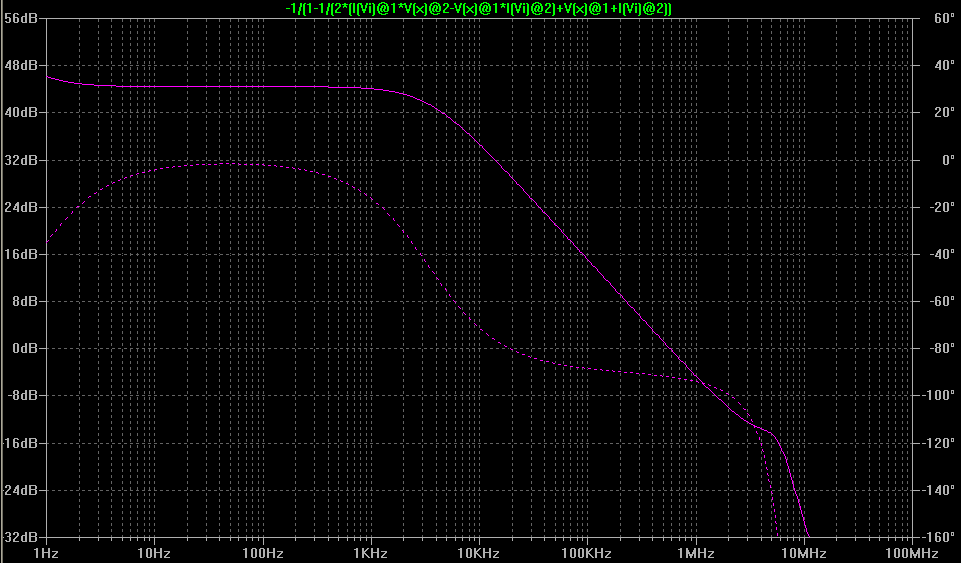

Cdom question
Was simulating the loop gain with middlebrook probe and found the amp stable without C7, C8. The gain plot didnt move up in freq. very much at all. Am I doing something wrong, is this amp that stable? And if it is why not use lower cdoms? Heres the plot.
the input cascode can be referenced to signal ground or to input pair emitter/source tails.blueskynis said:the cascode voltage must be referenced to GND not to power supply line.
I don't know which, if any, is better.
