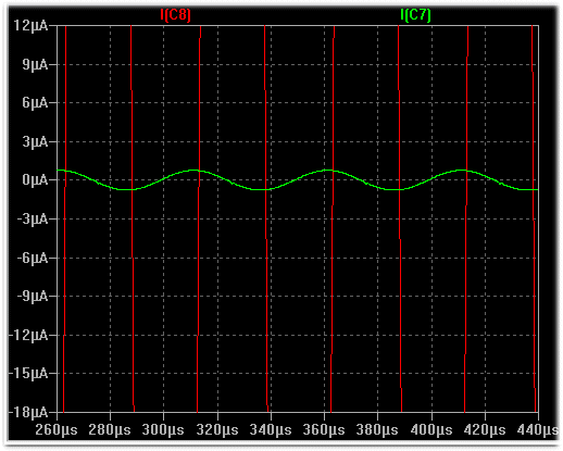

By Forr - My concern is that current flows through C8 because of the varying voltage at Q5 collector, but Q6 collector voltage being almost fixed at about +0.6 V above ground, current variations in C7 can only be very small. So I don't think we can consider that C7 and C8 load the LTP collectors equally.
You are correct , in the sim there is only a couple uA on C7 (green)
100's on C8 (red). I guess C7 can go , I'll try it. It does not seem to add another pole to the amp. If you replace the cascode with a resistor (22k) , it does.
I will have check whether removing C7 has any effect on THD, FFT , and loopgain response.

Hi Ostripper,
In fact, Q6 replaces a resistor in parallel with a capacitor of an initial design that was first published by Hitachi, I think. So at high frequencies, with this older scheme, C7 will continue to see almost no voltage variations, because alternatively coupled to the collector-base node of Q7.
The purpopse of common base Q6 or the old RC network is to maintain DC voltages at collectors of Q4 and Q5 roughly equal, getting the same thermal dissipation for them.

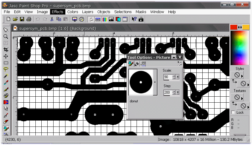

ostripper said:I have only gotten this far on the PCB , I whether a am wondering whether a 3 X 9" with opposed output pairs would be a better
design instead of "the long way" (Attached).
OS

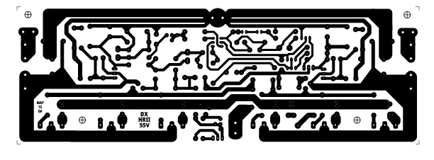

My 2-bits for the PCB layout: I much prefer a long layout with single row of output devices when the amp is this powerful. It better suits the most common long-sided heatsink/chassis configuration, and leaves ample room in the center of the chassis for the power supply.
..Todd
That is what I propose , with the single row OPS like I have on a 3.5" X 9", mounting flat on a 5" heatsink will look real cool , leaving that room for psycho power supplies
The only reason mine is 5.5" X 8" is I made it for the stealth amp.
OS
ostripper said:
That is what I propose , with the single row OPS like I have on a 3.5" X 9", mounting flat on a 5" heatsink will look real cool , leaving that room for psycho power suppliesThat is what I think we all want , the most universal layout.
OS
Yup. Perfect. In fact, it ain't too different from my DX HRII-55 layout. (Based loosely on Quasi's layouts.)
..Todd
