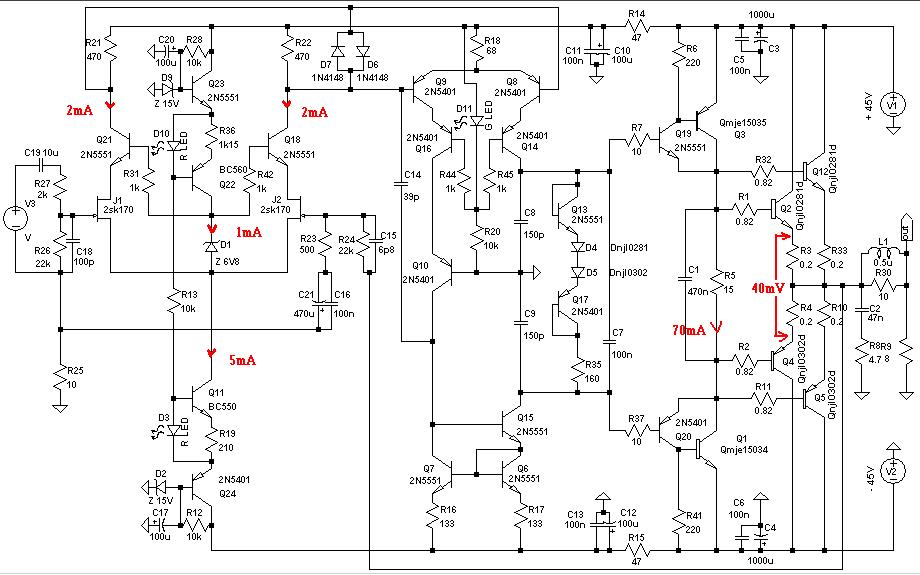

lumanauw said:Hi, Roender,
What is the effect if you split R18(68ohm) into 2 resistors, each 136ohm, one for emitor of Q8 and one for emitor of Q9 (splitting the differential VAS)?
I see this change in one amp, the earlier model uses differential VAS, but in the later model, they split the VAS (not forming differential VAS anymore). What is the effect?
With this change you heavily drop open loop gain. An early prototype of symasym was using this scheme. Changing to differential VAS gave a stunning impovement in sonics here.

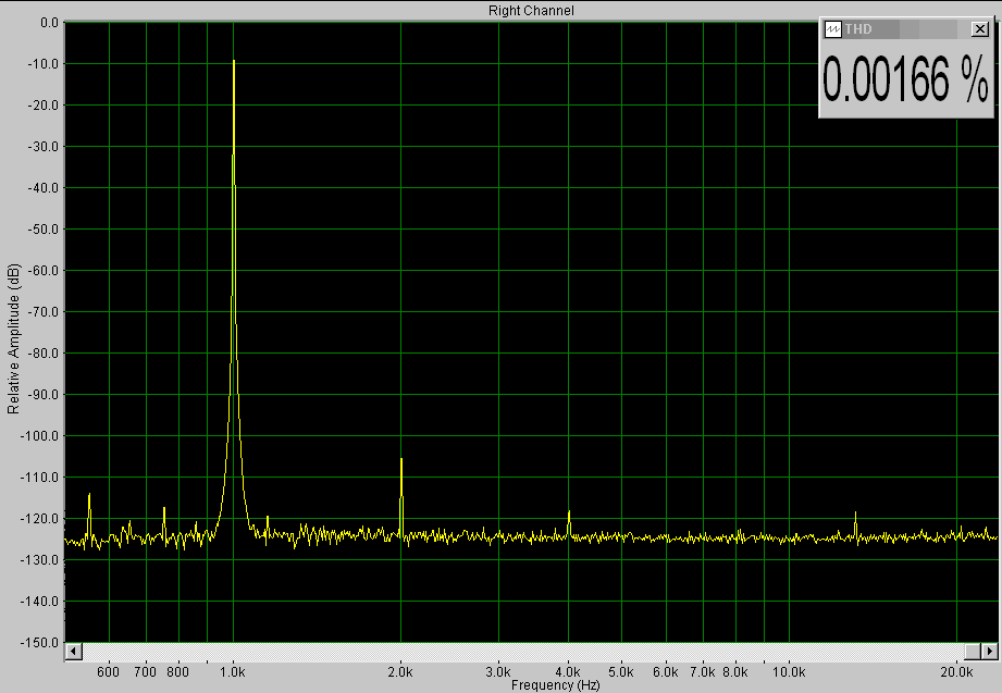

AAK said:Hi roender,
I cut both 47k on my symasym and alls well. I haven't put and ear to it, but everything including THD measures the same. Simulations don't show any difference either.
Al
I get slightly better measurings with the rloads, and in early prototype the sound was far more relaxed with the rloads.
Possible that i compensated something else...
Roender, can you do real world measurings?
Mike

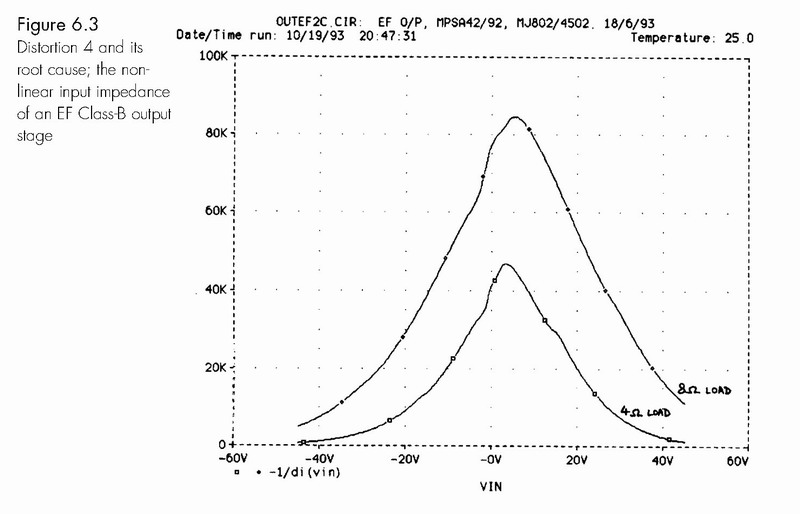

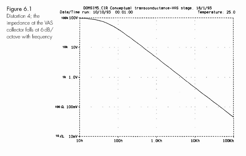

"... the compensation capacitor reduces the second stage output impedance, so that the non-linear loading on it due to the input impedance of the third stage generates less distortion than might be expected" (Audio Power Amplifier Design Handbook)
Maybe that's why the effect of output VAS Rlodas is not visible in original symasym, because original amp version has a low output stage input impedance and is more prone to backinject crossover (and not only) signals in VAS

Connection between VAS output (collector) with predriver or driver (base) is really a problem. Nature wants the signal flows from low impedance, and the receiving point is higher impedance, about 10-20X of the transmitting impedance. (unless you want max power transfer, then the output impedance=receiving input impedance)
VAS collector has higher impedance than predriver's base impedance.
Putting miller cap lowers the output impedance of VAS, but not linear (towards frequency). The input impedance of predriver's base also non linear.
Putting R at collector of VAS helps to lower impedance that is not dependant on frequency.
VAS output impedance is decending like a hill. At 3khz about 1kohm
Correction: "DRIVER" input impedance !lumanauw said:Predriver input impedance is like this :
In power symasym final stage, I used CFP "transistor" as a driver. The input impedance is over 1Mohm at any audio freq.
There is no need for making VAS output more impedance linear (as a fuction of freq).

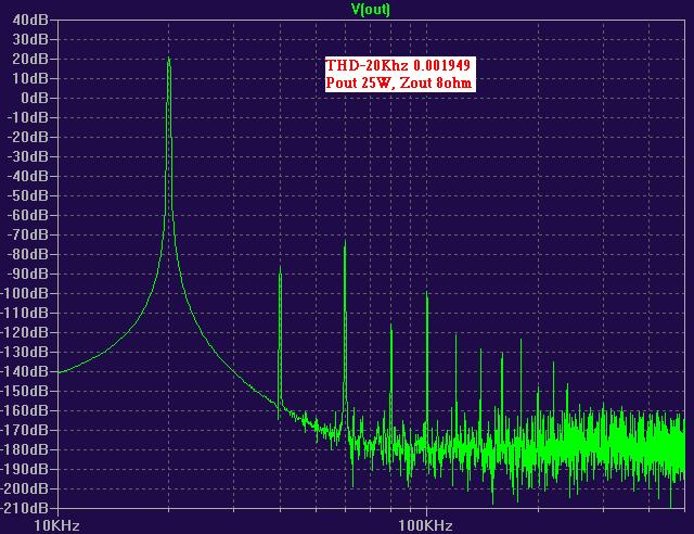

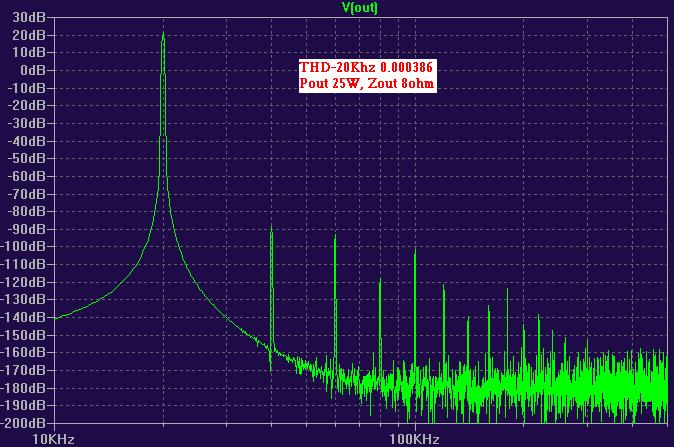

Hi Mike,
The difference with or without the 47Ks is very small. A slight increase in 2HD. I thought I would never say it, but I think symasym could actually benefit from adding some low order distortion. Don't get me wrong I think symasym sounds great. But when I compare it with an amplifier with higher low order distortion, mainly 2HD, I seem to perfer that sound. Of course, It may not all be in THD, there may be some other factors like the differences in components, etc. Maybe different input capacitors. A auricap vs. wima. Could be the difference.
So, without changing symasym in any way, I started working on a tube front end to drive symasym. I figured symasym's very low THD driven by a tube may just add the write amount of THD to create a magical combination.
Any thoughts?
Al

Hi Dado,
Q13 is bounded with Q19 and Q17 with Q20. You can see that on pictures above, in the beginning of the thread
Hi Mihai, I did not notice it, sorry.
So you have two kind of the temperature follower, with transistors folowing drivers temperature and with thermal diodes following output transistors temperature? You say that bias current is quite stabile?
