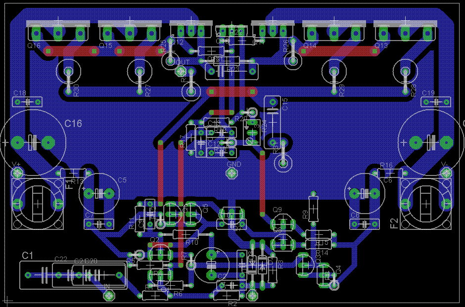

I put together an "alternative" PCB for Mike Bittner's Symasym 5.3, with 2 pairs of output trannies. I do hope he won't mind me "messing" with his amp :smash:
That's about as close as i could get to having a star ground on-board. I implemented John's (MJL21193) idea of 22r//diodes for the small-signal ground "decoupler.
If anyone has ideas for improving this, don't be afraid to step forward and speak your mind 🙂

Hi Khron,
I have not examined the PCB closely, but there are a couple things that come to mind.
Move the capacitors near your fuse holders towards the front of the PCB. This makes more room for emitter resistors and may allow the use of the "plate" types.
Use normal fuse clips for the "GMA" size fuses. The ones you have there don't look that common and may be very difficult for anyone else to source.
Allow for a single turn 300° type trimmer control. 10 turn types have small wipers and are limited in current, never mind that the single turn types are easy enough to use. I would find a 10 turn annoying as heck! I think there is a resistor in series with the control, can't remember that clearly enough to be sure.
Lastly, possibly allow for smaller input coupling capacitors. Just lay a trace in line and provide extra holes.

Thanks for all the quick replies / comments 🙂
Anatech,
I used that type of fuse holders because i've got a bunch of them scavenged from some unused medical PSU's, just for a few of these boards. Same goes for the trimmers: i've got a few 1K or 2K's somewhere at home. Yes, there is a resistor in series with the pot. And besides, is the current going through the trimmer really "too big" for a 10-turn? And i guess a few extra pads for the input cap won't hurt 🙂 (I've gathered a bunch of Roederstein MKT1822 caps, 1,5u-6,8u with that footprint)

Hi Khron,
It was found that 500 ohm trimmers worked better. I can verify that as I have some built.
That's what I figured when I saw your PCB. Can you simply add trace to allow the clips to be used? I'm just thinking that the boards are more universal then.

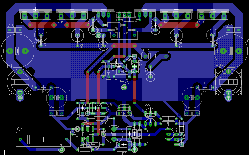

Rev 1, i guess 🙂
Anatech (i'm Chris too 😀 )
I tried to follow (a few of) your tips. Here's the result this far:

Hi Chris,
Much better, thank you.
I guess the board needs to be checked in detail now.

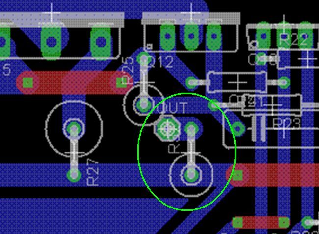

I'm not sure what I'm seeing here. Is this a resistor in series with the output? Perhaps you left the load resistor in when making the board layout?

MJL21193
That's the 10 ohm // output inductor.
ReiMomo
I think it needs a resistor for each base of the outputs.
oh wait thats the foil side!!! but you still need to fix the emmiter resistors then.
I'm gonna have to ask you to be a bit clearer, please :xeye:
