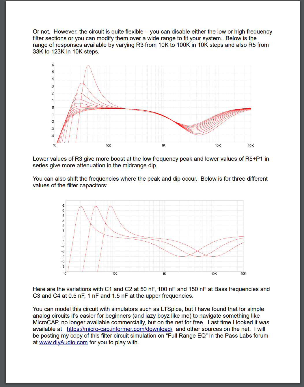

I have active bass EQ boards - electrical slopes shown in attachment.

My general approach to things like this is to use an active analog EQ for initial testing. Massage that to produce the most pleasing sound and decide if it's good enough and reasonably reproducible by another means. Once through that hoop, start working on actual circuits to try to reproduce the frequency response. Being able to adjust knobs/sliders in real time speeds things up dramatically vs. messing with circuitry or even having to save presets, etc. to a DSP.

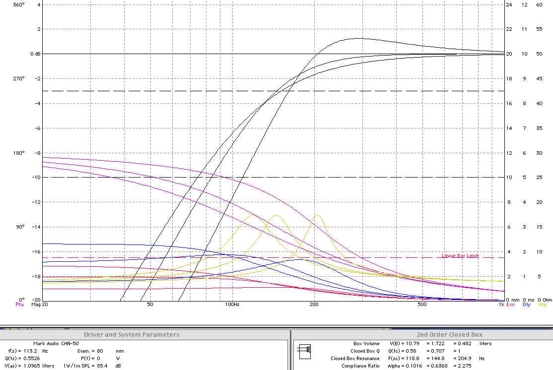

Post #27, I intended to attach mark audio driver specs not the full range eq curves as I already posted them!
Looks like I'll be ordering several drivers form Madisound. CHN-50 looks great for my 2 way budget passive speakers! Really like the champagne driver to be used in the console.. Thanks!

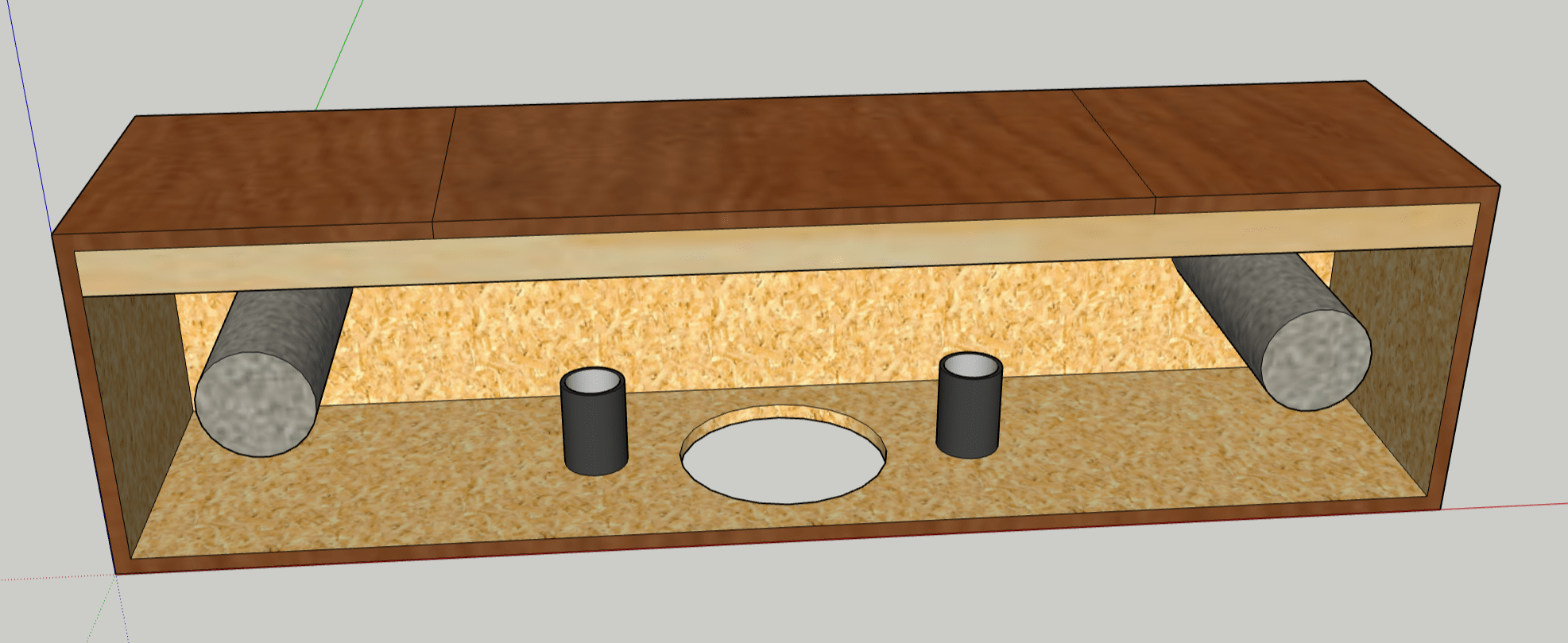

My plan is for full range units in tubes leaving as much of the box volume for the sub, extensive bracing to be determined..

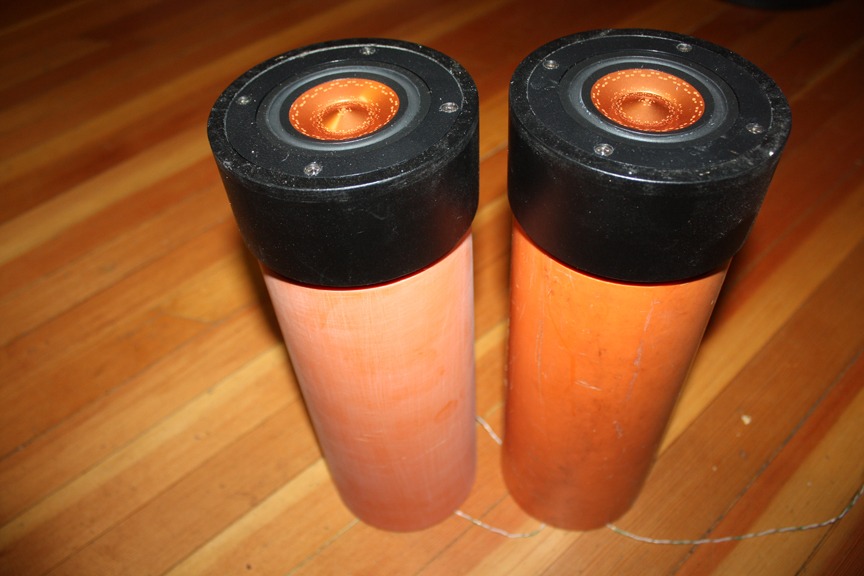

champagne driver
Mine are copper. Champange is a left over colour name from some ancient CHRs (as is Gold, last seen in the Alpair 6.1/10.1 . I went looking at Madisound and at KJF and could one find silver (called Grey?)
A5.1 in 4” pipes. If you go sealed see plot, these are midTLs (yo’d run them out the back..
