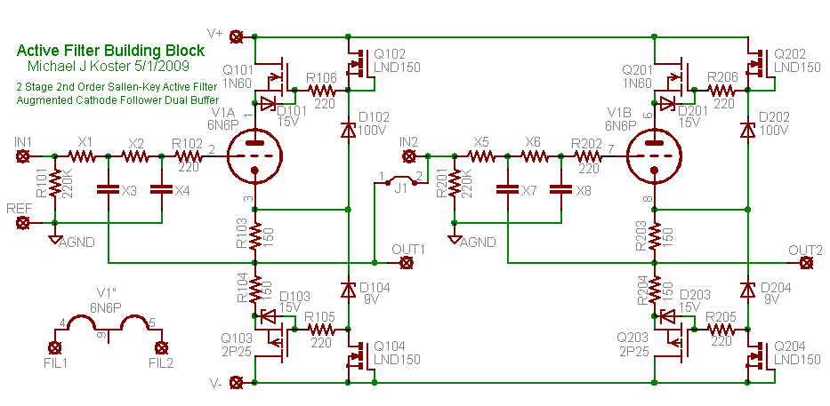

High open loop gain is not needed for Sallen-Key. I prefer a nice unity gain buffer block like an augmented cathode follower having high symmetric current drive capability.
I think something like this would be a good implementation of a Sallen-Key topology that would have very low distortion to give excellent performance for LR4 and other low-Q filters.
I like it. Modern semiconductors are very nice additions to vacuum veterans.
