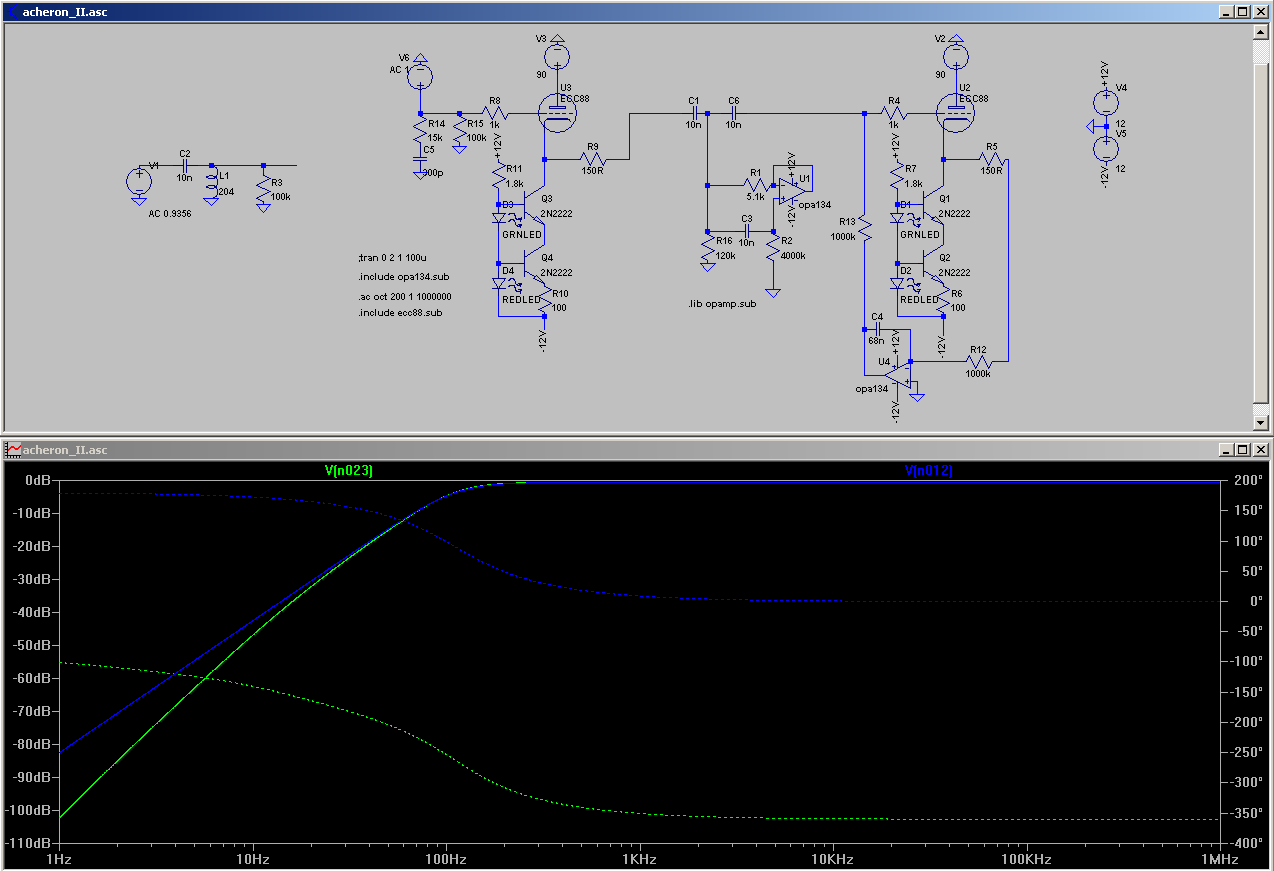

Per channel, per division (i.e., bass, treble), two or three cathode followers, two gyrators. 2nd or 4th order, designable for any reasonable Q (<2). Low distortion, low noise, high stability. Take a look at the Acheron design on my website (tip of the hat to Wintermute who found a few calculation mistakes in my writeup, which I'll fix one of these days) for a general outline- I'm substituting pentode CFs for the gyrators, triode CFs will be about the same.
Thanks Sy, I have a complete spice model (including the triodes) if you would like me to upload it here (I think it is on my home computer). It isn't exactly the same as your published schematic, but I think there is only one component value different, which I changed to get the curve to look right (to me).

Ok here it is for anyone who is interested. This is an LTSpice model of SY's acheron. I don't know how good the model of the triode is but the simulation seems to work 😉
The component change is the 200K resistor which has been changed to a 4Meg resistor, without this change the simulation does not produce anything remotely like a butterworth roll off. The passive network is there to do comparisons to an ideal passive CL circuit.
In the attached pic the blue trace is the passive circuit and the green trace is the output from the acheron.
Increasing the the value of the blocking cap (after the active inductor) to 15n or 22n makes the curve match better down lower but it is not as good a match at the corner freq. The value SY chose of 10n seems to be the best compromise.
I also used opa134's instead of tl072's mainly because I already had the model for them for LT spice. The attached zip file has (I think) everything in it that you will need to get the model running, make sure you read the readme file as it has some definitions in it that need to be added to the standard.dio file.
Note I'm not a tube guy 🙂 I was interested in the gyrator part of SY's circuit, which I came across in the B1 active crossover thread, and decided to model it to get a better understanding of how it worked 🙂 That eventually lead me to my own design which unfortunately has still only been simmed at this stage.
