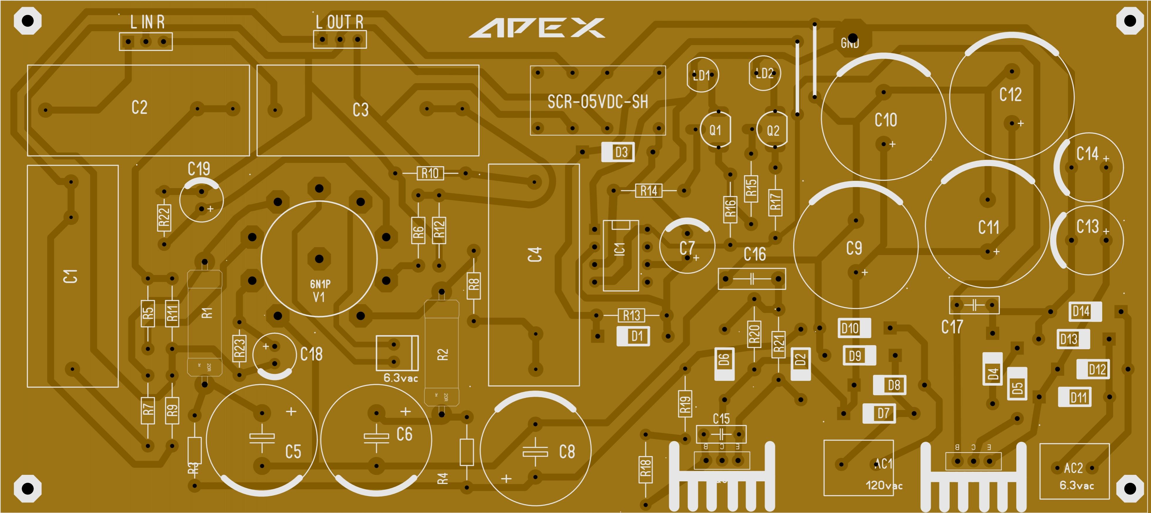

Is BAS21 necessary for D4 & D5?
Could 1n4148 be used? Peak current with 35Vac is ~16mApk, the BAS21 is rated for 200mA and 1n4148 is rated for 75mA
Q.
D2, D6, D13 & D14 are BAS21
Is there an alternative diode that satisfies duty?
U1 is shown as both pdta144et and pdta114et?
Which is correct, the 47k, or the 10k?
Does R2 22k exist?
R21 & R22 listed as 3 off 2.7K but is on the PCB as 2off 5.6K
R28 & R29 as 120 Ohm. The PCB has them as 150.
Line 28 shows 2 off and should be 4off
BOM list in the pdf file is correct dont look on the PCB parts marking as it have some small variations when compaired with first version.Yes SC is smd LED light
The BoM cannot be correct.
