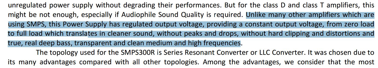

Further fodder for our consumption:
http://www.audiophonics.fr/images2/6189/SMPS300R.pdf
I don't know that much about switch mode design so I'll get some expert advice on this but I don't like the look of the 100nF cap across 10R connecting system ground to mains ground. In my conventional supplies I just have 100R in this position . . . . ahh further down the datasheet it says that there is a link the bottom of the board that makes this optional - this is encouraging

Just to mention...not all SMPS are regulated. If we have unregulated SMPS this is simple DC-DC converter, without feedback. So it is similar than classical PSU. For audio, I would rather recommend non regulated one. Also it should be made exactly for audio, that means that filtering is much more improved, also against noise injected back into mains. Actually a good audio grade SMPS should not look much different on osciloscope than classic PSU, but the advantage of using first one is huge. Dynamic, headroom, bass definition are simply superb to classic PSU.
But it is important, not to use any aditional capacitors between amplifier boards and SMPS!
Every PSU has some degree of regulation and this one seems to have quite a high degree of regulation.
The issue often discussed is wether there is regulation involving loop feedback but this issue has different parameters and significance in a SMPS.
If less regulation is desired some series resistance can be added.
