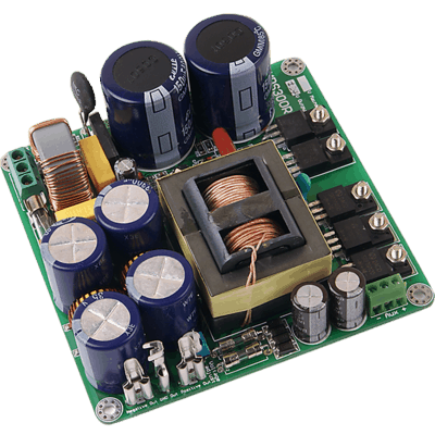

Today,I've tested my second FetZilla with a 300 Watt SMPS with 2x35Vdc.I can't say to hear any different sound.At high volume the SMPS stays rock steady at 35Vdc
Yes I did,at first I didn't knew if it's going to work without smooting caps but it turned out very well.Next thing is adding some smooting caps at the SMPS output to see if this is altering something.
For best results, you should use SMPS directly connected to amplifier, all big smoothing capacitors should be removed or disconnected. But it is very important that SMPS capacitors are quality ones, especially those on the secondary side of SMPS transformer. These should be low ESR 105C, like FC, FM or FR all from Panasonic.
I have tested few Hypex SMPS and I can tell, that for me, there is no way back. No fuses, no DC relay in signal path, no annoying DC buzzing anymore :D
Yes ,you're right even the manufacture didn't recommend it to use extra smooting caps .
